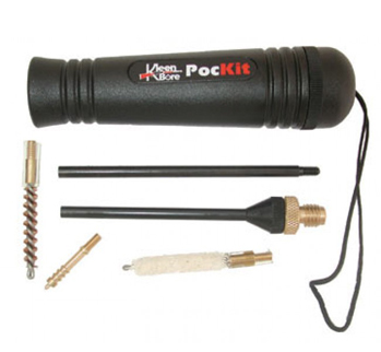

I generally keep a 22 brush, and a palm rod in my kit when shooting 22's.
One like this Kleen Bore Poc-Kit is quite small, and everything stows inside the handle.
After a box or so, I'll have to brush out the cylinder to remove the built up gunk in order to be able to seat cartridges in the cylinder again.
It also helps to get the cylinder really clean after a long shooting session. I go so far as to chuck a 22 caliber brush and rod into a drill, and spin it with Hoppes to get all of the carbon rings out of the cylinder. I do shoot shorts and CB's sometimes, and they can really gunk up a cylinder.
With some guns, a 22 caliber bore mop with a dab of Flitz metal polish will really clean and polish up the cylinder. Polishing the cylinder like this lets me fire more rounds between brush out sessions.
