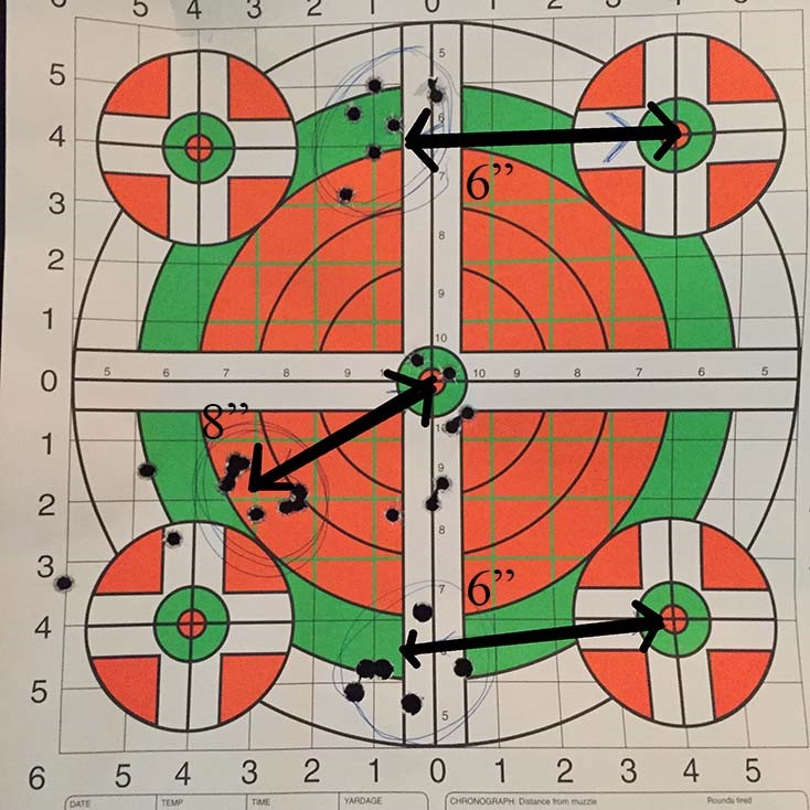

I must admit I've been hearing great things about the Dan Wesson for a number of years, so I was really looking forward to the first outing.
I was shooting mild 357 reloads, I don't like shooting maximum loads on my guns.  Barrel gap set to .006".  Barrel nut snug.  Shooting from a bench barrel rest.
With the first couple of shots and the 8" barrel I was not pleasantly surprised.  The bullets impacted 3" Left, 2" low at 20 yards.  I cranked the rear sight over to the left, to the stop.  No relative change in impact point.
The 6" barrel was not much better.  5" left, but on elevation. 1st_20YrdTarget.jpgImage Enlarger
Any thoughts?

Well the groups don't look so bad. Maybe I misunderstood what you did but when adjusting a rear sight you should move the rear sight in the direction you want the bullet to move. So If I understood what you did you moved the sight in the wrong direction. Keep at it and I am sure you will find the sweet spot.
January 20, 2017 - 4:28 pm
+1 on what LB said. If it was hitting left and you moved the rear sight LEFT, then it would hit even farther to the left. Your groups do look pretty consistent. Keep trying. cool
January 22, 2017 - 3:34 pm
My 2 cents -
1 check your grip
2 Don't chop it to death
3 Follow through
4 Have someone else through a few round downrange.
5 Try different ammo - who's reloads were you shooting?
