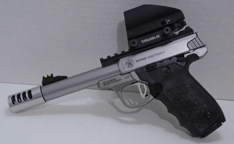

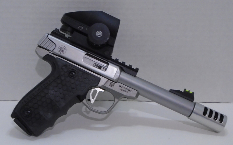

Not being one to leave well enough alone, I started making “improvements” to the gun. First, I replaced the grips with Tandemkross Hive grips, and then their Game Changer muzzle brake. I then added the Truglo reflex sight and finally the Tandemkross Victory trigger. The Tandemkross Victory trigger was far from the easy install touted on their websight (at least for me with my bigfoot sized hands). I wound up losing the spring and detent and had to order another set from Tandemkross (I actually ordered two to be safe). I eventually got the trigger in, but not before losing another spring and detent. I did eventually find one spring and both detents I had lost. It was well worth the trouble because this trigger is phenomenal. The standard trigger is good, but the trigger pull went from an average of 2lbs 11 oz to 1lb 3oz. The best part is the ability to adjust pre and over travel to whatever is comfortable for you.
