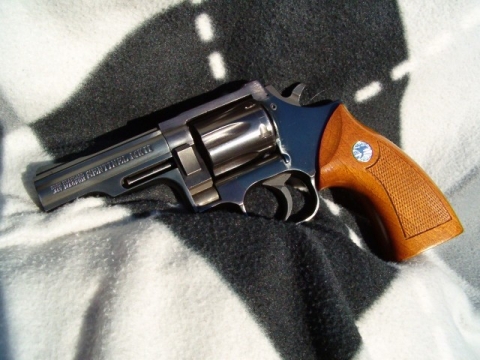

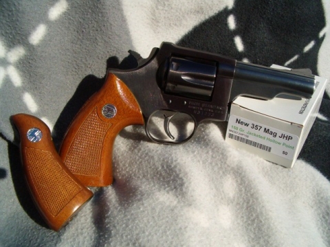

I'm now the proud owner of a High Standard revolver, a Sentinel MK II.Cool
HPIM2310.JPGImage Enlarger
HPIM2311.JPGImage Enlarger
I'm planning on making a DW inspired Pac case to store him in & will leave room in there for the addition of a sibling...I hope to be able to find a clean example of a MK III one day, to keep him company.Smile

Great addition Charger!
Did the smaller grip come with it?  A Pac of  Sentinels is a cool idea and would be kind of neat having the only one like it too!
Forum Posts: 11269
July 8, 2009 - 9:12 pm
Thanks!Smile
I found the grip on Ebay. The same seller has another one back up on auction, so they must have a few of them.
