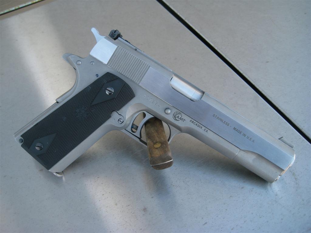

Well, it is cold this morning, so I tihnk I'll wait a few hours to hit the range... but here's a quick pic.  Cleaned up really nice.
November 6, 2011 - 3:05 pm

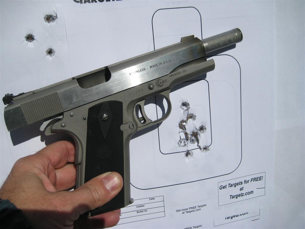

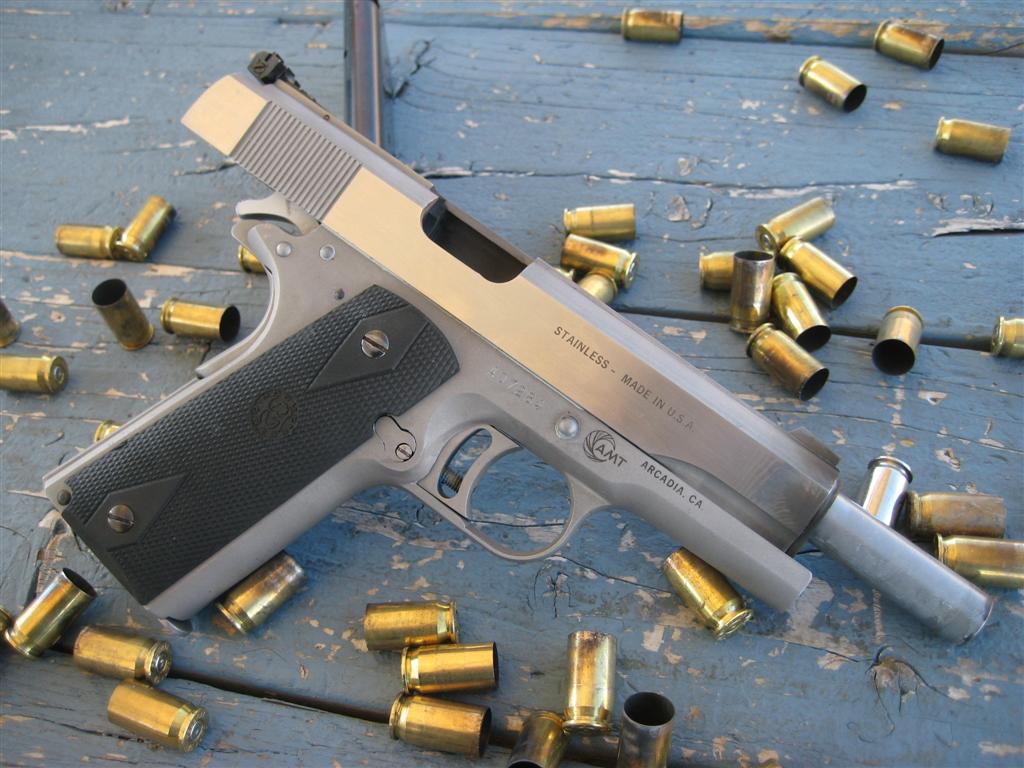

Well, She's a keeper laugh...  Still has the half cock issue, but runs just fine.  I guess I just won't use the half cock until I figure it out.
She's a little dirty now....
