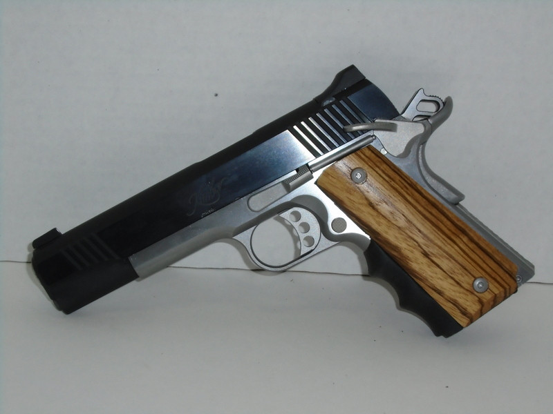

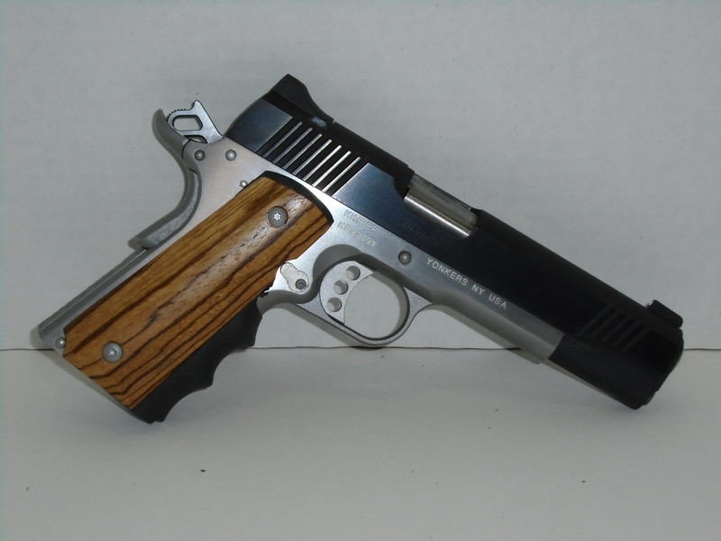

The new gun is a Kimber Custom II full size 9mm with a stainless steel frame and a carbon steel slide. I felt the all steel configuration would stand up better to full power .38 Super+P loads. As with the Kimber LW, the Sig .38 Super barrel fit the gun as if it were made for it. This gun will be a dedicated .38 Super since I still have the LW in 9mm. I do have two issues with the Custom II. First, the rear sight set screw is rounded out (not by me this time) and second, the trigger bow is slightly bent causing the magazine to stick when being released. Both issues are easily lived with for now as this is a range gun and the sights are dead on at 10 yards. I may eventually send it back to Kimber to address these two issues.
