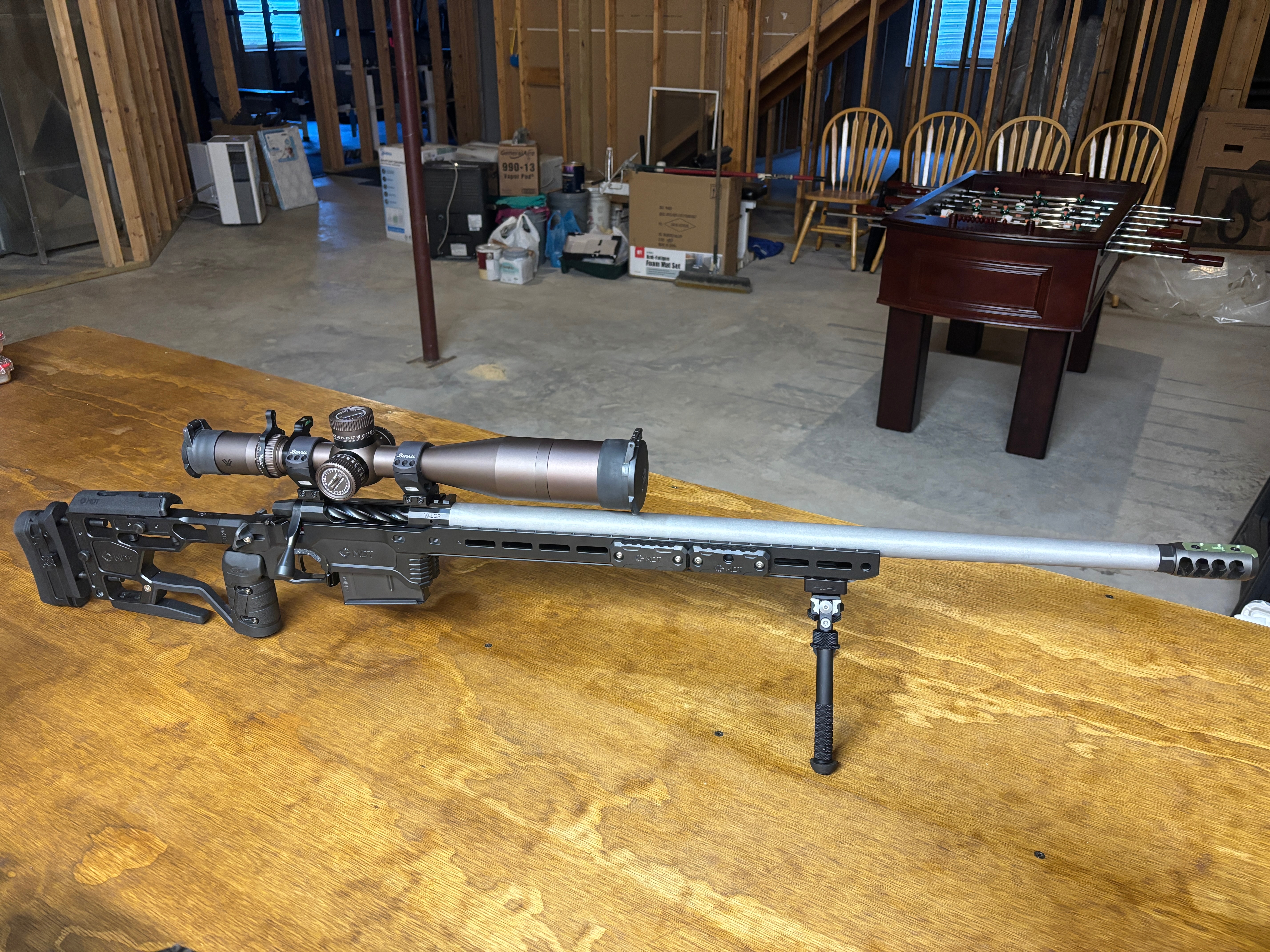

Just picked up my action and barrel from the gunsmith.  He did the chamber reaming for 300 PRC caliber.  When I got home I assembled the Curtis Custom action, TriggerTech Diamond single stage, Bartlein barrel, MDT brake, MDT Elite ACC chassis, Vortex Razor HD Gen III 6-36x56mm EBR-7D MOA FFP scope mounted with Burris XTR Signature 34mm 1.50” rings & Area419/B&T V8 Atlas bipod.
Looking forward to finding the load recipe it likes best.  Hopefully I can get .250” groups at 100 yds.

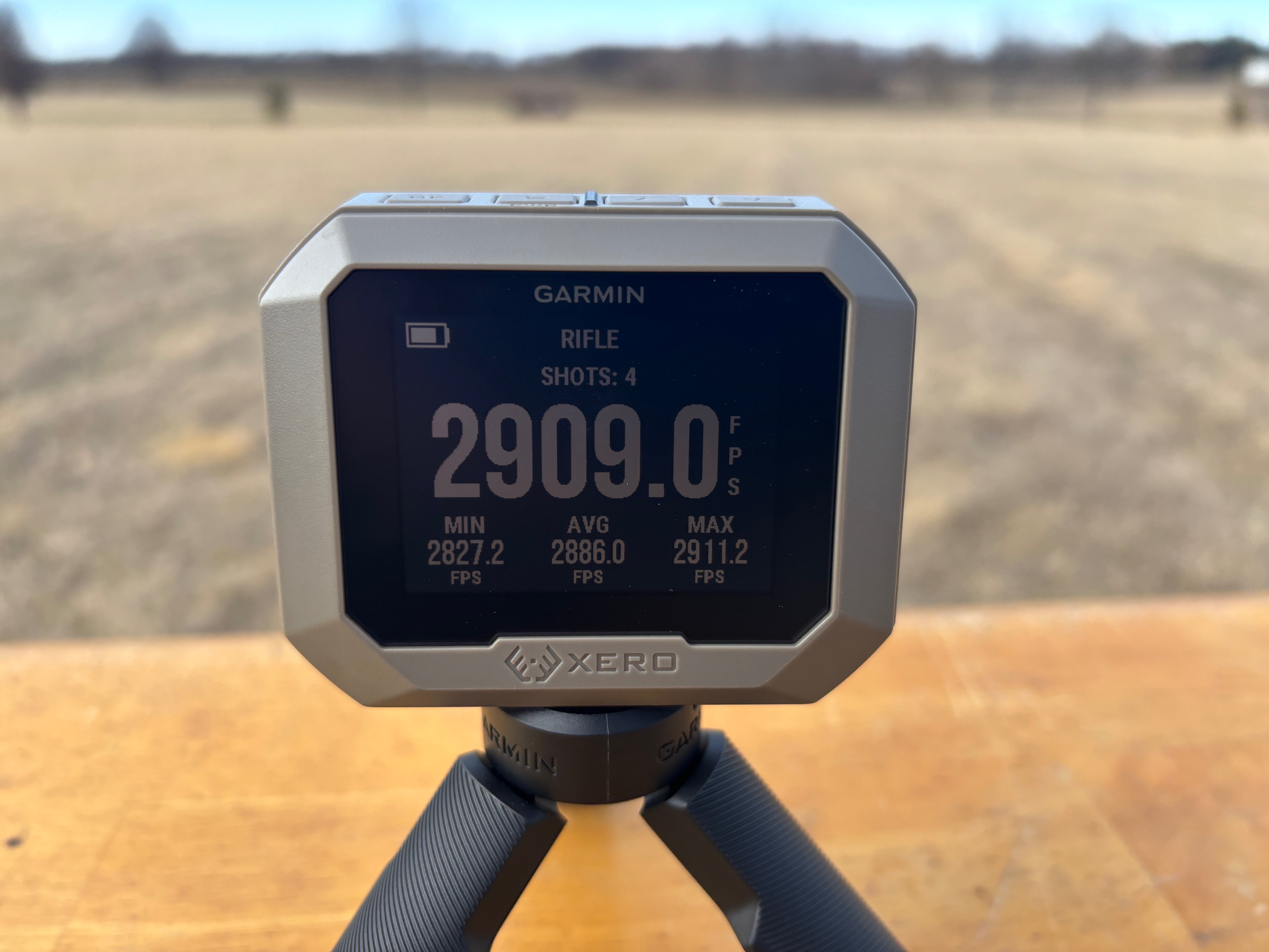

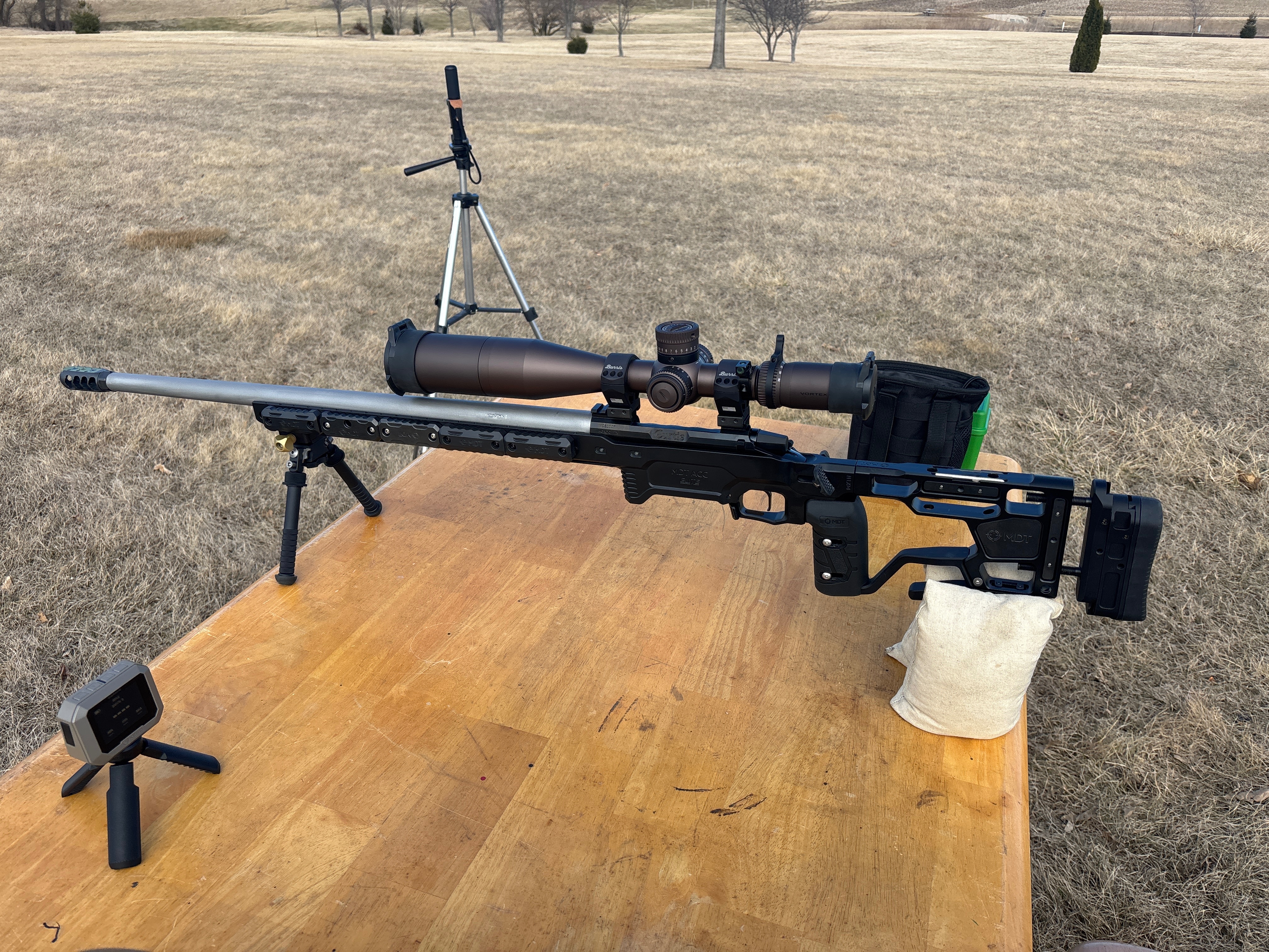

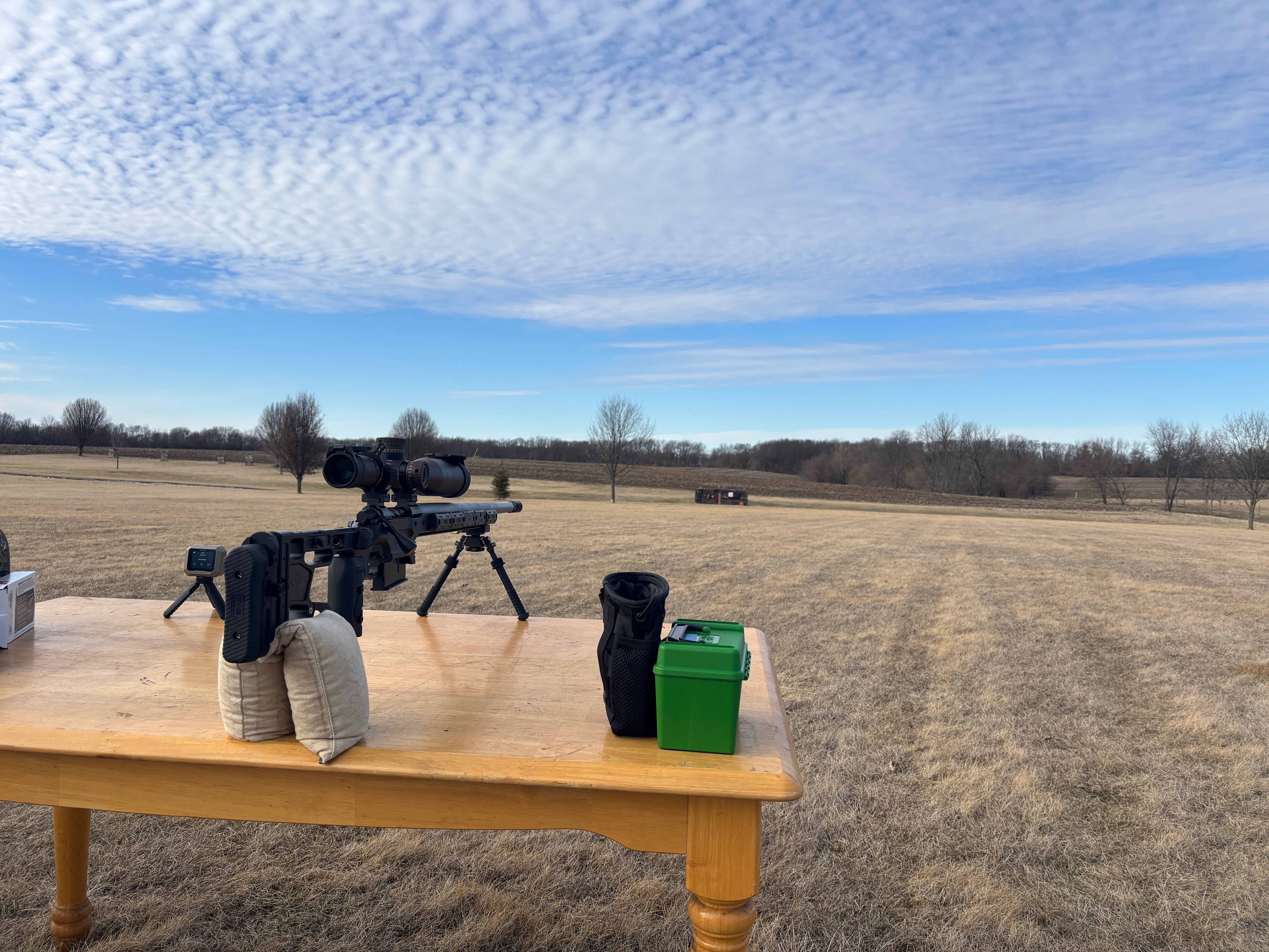

First bunch of shots thru my new custom 300 PRC rifle build.  Shooting Hornady 225gr ELD-M ammo.  Sighting the scope in and breaking in the barrel at same time.  Got lots more shots til the barrel is seasoned.  So far I’m really happy with the muzzle velocity I’m seeing!  Once seasoning is done I’ll begin shooting my custom reloads to find its preference.IMG_6547.jpegImage Enlarger

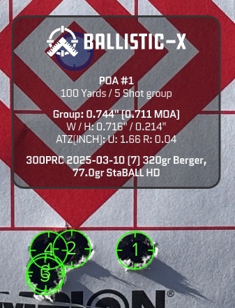

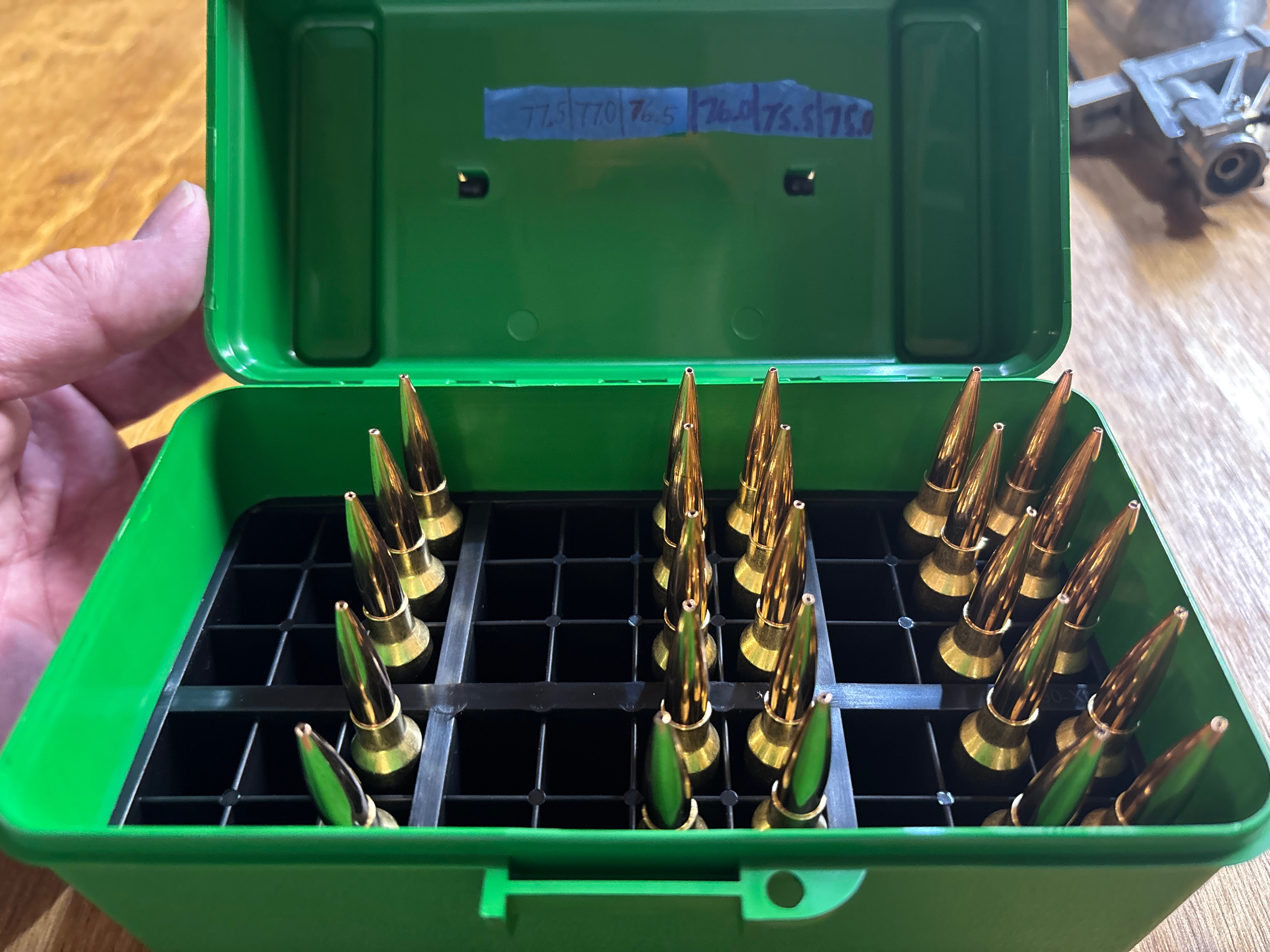

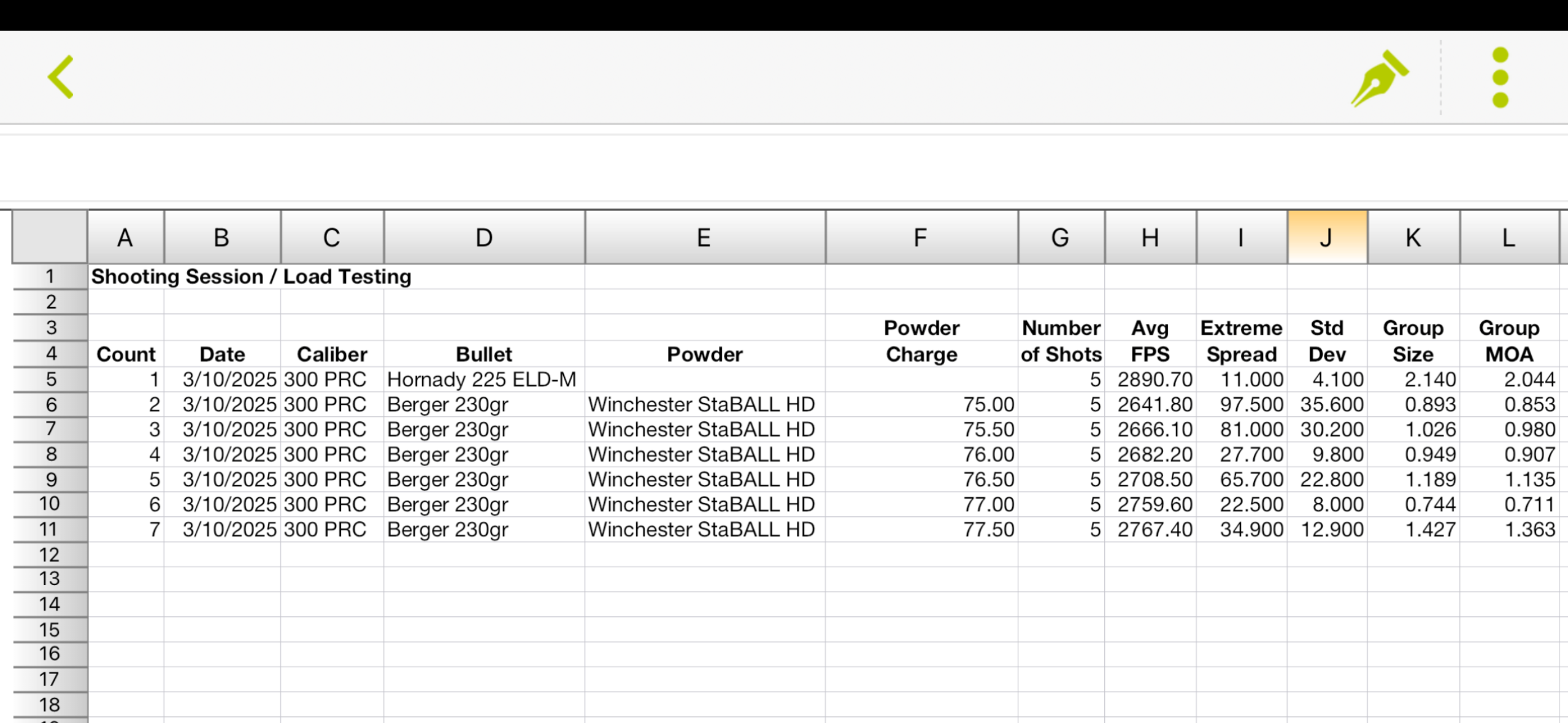

March 11, 2025 - 8:08 am
IMG_6638.pngImage Enlarger
Beautiful weather yesterday.  71-deg and sunny.  A little windy, but nice.  Did some reload testing.  The spreadsheet has the details of each load.  Looks like a node at 77.0 grains I’ll need to explore further (grouping pic above).
In hopes of finding the sweet spot, I’ve also loaded up 5 rounds of 76.8gr and also 5 of 77.2gr to see if the numbers get even better just a tad below or just a tad above 77.0.  Also going to go up to 78.0gr to see if another node emerges.  Max load per Hogdgon is 78.8gr.  My plan is to not go much above 2800 FPS.  Hopefully I find a sweet spot later today, I’m getting closer.
