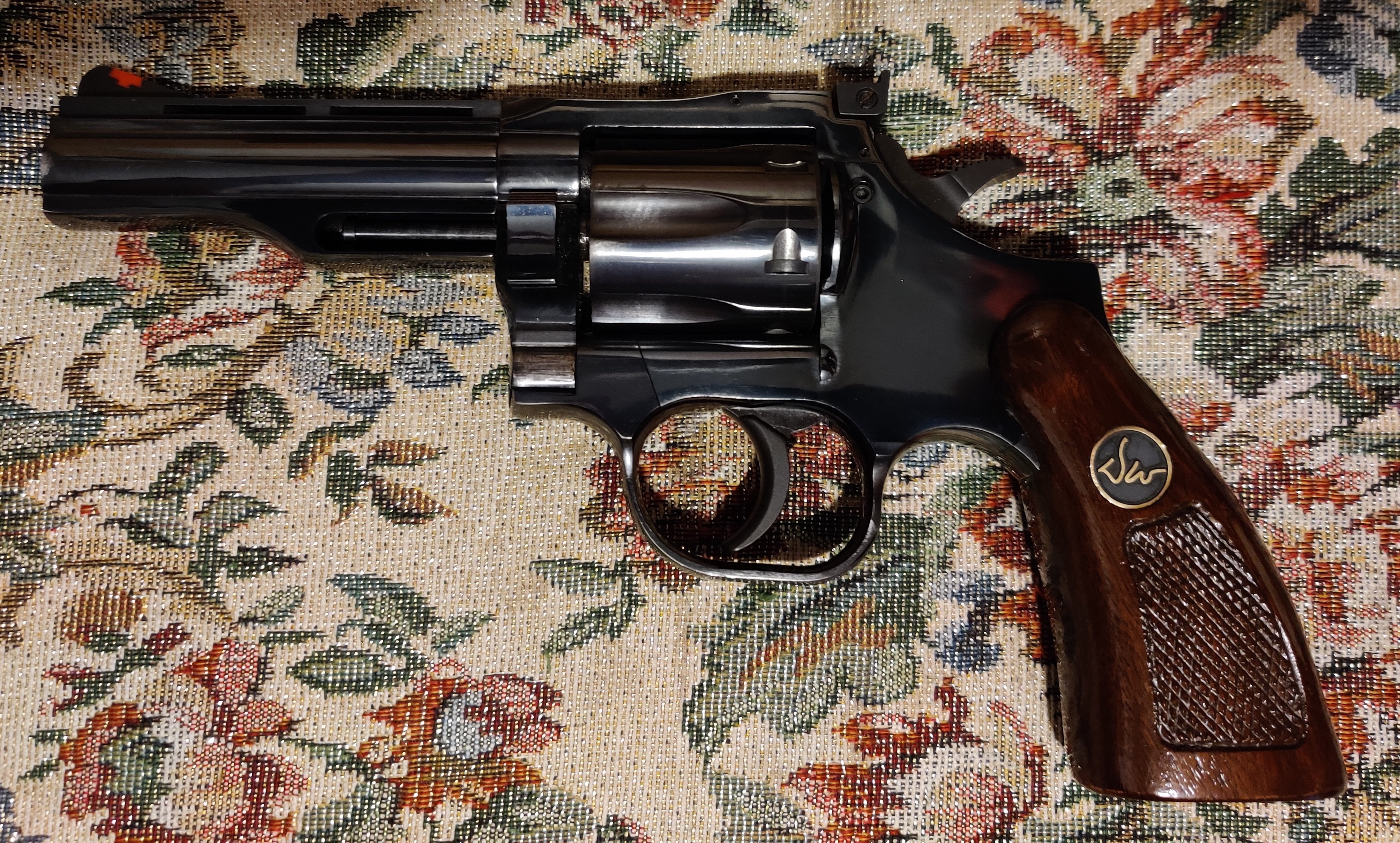

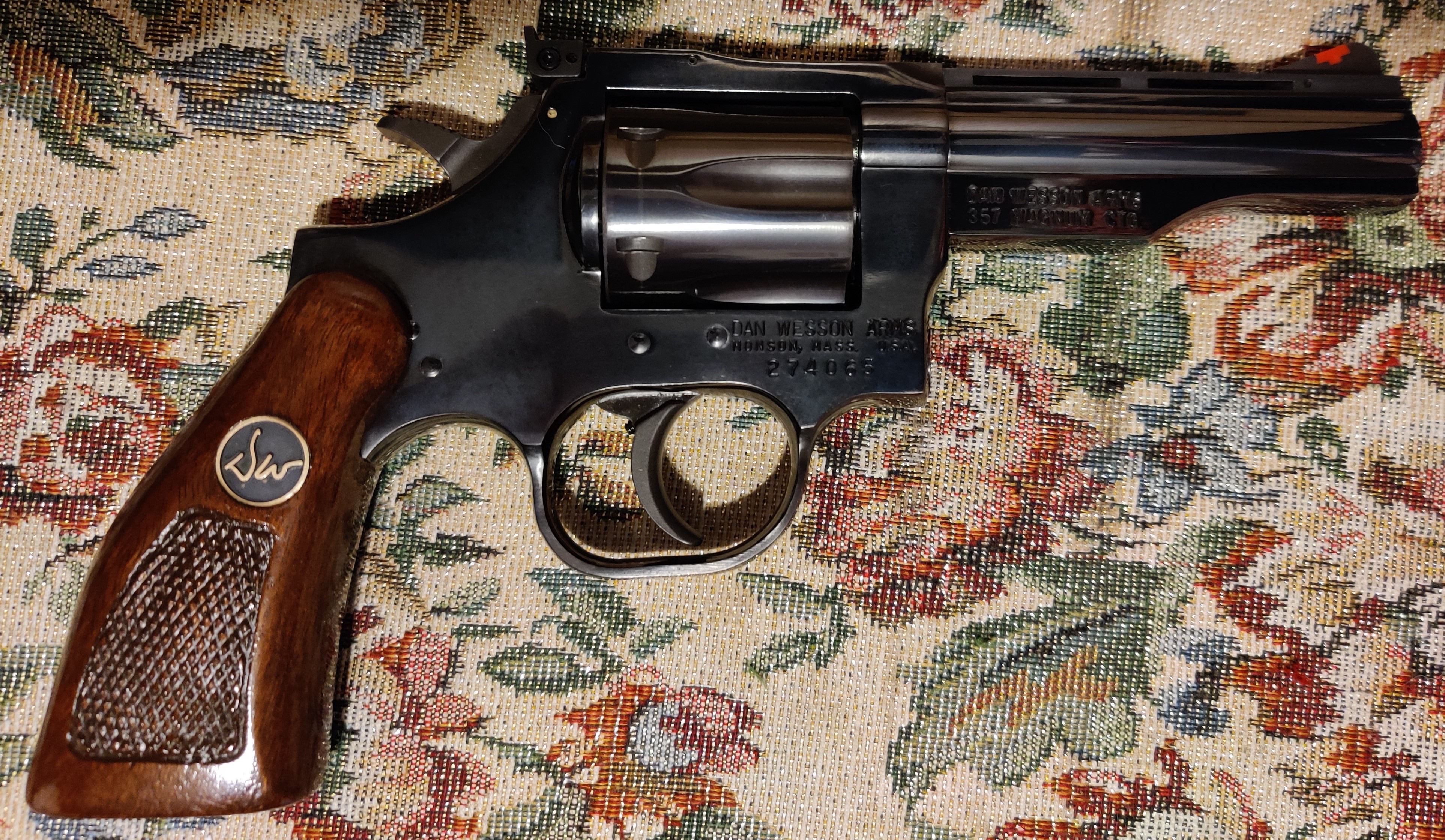

Good morning.  I inherited this firearm from my father who since passed away in 2013; due to Agent Orange related cancer from his service in the U.S. NAVY.  Can anyone please tell me the manufacture date, type of model, grip type, etc.  All I know is that the barrel is Ventilated & 4 inches, stamped "MONSON, MASS.  U.S.A." with SERIAL# 274065, .357 magnum.  Thanks in advance!
Semper Fidelis,
Michael Salinas
GySgt USMC (Ret.)
SERIAL-274065-1.jpgImage Enlarger
DAN-WESSON-15-2_.357-MAGNUM-1.jpgImage Enlarger
July 27, 2023 - 11:32 am
It is a model 15 -2 4V. The 4V  describes the length and style of the barrel. The grip is called a service grip. The barrel lengths can be changed in 2 minutes with a barrel tool and they were offered in lengths of 21/2 , 4,6 8, 10, 12 and 15 inches. The grips are on a grip tang instead of a grip frame and there are many styles and sizes to choose from or carve your own. They are removed by an allen screw on the bottom.
You will need a barrel tool to set the barrel cylinder gap. Read the forum for everything you need to know. Your gun was made in late 1979 or early 1980.

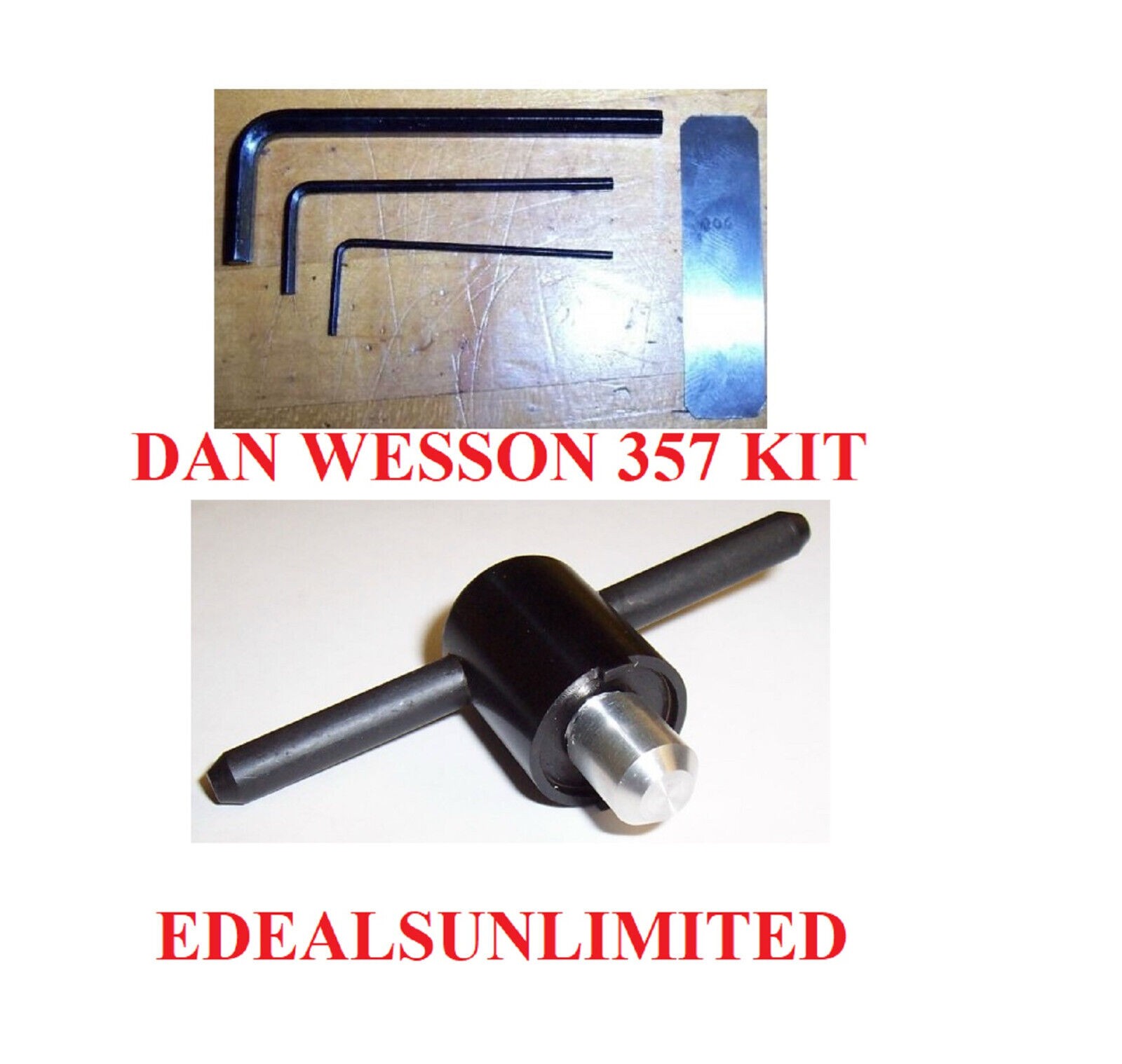

What barrel/gap tool would you recommend? Looking at this one on ebay, (US $69.75).  I think this was last fired in the 80s and stored until inherited 7/26/23. DAN-WESSON-357-MAGNUM-BARREL-TOOL-DAN-WESSON-TOOL-KIT.jpgImage Enlarger
July 28, 2023 - 8:20 am
That is an EWK aftermarket tool. They are well made and have different size inserts for several small frame calibers. I would contact EWK, the have an add somewhere on the forum or you can Google him. I am sure it is cheaper if they have any.
 There are 4 types of factory tools. There is the original flat 12 sided wrench with 3 sizes of Allen screws. They added a 5 sided insert when the 12 sided exterior barrel nut became the interior nut. The 12 sided nut could be removed with a socket wrench. Many folk pan the original tool because if you weren't careful it could slip. I bought bunches of them when no one wanted them. One of the best moves I ever made. Then came the plastic one piece tool with the 3 allen screws incorporated in the design. The metal insert is inside the plastic. The barrel nut should never be over tightened. Over tightening would cause the insert to come loose from the degrading plastic. Unless you need one for an original pack you should avoid them. Around 1980 DW went to the all steel tool with the crossbar and 3 allen wrenches. They are my favorite. The EWK is nice because you only need one for the small frame guns and one for the large frame guns instead of one for each caliber. In 2002 Norwich debuted the doorknob tool. As nice as they are the sell for 200 plus on eBay and have no attached allen wrenches. They have become a collectable of their own.
