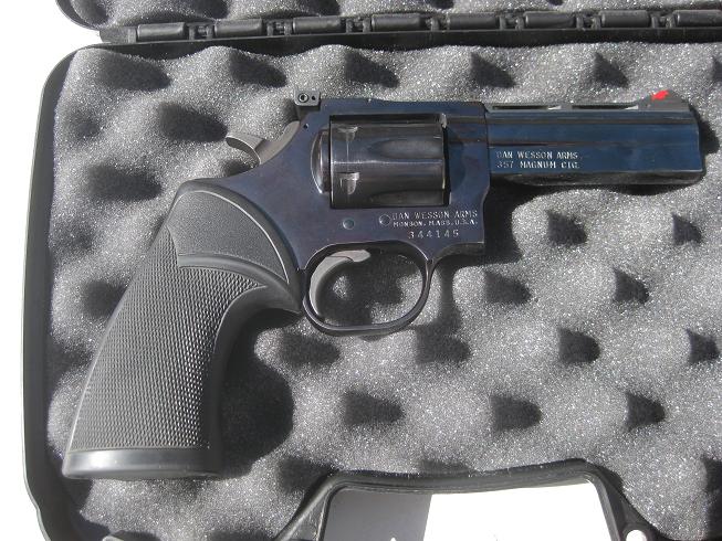

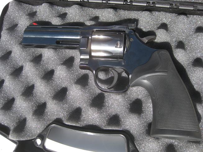

I just bought a used DW today and went out and tested it out.  As far as I can tell from reading here, it's a 15-2 with a 4" vented heavy shroud.  For the first 17 rounds I was very impressed with the pistol.  It has a very light and crisp single action trigger pull.  The double action has a bit different feel than I'm used to, but it's nice and smooth.

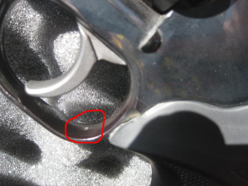

On the 18th round however, the trigger stuck back.  Pulling and releasing the hammer got it to release, but on the next 6 rounds it did it 2 more times.  When the trigger is pulled back it does contact the trigger gaurd.
I have read the "Tuning
up your 15-2 — The Average Joe method….
" post and may try that, but
wanted some advice if anyone has any.
Here's some pics:

First off, Welcome to DWF. My advice is ALWAYS the same:
Thorough cleaning and lubrication, including sideplate off (but not neccessarily disassembly). Your 15-2 is well over 30 years old, and you have no idea the gunk/junk/funk that can accumulate inside. I would use an aerosol cleaner (I use CLP Breakfree) and one of those compressed "air" cleaners for computers.
There should be an overtravel screw, either in the trigger or the frame behind the trigger that may need adjustment.
Finally, spring replacement (and maybe the Tune Up at the same time, since you're there anyways).
Good luck
July 27, 2010 - 8:51 pm
Welcome  The trigger has a stop screw on the back side. It may be :
1. wore and needs adjusted out.
2. missing and needs replaced
3. Lubricated
July 27, 2010 - 8:53 pm
Oops .....Steve beat me to it laughing
July 27, 2010 - 9:35 pm
OK, you definately need to move the overtravel screw out further... I can't even see it in the pics.  Screw it out until the gun will not fire, the slowly turn it in until the hammer drops reliably every time.  You should end up with a nice crisp stop after the hammer falls.

Thanks guys!  It was indeed the trigger overtravel screw. After a quick trip to the hardware store to get a .050 allen wrench, its working prefectly.
