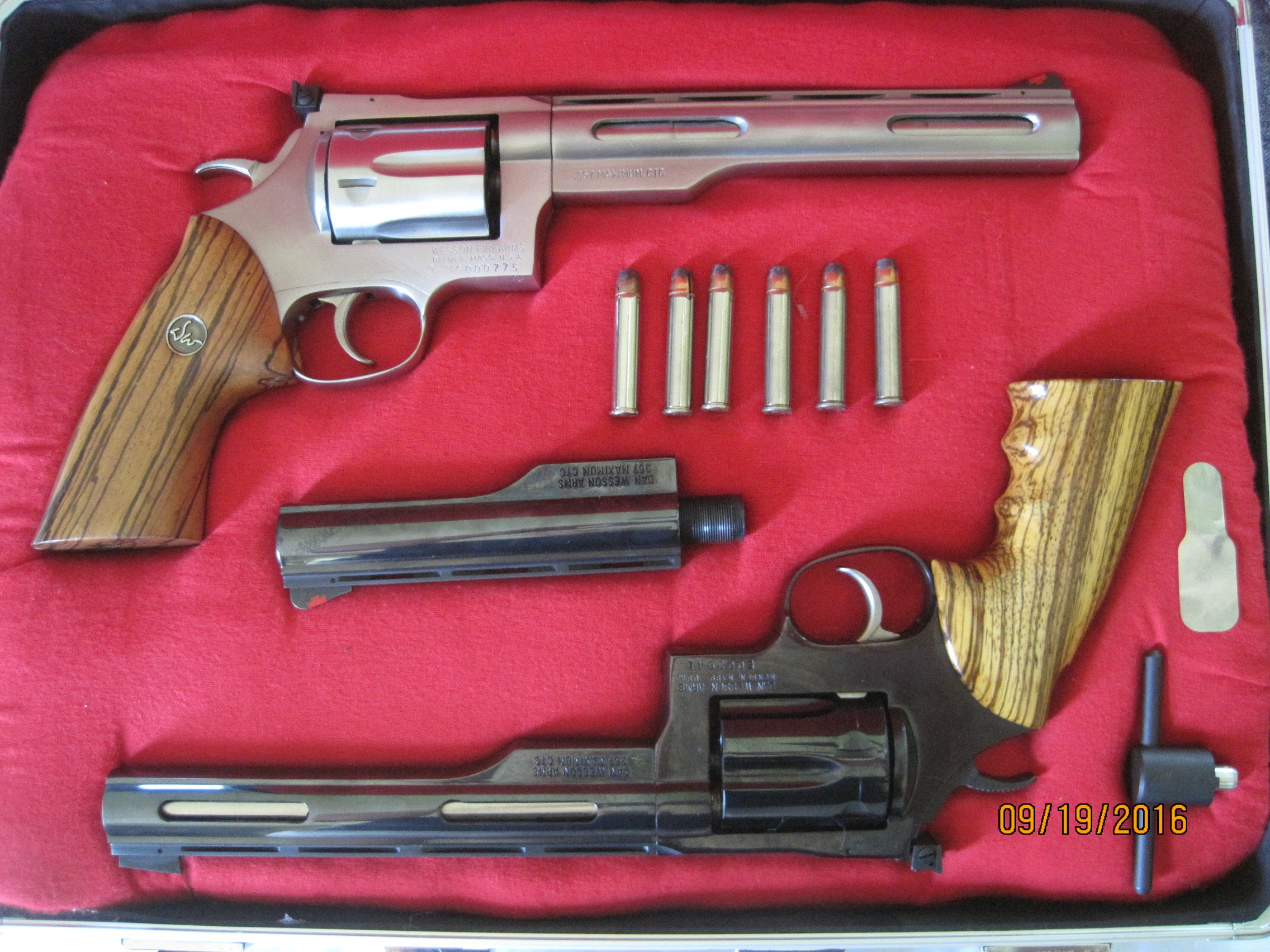

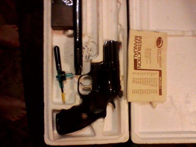

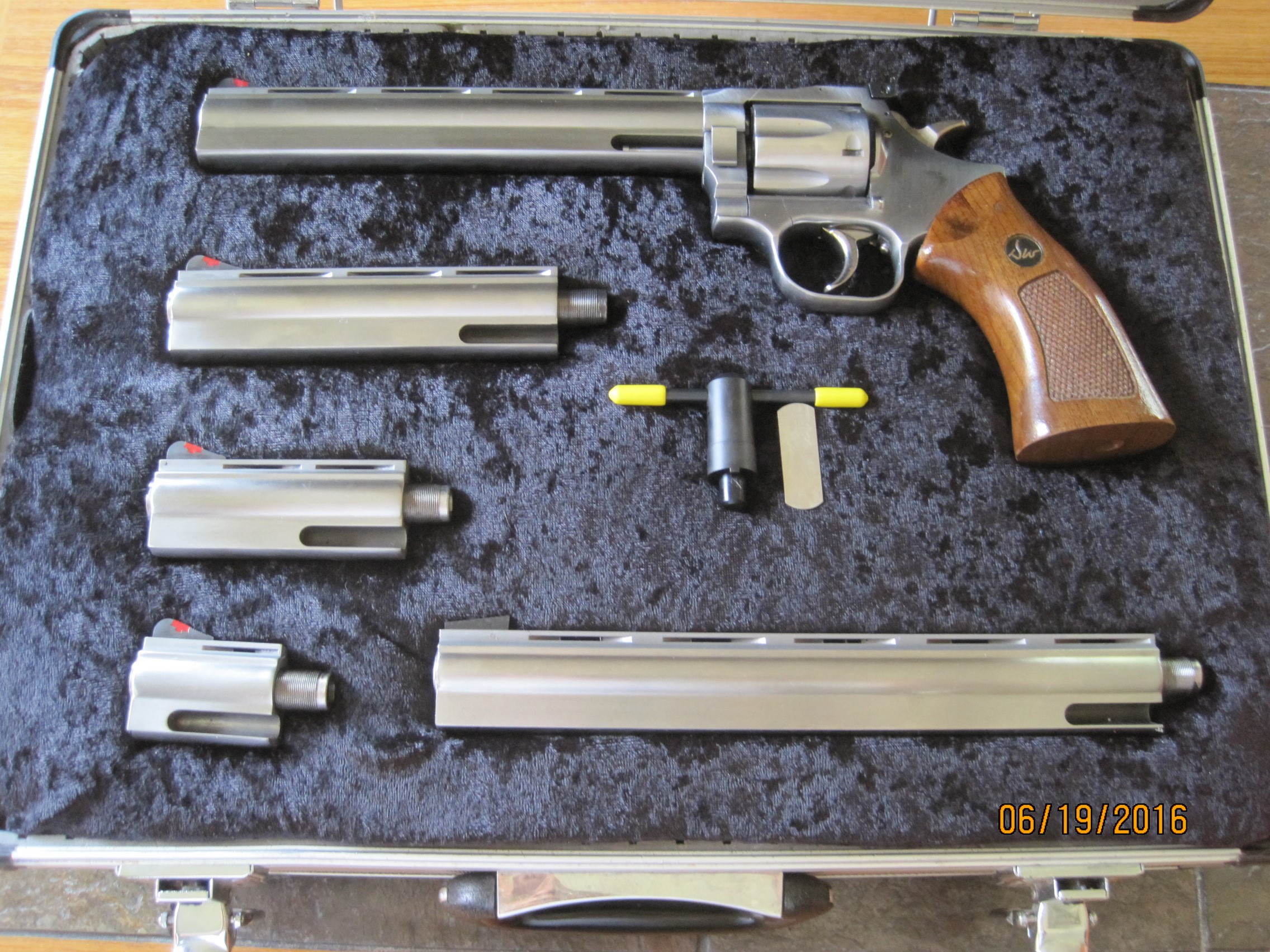

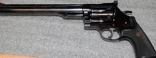

I have started with Dans a year or so ago, now I have one stainless Pistol Pack, one blue Pistol Pack, and three Model 40 Super Mags.  They are addictive that's for sure, here are some pics.IMG_7761-1.JPGImage Enlarger
ALL-BARRELS-CLOSE.JPGImage Enlarger
PACK-ALL-BARRELS.jpgImage Enlarger
357-MAXIMUM-10.20.16-1.jpgImage Enlarger

That sounds like a really nice collection, DA. I'm jealous. smile
The pics just now showed up on my screen. WOW! Eye-popping gorgeous!

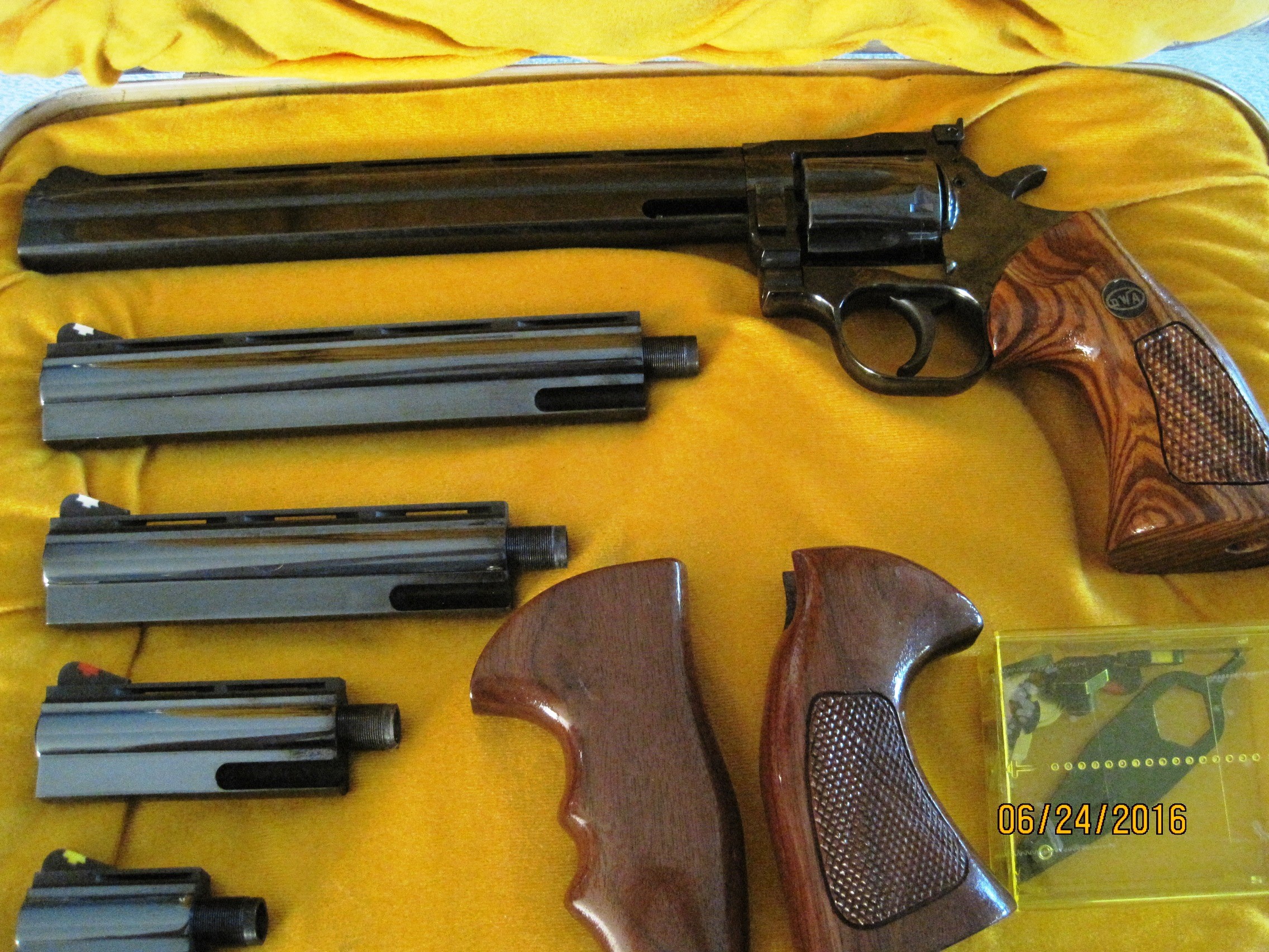

Got it. Thanks. I missed the "upload" button and just hit "submit" the first time.
Picture1026162059_1.jpgImage Enlarger
Picture1026162046_1.jpgImage Enlarger

Looks really nice!  Welcome again!

Thanks, DA. I'm glad to be here. I am unfortunately ignorant about model numbers though. Can anyone help me out with that? I'v looked through several threads here, but don't seem to find the info I need.I need to know the model number before shopping for barrels. Thanks!

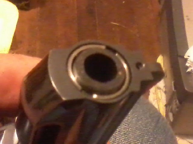

I'm feeling like a dummy. I went to replace the short barrel with the 8" one, only to discover that the square slots in the barrel nut are no longer square. The tool won't grip the slots. Is there a method of dislodging a stuck barrel nut? I couldn't get it to show up very well in the pic, but maybe it will show well enough to illustrate the problem I'm having. Picture1026162228_1.jpgImage Enlarger

You have a Model 15-2. It appears that the barrel is protruding past the shroud and your tool is not getting far enough down on the barrel nut to get purchase in the notches. There is a thread about that .. lemme see if I can find it for you.
October 27, 2016 - 10:39 am
tap it ccw with a small flat tip screwdriver until you can get the tool on it....
October 27, 2016 - 3:21 pm
The cylinder gap must be huge. Don't shoot it until you can reset it. Welcome back.
