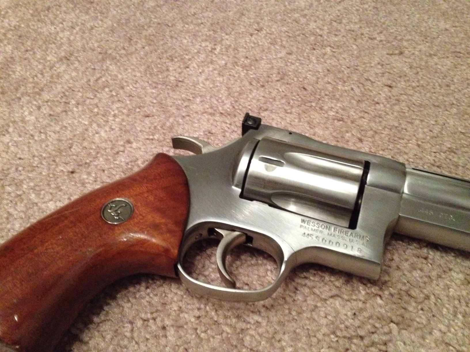

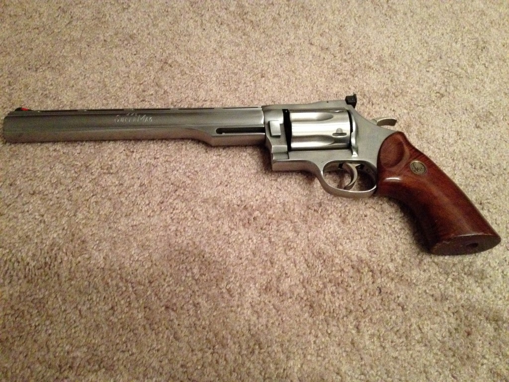

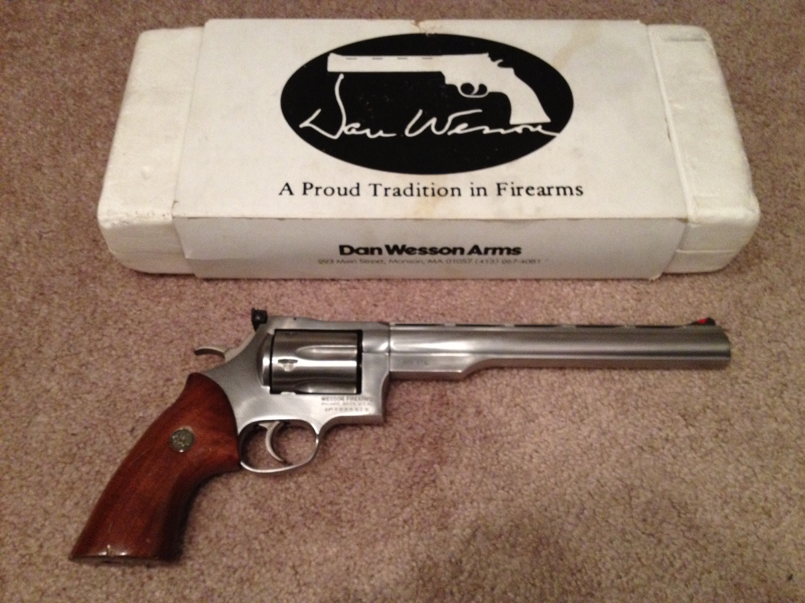

Hello Everyone - was doing some research on a Christmas present that I received over the weekend.  My late half brother was the proud owner of a .445 Super Mag and my half sister though it best to pass it down to me as a christmas present.
I wasn't sure what it was worth or where I can find ammunition or accessories for it.
Serial Number is 445S000918 and it was built in Palmer Mass.
Looks to be stainless and has a 10" barrel
Came in the origional styrofoam box with cardboard sheath.

welcome to the forum and thanks for the cool-pics.  As LB said, very nice hog leg.  (I've got it's little brother, a 357 SM in stainless from Palmer.)  I'm guessing that you can fire 44 specials and 44 magnums as well as 44 SM through it.  (At least my 357 can easily handle the specials and magnums also.)  One thing if you use the lesser rounds is to clean the carbon scoring out of the cylinders holes.  If you don't, you may have trouble inserting or more likely ejecting the SM's once you go to those.  It's not a big deal if you keep up with it.  For accessories, check out EWK Arms and LB Custom Grips.  Both do great work.  Unless you already have an EWK barrel wrench, you really want one of his.

Conservatively since you have the box and it's a 10" you're probably looking in the $900-$1200 range if it were to come to auction on GunBroker.
