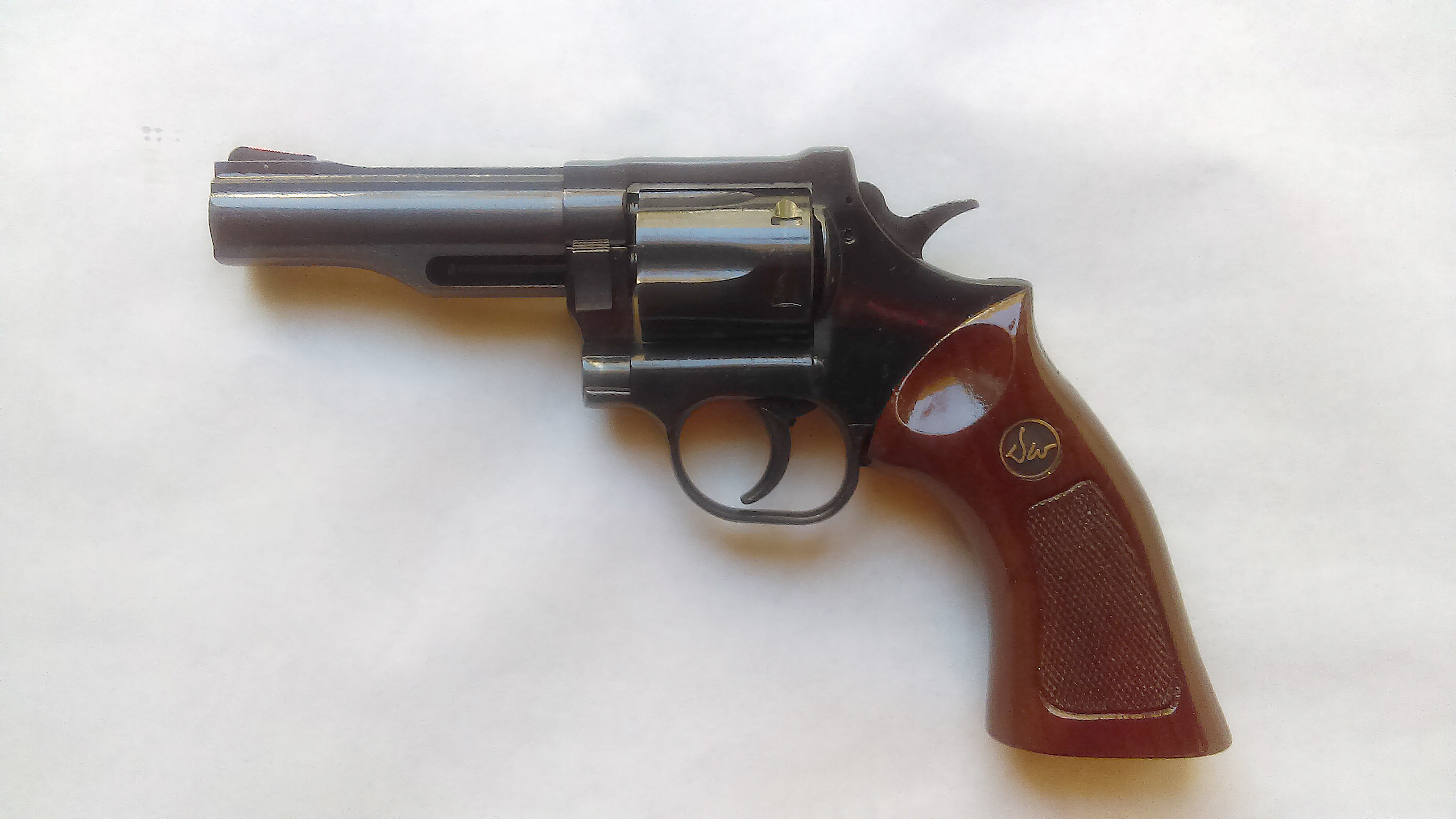

Hello,
I am a new member and just recently purchased my first Dan Wesson revolver. To my understanding it's a 14-2, but the gun shop where it was purchased, swears it's a model 15. It has fixed sights and a recessed barrel nut. I can't wait to test it out at the range. Can anyone shed some light on to which model that this is? It was made in the Monson factory. Attached are some pics. Another thing that is baffling me is that their seems to be a slight bevel where the red arrow is pointing. The bevel looks like it is factory because the frame and cylinder look as though they are in excellent/near mint condition. Thanks so much.

dwf-welcome to the dwf and thanks for your intro and cool-pics
The Model 14 & 14-2 have fixed rear sights and the Model 15 & 15-2 have adjustable target rear sights.

Actually, that is a 14-2 (not a 14). Fixed rear sight+recessed barrel nut= 14-2. The bevel that you highlighted is definitely not factory. There is no rational reason I can see for that to have been done.

That is a nice looking 14-2 you picked up, nice score.
The bevel is aftermarket, I'd guess somebody managed to put a burr on the frame at that spot and filed it out producing that bevel.  As Steve said, I can see no functional reason for it to be there.

cool-pics Hello from Ohio. yes on 14-2 4" a 14 has a porkchop barrel, correct ?

... a 14 has a porkchop barrel, correct ?
Correct.

Are you guys sure about the "pork chop"? Maybe my eyes but the barrel lug appears to end on the frame face just below the extractor.
