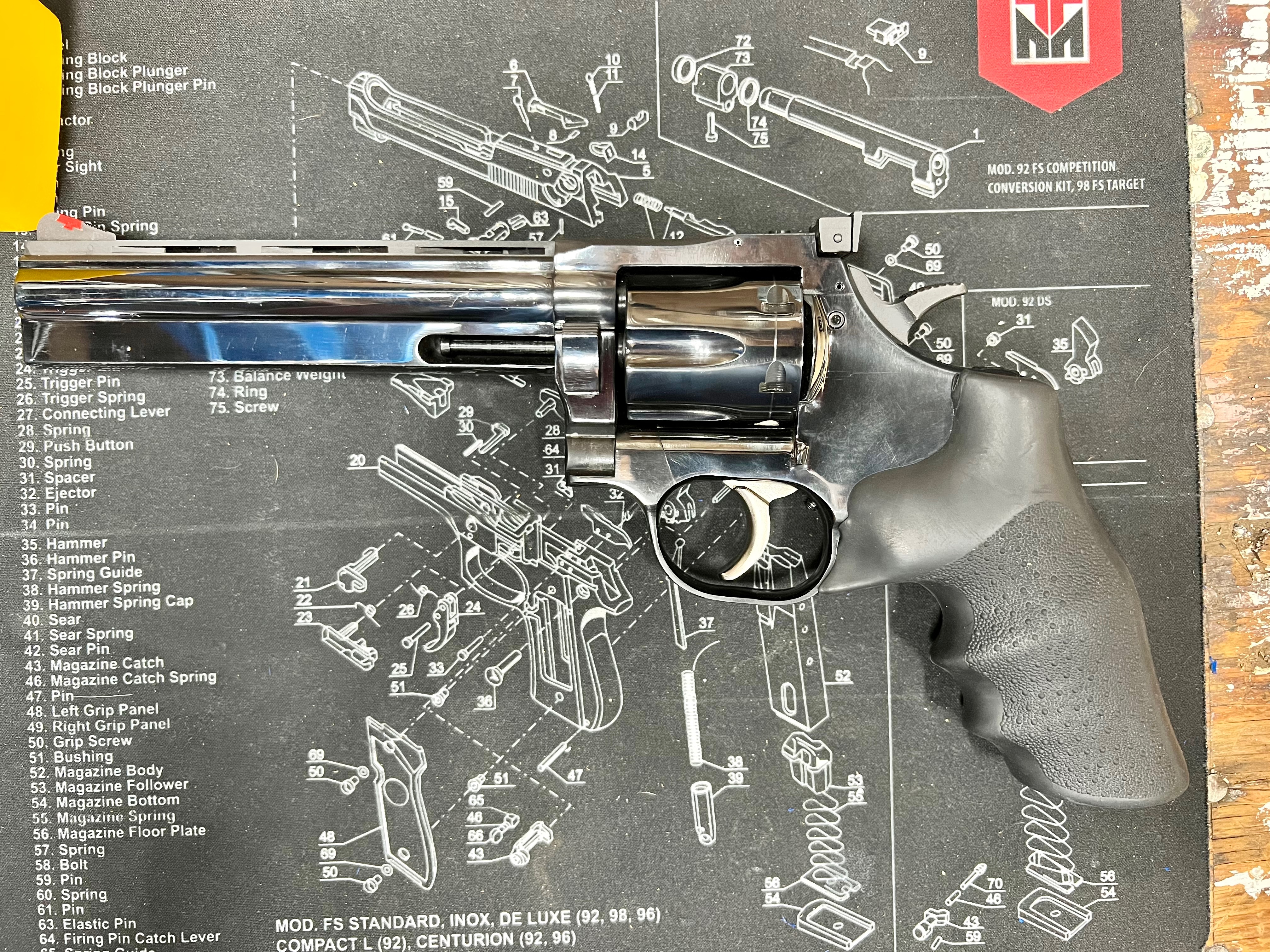

I stubbed along the forum to learn more about my new to me Palmer B00 15-2 I just bought and try and figure out why the timing is off. I plan to give a good cleaning and replace the spring first.

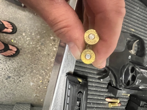

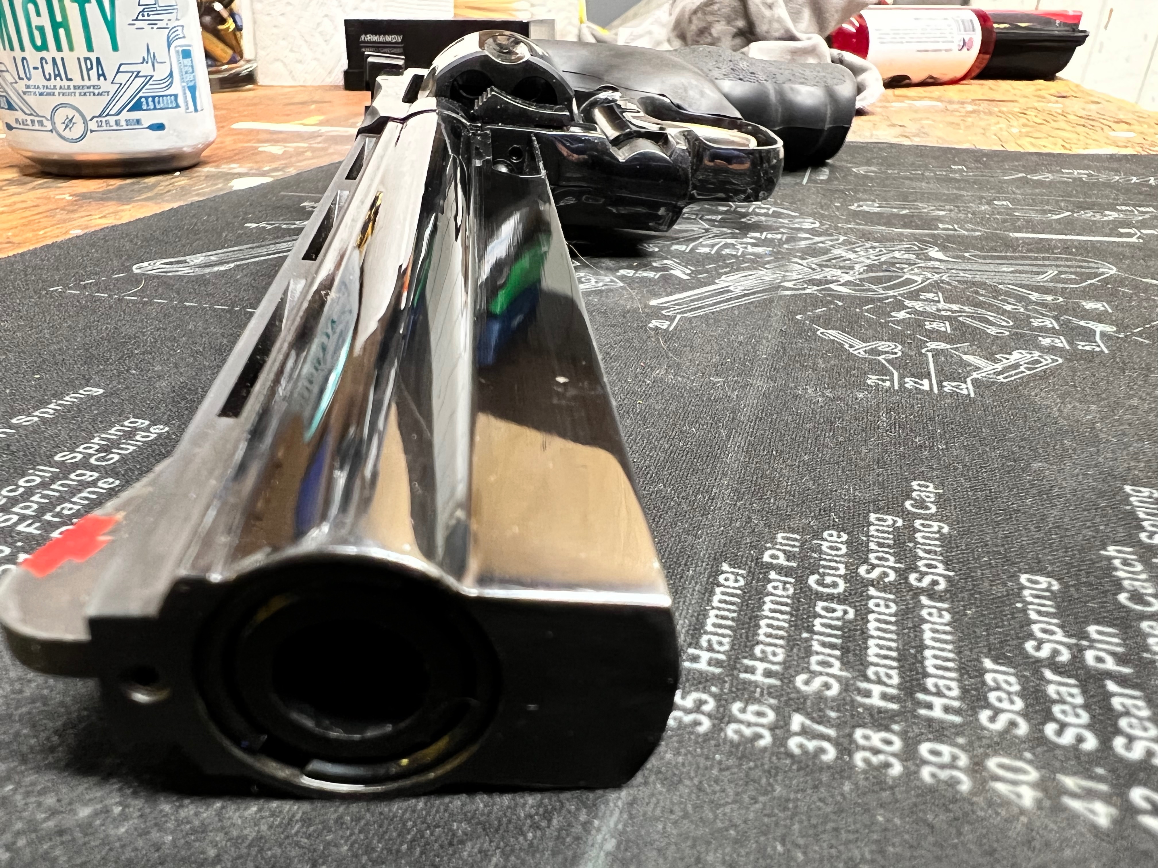

Is your 15-2 spitting propellent? What are your symptoms of timing being off? Off center firing pin mark? Could just be the barrel cylinder gap. You came to the right place. Don't take it to a gunsmith. Most are woefully ignorant about Dan Wesson revolvers.

June 15, 2022 - 12:08 pm
It could be I really didn’t notice that.6CB2EF0E-567F-411E-8742-FC9A9DF59455.jpegImage Enlarger
June 15, 2022 - 8:38 pm
Hard to tell about the firing pin mark from the photos. If the gap is too big it will spit propellent. Do you have a barrel tool. Read the forum about setting the gap. Factory says six thousandths of an inch on the proudest chamber. Measure all six chambers. I use a automotive feeler guage instead of the shim they provide. Do not force the shim in. It will push the cylinder back against the dedent ball and result in too small a gap. I would use 4 thousandths of an inch on a 15-2. Take the barrel tool with you when you shoot. Always unload when adjusting the gap. When you tighten the barrel nut put a thumb against the forcing cone so the barrel doesn't turn. Don't over tighten the nut. Snug is good enough.
June 16, 2022 - 7:37 am
That firing pin mark is way off.

June 16, 2022 - 10:17 am
I ordered a new hand, mine looks modified maybe a little to much.
