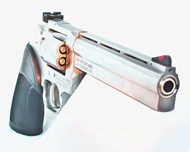

Hi Everybody,
I've been reading posts here for a few months, hoping to find a Dan Wesson. I would be happy with several models, and ended up with this beauty:
I am very happy to own it. The double action trigger pull is very smooth. Now I need to work on the single action, b/c it is creepier than Bill Clinton at a Girl Scout meeting.

Your 715 6VH is pretty much the classic, mainstream Dan Wesson. Good luck with your barrel nut, I had that problem just once (way back in 1978), and it went back to the factory for repair. Did you see this thread:

Forest  Welcome to the DWF.   Great pic of your 715. I really like the lighting effect.  That pesky barrel nut can be a problem. I had to send my Model 22 Mag back to CZ to get it fixed. I believe once you do in the wrench you're sunk.  The punch idea sounds scary to me; I'd hate to see you damage the shroud or barrel.  I now tend to tighten mine only snug and check it on the range after a few rounds just to see that it isn't getting loose.

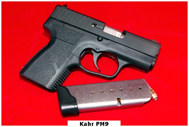

Here is my PM 9, which kind of surprised me -

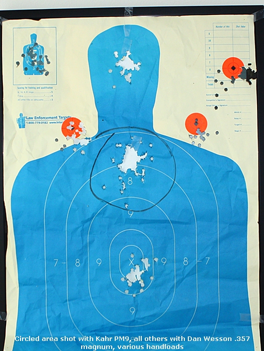

Note I'm only at 7 yards, so I'm a long way from being a pistolero. I'm hitting groups at 4 o'clock, as you can see. I don't know if it's a flinch,or just the sights are off.

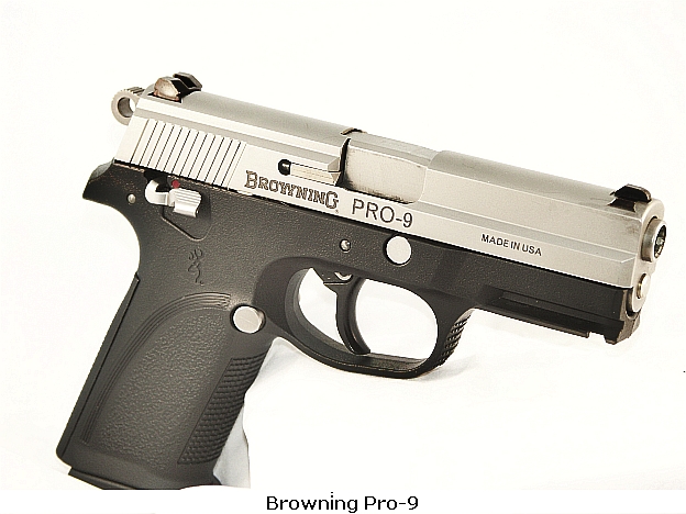

Here's a gun I don't shoot enough. I think it under-rated. Aka FN-9.

Nice shooting with that Kahr. I have an M&P 9c that shoots exactly the same at combat range, dead on POA and fist sized groups all day long. It's actually my "nightstand buddy", with an Insight X2L (light/laser)

Photohause - thank you for the chart. I'm left-handed, so I can switch 8 o'clock to 4.

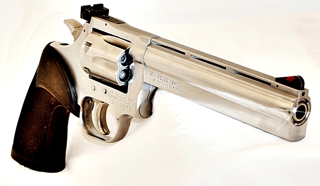

The warm welcome is most appreciated. IMSHA - handguns are a gateway drug to more expensive firearms. I think a 445 might be the ultimate for me because I could go from mild to heavy loads and know that DWs are built to be shot.

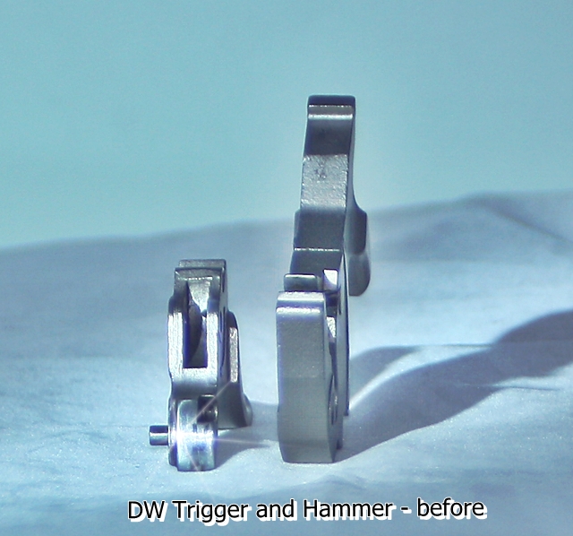

Update - I've installed the Wollf springs (with the 7.5 pound main). Also, I polished the hammer and trigger at the friction point.
The SA pull still has plenty of creep, so now I start very carefully grinding a bit. After that, I got out the Flitz and polished the outside.

October 2, 2009 - 4:59 pm
I'm having a bit of trouble w/ the pics - after the preview, the text and images are not where I want them. Should I ask the mods? Note - I did read the faq first.
Thanks,
Forrest
your SA pull has "plenty of creep"...?  That is purely trigger/sear/hammer engagement, which is already pretty tight on most DW's.  I barely had room to polish my trigger engagement, yet alone reshape anything.  Maybe there is a difference in engagement surfaces.  Most of mine have the "glass rod" SA trigger break.
