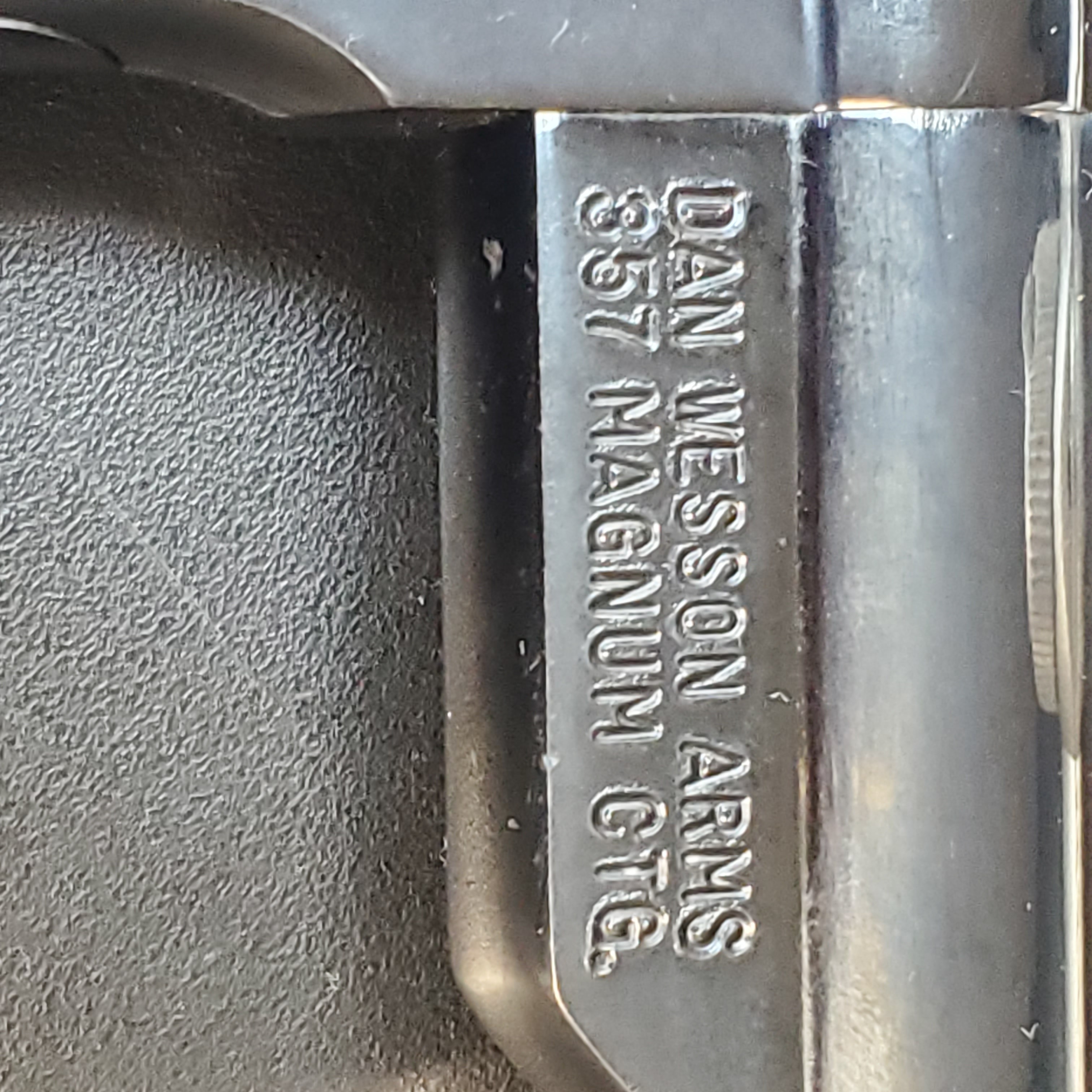

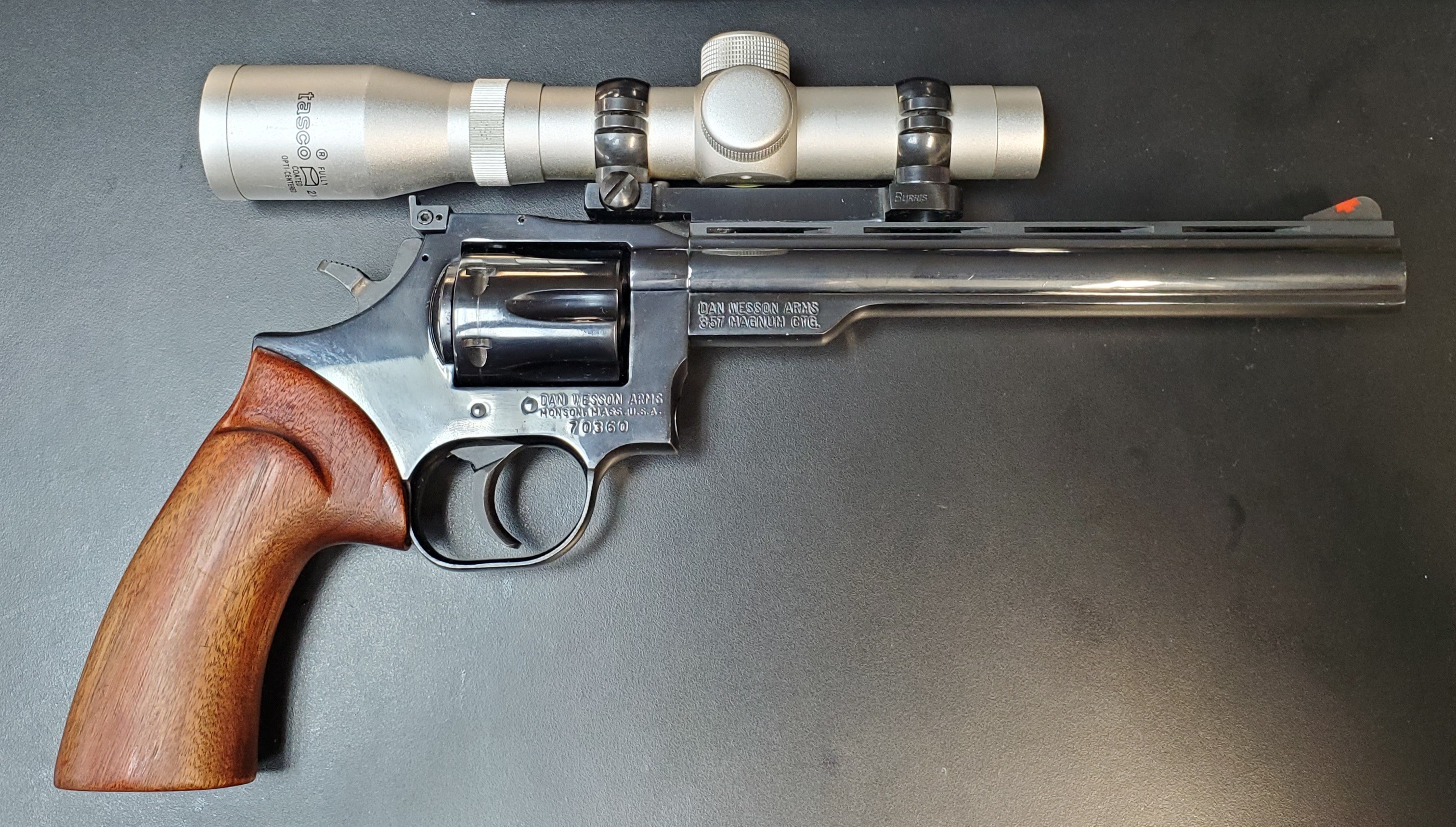

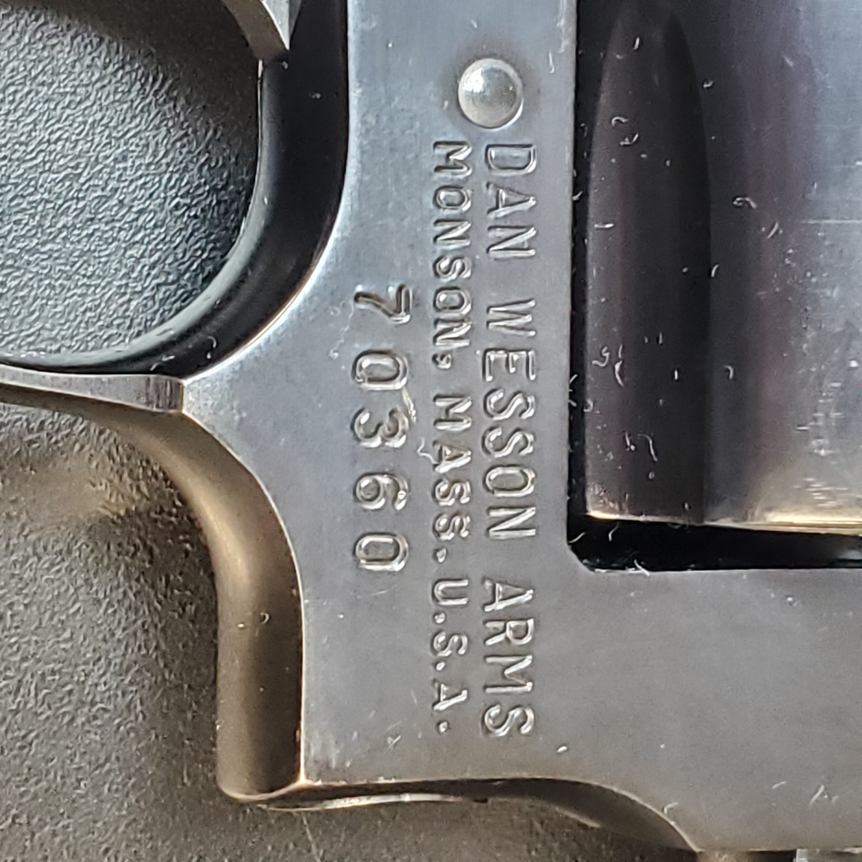

Good afternoon,
I'm new to Dan Wesson firearms.  I recently acquired one and have tried to look up the model.  Unfortunately I can't tell if it's a model 15 or 715.  The grips also look like Dan Wesson from the ones I've seen minus the DW logo.  Are they original?  The scope is mounted on a Burris scope mount.  I appreciate any help you can provide.
Jeremy in PA20220104_163205.jpgImage Enlarger
20220104_163213.jpgImage Enlarger
20220104_163216.jpgImage Enlarger

Hello Jeremy.
Welcome to the Dan Wesson Forum.  Your pistol appears to be a 15-2 with a Vent Rib barrel shroud.  A 7 prefix on DWs means it's stainless.

They are definitely early DW original grips. Your gun looks like an early 15-2, so the grips are probably original with that gun.
January 7, 2022 - 5:27 pm
Those are the original target grips that was an option on the first Dan Wessons made, the models 11 and 12. They are called Michigan grips. I think they were designed for a Michigan LE Agency. They look a little funky, like a handle, but they are very comfortable. Your gun is a very early 15-2. The 15-2 debuted in late 1974 or early 75 around serial number 50,000. Yours was made in the first year they were made. The first interchangable front sights started around 75,000. The 8"V  Barrel Assembly may not be original to the gun. I doubt the grip was either. By 1975 DW was using DWA medallions and the wide base target grips.

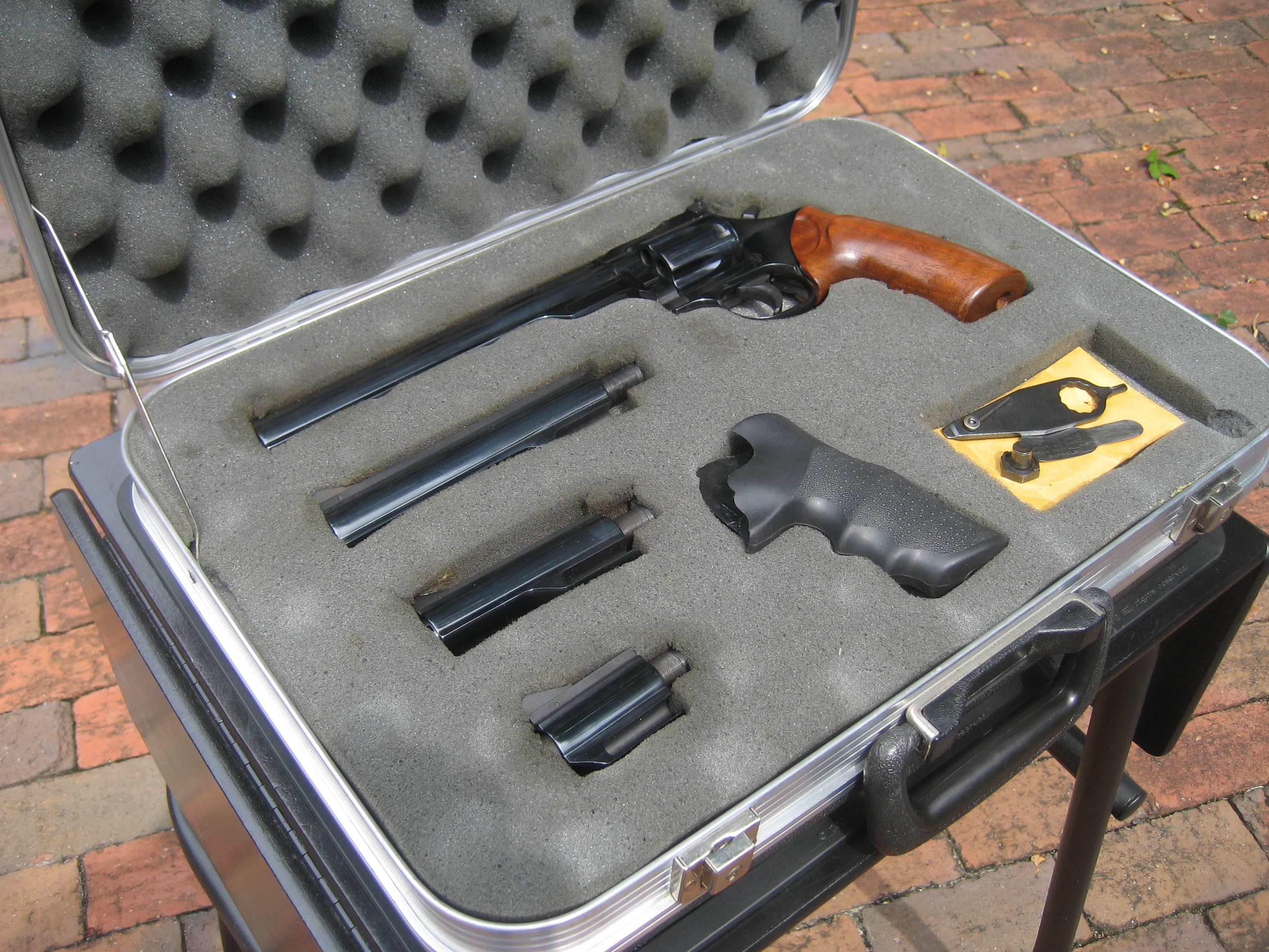

Ole Dog is usually right. Here is a photo of my first PAC. Serial number 67343. It has the same grip.
001.JPGImage Enlarger
007.JPGImage Enlarger
January 7, 2022 - 8:42 pm
Perhaps they had inventory they used up. Gun makers hate to throw away parts. Notice the lack of colored inserts in the front sights. No Allen screw on the muzzle I bet.
