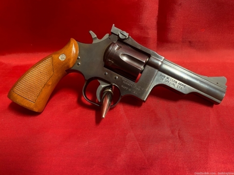

I'll try to add a picture from the auction.  pix214061591.jpgImage Enlarger

A very nice example of a rather rare DW Model 9. Enjoy! It will prove to be an excellent shooter!!

You are absolutely correct. Identical to the 357 but the cylinder is reamed for 38 Special. The cartridge has a rim but it heads spaces on case edge. You can have it reamed out to accommodate 357 or you could find a cylinder assembly in 357.and you could swap it out when you want to shoot 357. I have several extra porkchop cylinder assemblies or just cylinders if you can't find one.
