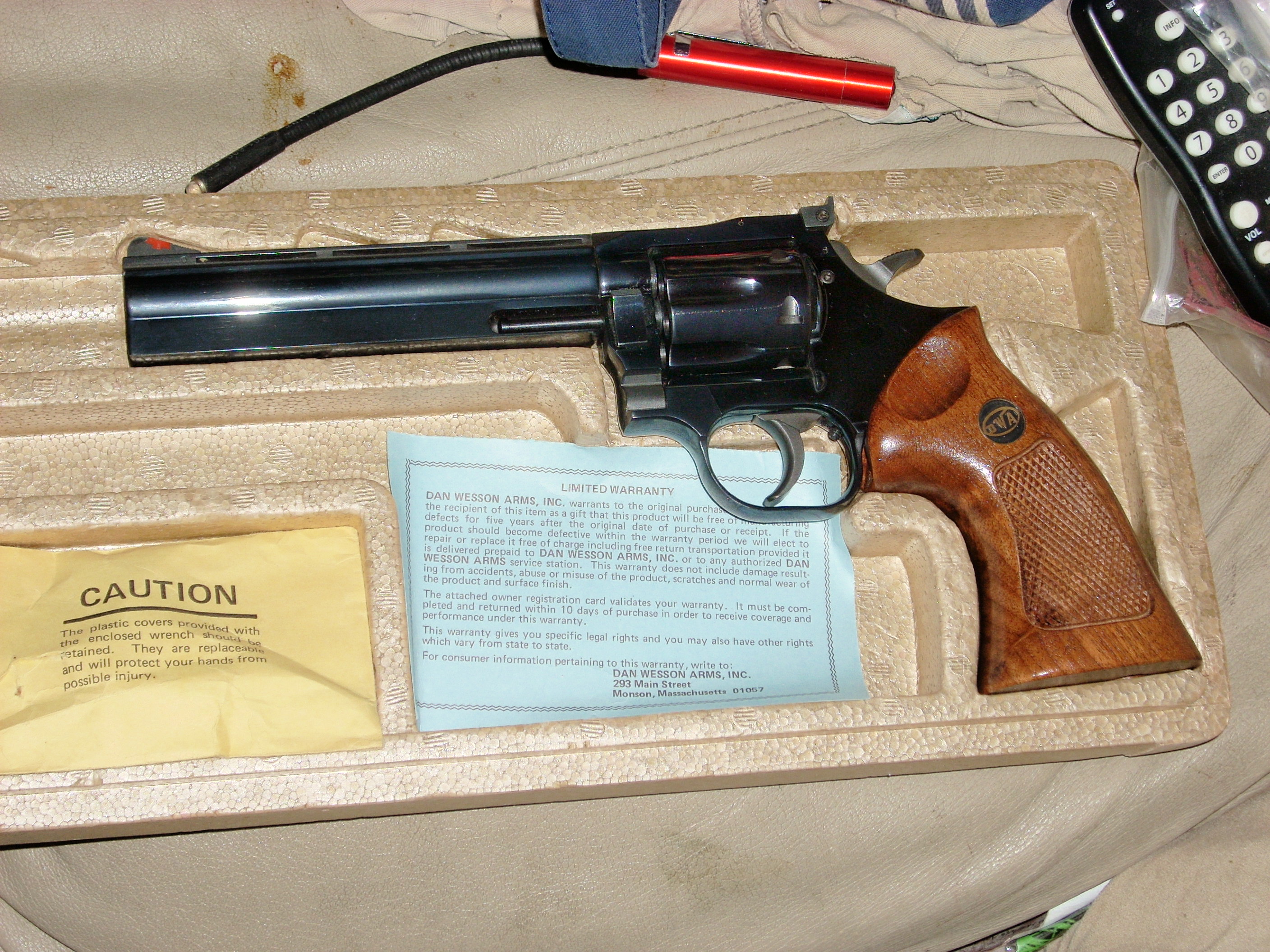

Dan Wesson 15-2
Hello, new guy with new 15-2 with 6" barrel, sold as unfired and appears to be so.  It looks and feels great, can't wait to fire it.  I have a friend that used to be a silhouette shooter. He used  a Dan Wesson.  I have a United Sporting Arms Single Action .357 that I like a lot, but I expect this Dan will be my favorite.
I'll try to post a picture

Wecome to the forum, Bill. That is a beautiful piece of work. They shoot as good as they look. You will find all the information and advice you need here at the DWF! You won't find a greater bunch of generous and knowledgeable folks.

Welcome to the forum. You have a beautiful gun.  Take good care of it. A couple of little pieces of advice. Most  15-2's get scratches on the sideplate from the extractor star being extended and letting the cylinder start to close. Keep the gun tilted to the left and your fingers of the left hand keeping pressure on the cylinder through the frame while ejecting cases. I know you would hate to see your mint gun scratched up. Also don't bang on the ejector when cases are stuck. That can knock the cylinder stop out. DW sells replacements for that though. A pencil works good for stuck cases. By the way,  the desire to own more dans is called Dan Wesson Acquisition Syndrome and is very commom. Good Luck.

That's gorgeous. Enjoy.
July 2, 2014 - 11:42 am
Welcome to DWF. Trust me when I say you've acquired the best revolver of all time, and she's a beauty.dwf-welcome
