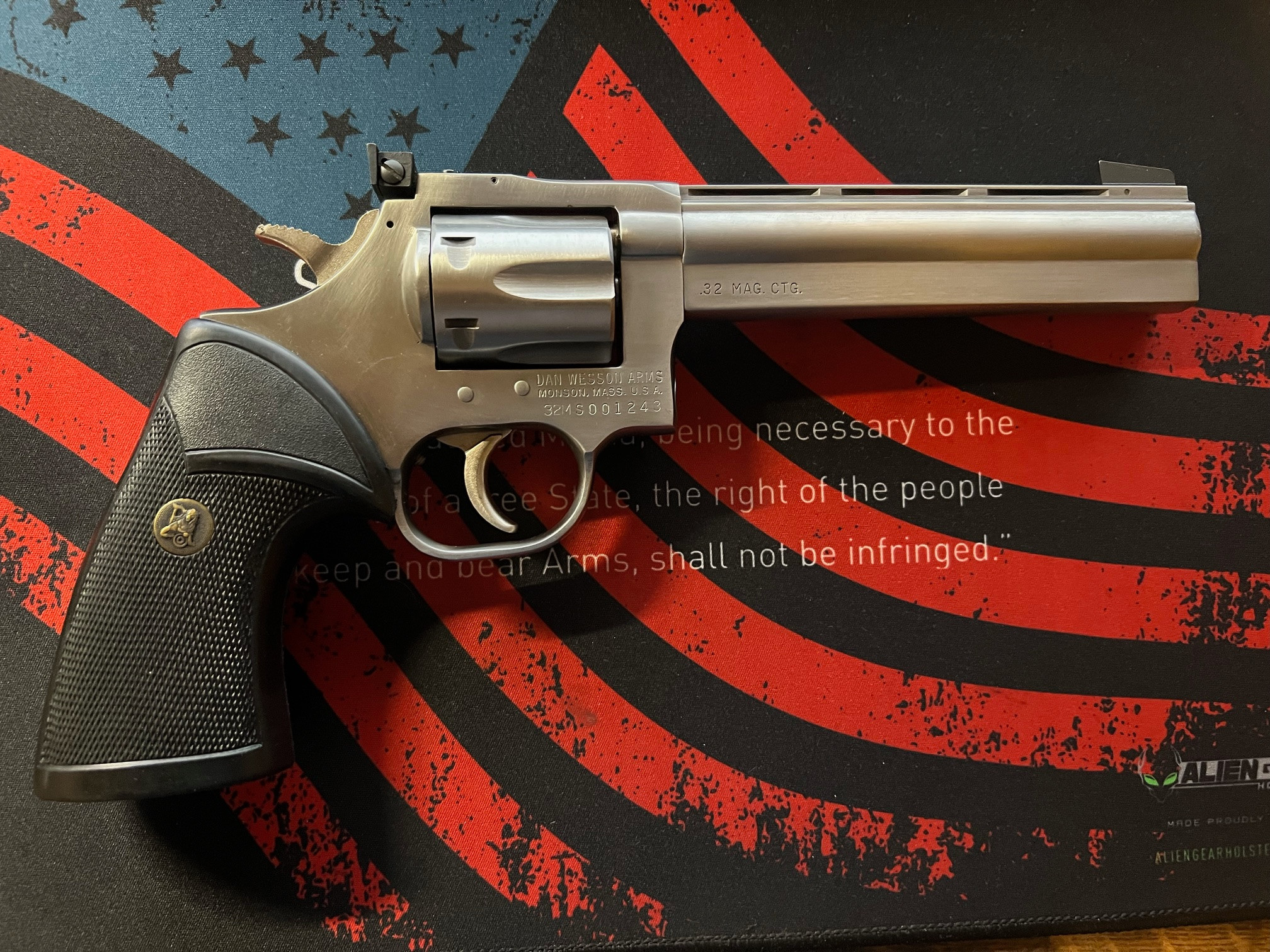

I've never owned a DW before but I do now.
Just picked up a 6" 32 Mag in SS trappings, all the pictures I have been able to find of other examples indicate 32 H&R Mag, this only has 32 Mag stamped on the shroud...don't know what this might indicate if anything...maybe nothing other than a production run set up by a different operator?
Not looking for value (Its not for sale), but any information anyone on the forum can offer would be greatly appreciated.

Welcome to the forum!
Looks like maybe a Monson frame with a Palmer shroud.
February 13, 2024 - 8:17 pm
Welcome to the Forum from Wisconsin.  Scorpio is correct a Monson frame with a Palmer barrel assembly.

Admittedly I do not know much about DW revolvers, apparently its very easy to substitute any shroud on any frame given correct frame size, threading and barrel length, full functionality being dependent on pairing with the appropriate cylinder, the question is would this have been factory or is it more likely a franken-gun assembled from parts on hand?
I do not yet have any factory loaded ammo in 32 mag, but I do plan to run some S&W long through it this weekend weather permitting. Hoping to find an exceptionally accurate gun as the cartridge has that reputation. 32 mag brass and boolits being readily available I'll roll my own when the components and dies arrive.
Have read that the Monson revolvers were considered a touch better in quality control, but if this is a palmer shroud I do not have any issue with the fit and finish, at least so far. Is there any method to identify the barrel manufacturer, I do not recall seeing any markings when disassembled for cleaning.

My favorite cartridge. I have a couple of 732s and more than a couple blue ones. I suspect it is all original. I have several guns from early 1990s that have Monson frames and Palmer shrouds that are ANIB. When Palmer small frame production started existing Monson frames were married with Palmer shrouds. No Frankengun at all. The serial number starts with 32MS. In 1986 the caliber was added to the serial number. Palmer kept that format. You should find a nice smooth zebra grip for your gun to wear on Sundays. 😉

What makes it a Monson or a Palmer shroud?
Forum Posts: 1236
February 16, 2024 - 11:01 am
Monson has a two line caliber marking on the shroud, Palmer has a one line.
February 16, 2024 - 11:33 am
Well, actually .. the Monson roll mark has Dan Wesson on the first line and the caliber on the second line. Palmer only has the caliber line rollmark and Norwich has a single line caliber etched.

One other thing that has caught my attention is the front sight ramp is installed in an nontraditional orientation, some DW's, especially those with light catching inserts are in the common configuration (it would be counterproductive if the shooter couldn't see the insert) so that makes sense but those with solid front sights have the high point of the ramp to the rear, assuming there is some benefit to this installation I still don't get it, although rotating the sight 180 is no issue and seems to have been cut to facilitate such a procedure.
Is there some benefit in target shooting sight picture that I am unaware of?
February 18, 2024 - 3:18 pm
The ramped sights facilitate drawing from holsters and not snagging clothing in a tactical environment and the Partridge sight is designed to provide a crisp shadow for target shooting.
