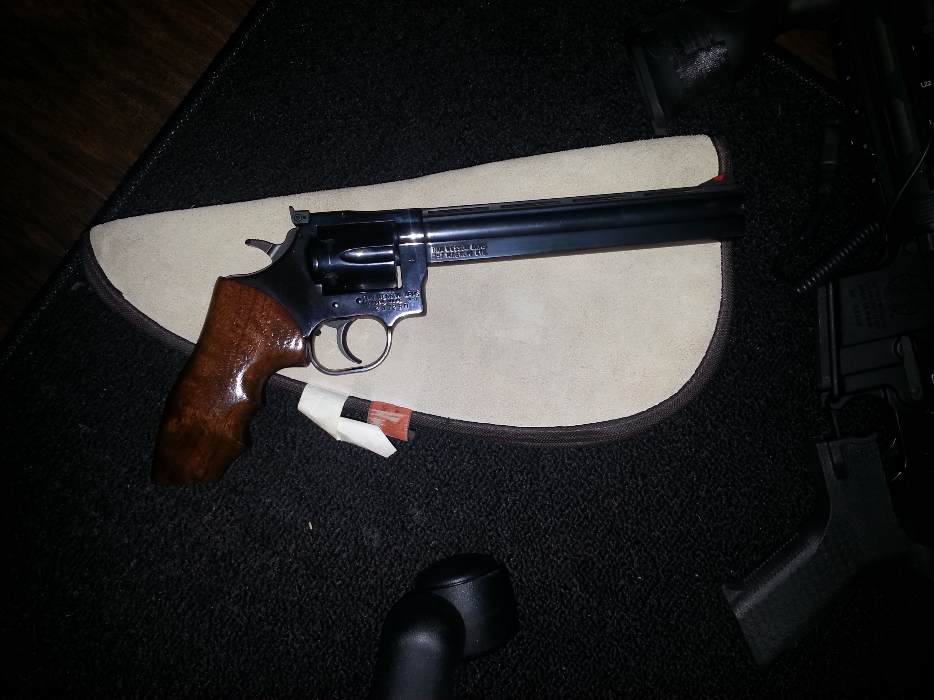

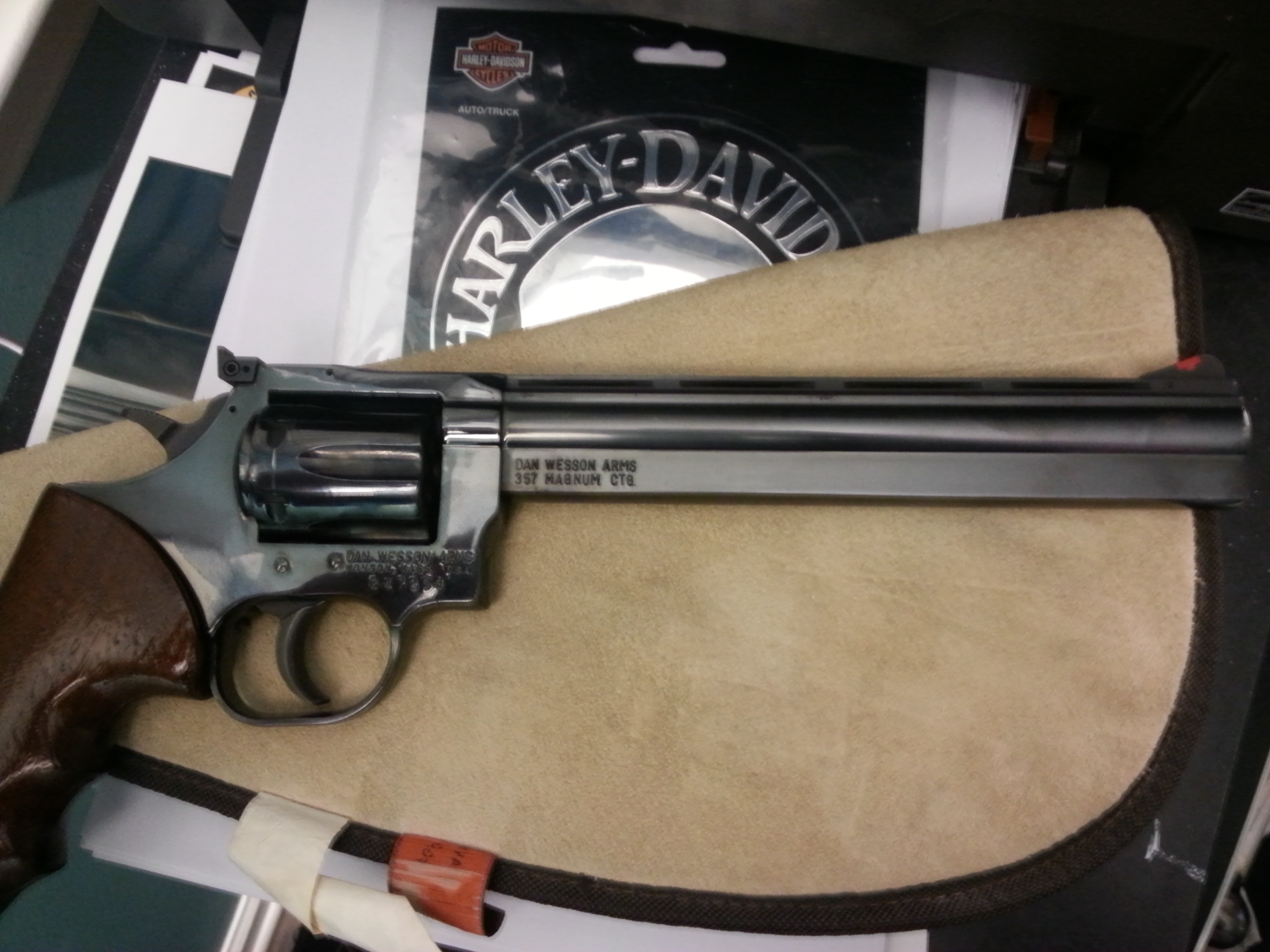

Hello all...new member here. Excuse the ignorance. I have a .357 that i have had for 20+ years, and never knew much about. (except that it is a hand-cannon! 🙂  After reading many of the posts ,i believe it is a vh8s ?? Model 15 ??  Not positive. Any help is appreciated.
20151227_051236-1.jpgImage Enlarger
20151227_050836-1.jpgImage Enlarger

Sorry about the upside down pics....not sure how to fix it!
No problems- fixed, rwsem
December 27, 2015 - 6:27 am
Welcome to the DWF!  You have a very nice model 15-2 Vented rib, Heavy lug, 8" barrel but it is not Slotted; VH8.  Thanks for posting the pics.

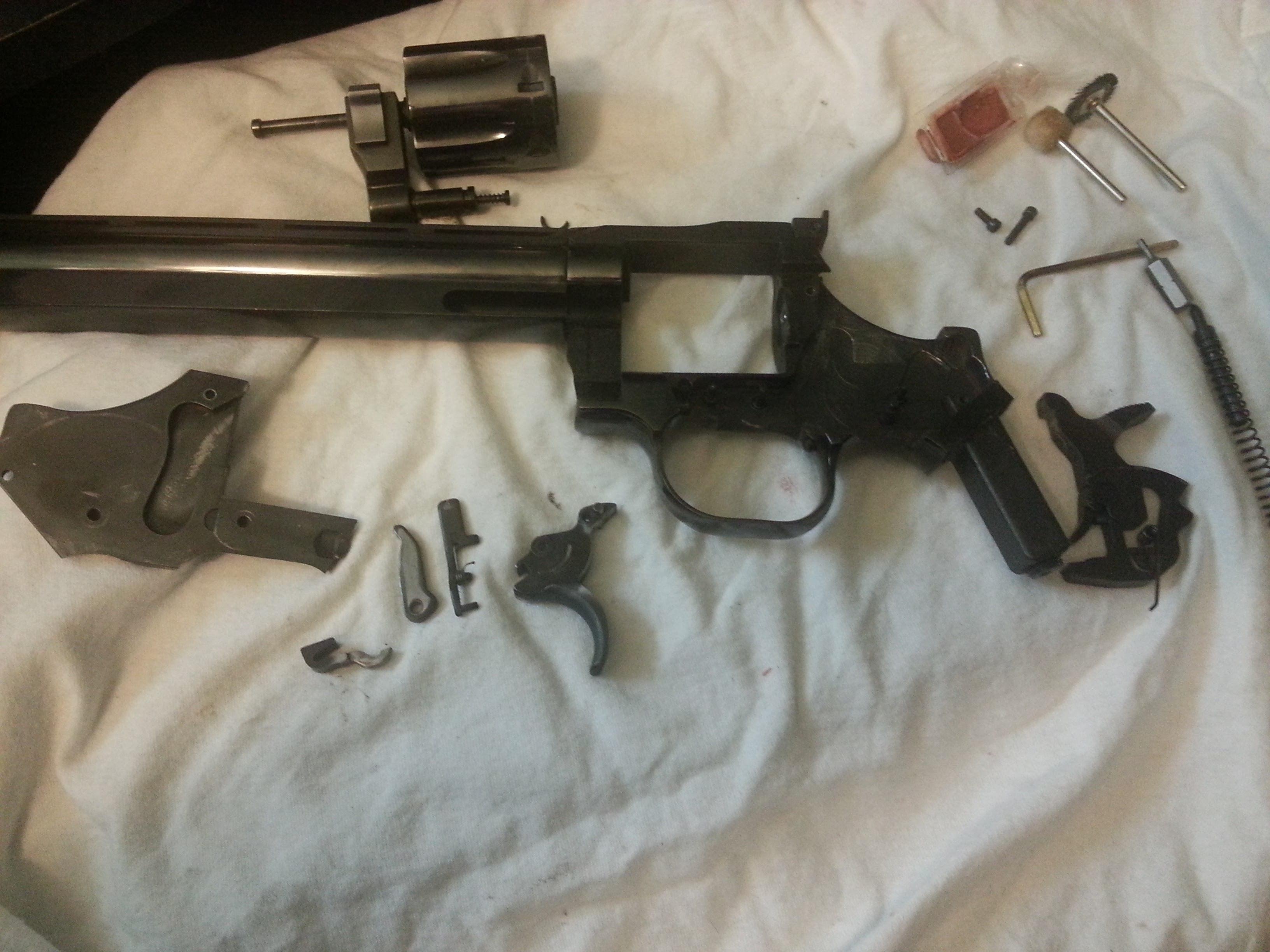

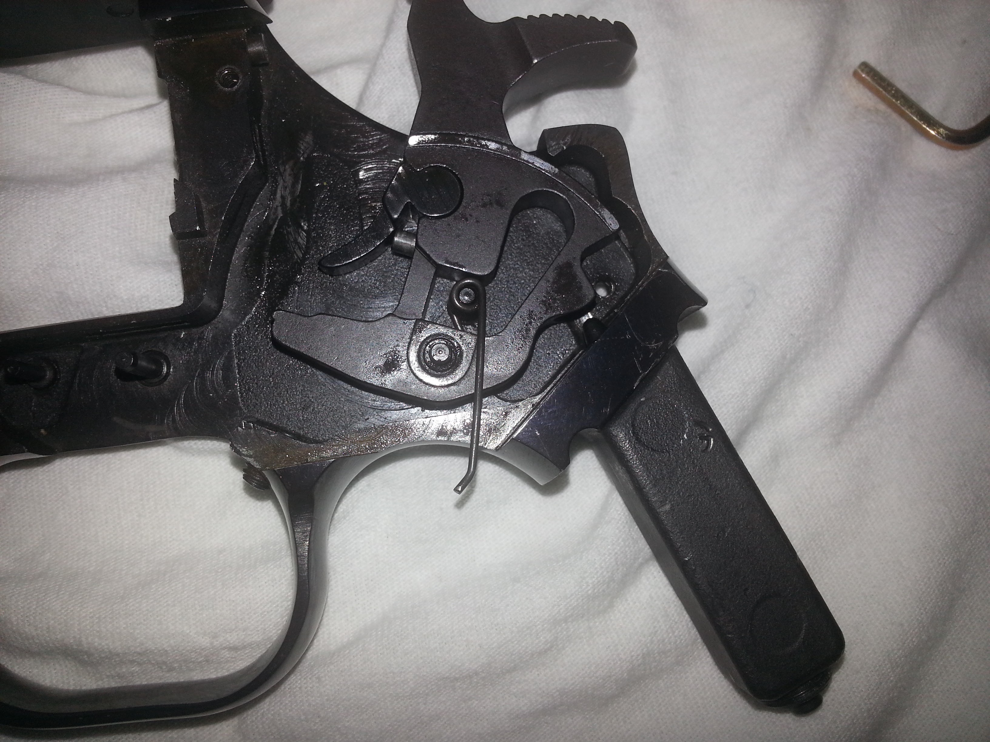

December 27, 2015 - 10:42 am
20151227_103442.jpgImage Enlarger
20151227_091509.jpgImage Enlarger
20151227_103442-1.jpgImage Enlarger

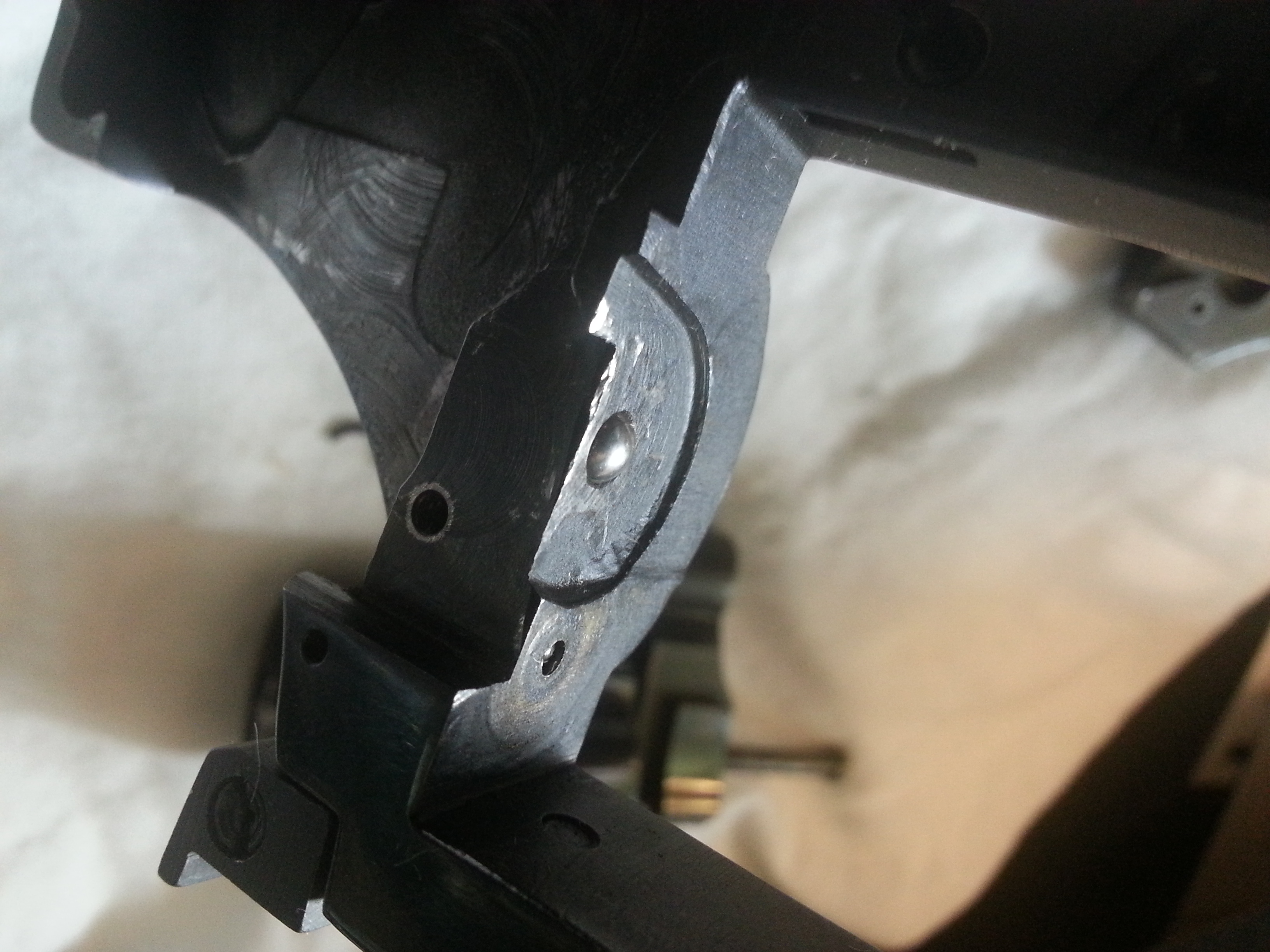

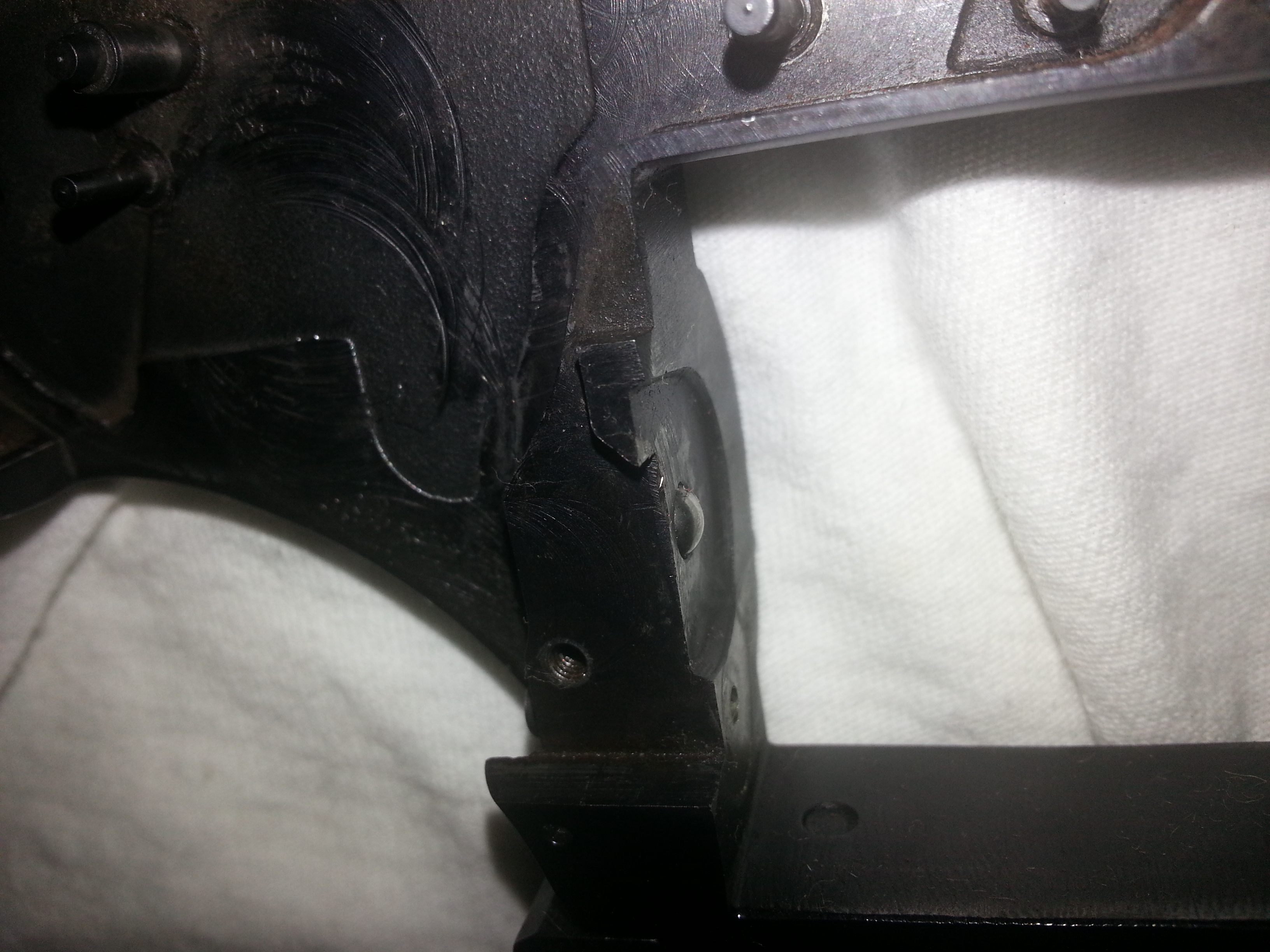

December 27, 2015 - 11:04 am
This doesn't look good!14512319321821951202360.jpgImage Enlarger
1451231976649-555489911.jpgImage Enlarger
There's a small burr...hard to see but looks like the cylinders been hitting it. ## After a very thorough cleaning and some fine buffing , i did find the ball screw was backed out just about a 1/4 turn. It seems to have helped with the cylinder being a bit lose too. I'll try to get in the woods in a few days when the monsoon is over and test fire it. Thanks for the info.
