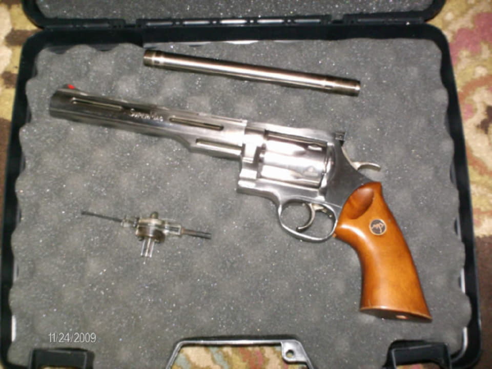

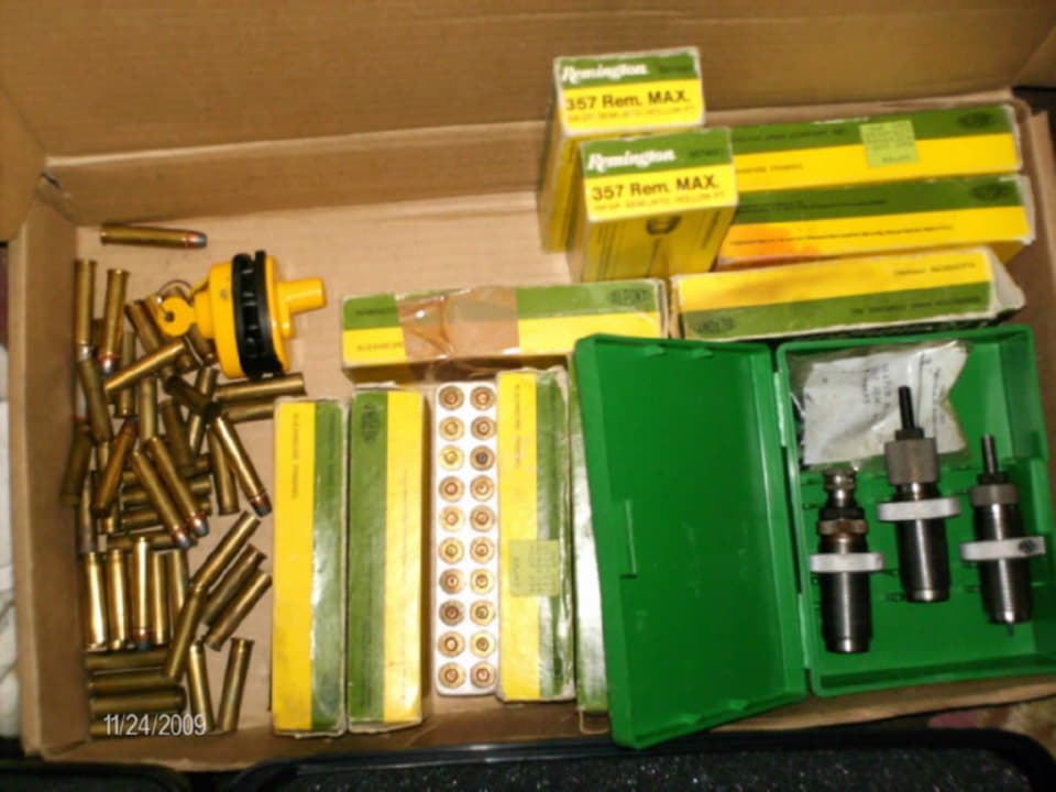

Here's picts of my new DW!  On top of everything you see here I got about 10 boxes of blank brass, the .357 Max reloading dies, a holster, and about 1/2 box of unshot ammo. You can see by the handle the 'DW' shields must have fell out at one time, because they were glued back upside down.  One more question, is it normal to be able to turn the cylinder to the left (counter clockwise looking down the barrel) with the hammer down?  I can't do that with my Ruger's, and was wondering about the benefit of that?
I'm still adjusting the gap, and I think I got it close...I did find one high spot and set the gap to that, and no problems!!  Anybody have the high spot machined down, or is it even worth it?

December 2, 2009 - 12:23 am
Are you pressing the trigger a little first to release the cylinder, or just grabbing the cylinder & turning? If you're simply turning it, that's not how they're supposed to behave & may need some fixing.
The grip medallions may not be glued in, they sometimes spin when shooting. Remove the grip & look inside, you should be able to see a small hole in the wood just behind the medallion. Get a stiff paperclip, bend a short 90º on the end & use that to press into the hole & pop the medallion out. Then reassemble, with a dab of glue.
Good looking gun, and the extras are a nice bonus.Smile
