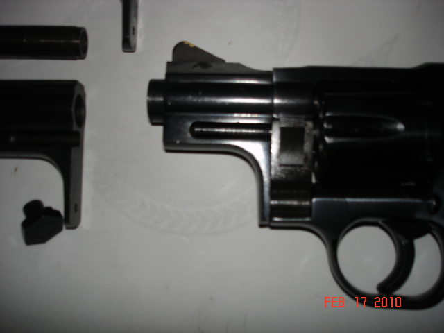

Well it took me some time to get it going ,,But here it is,,
Yes the barrel nut sticks out ,,not the problem..
The ejector rod is to long for the chanel.
shorten the rod?
or cut the channel a little longer?
Or find the correctr barrels?

*EDIT* Woops, I posted before I saw your ejector rod issue. That is odd & unexpected! I must admit that I haven't actually slipped a M12 shroud onto my M14, so I haven't run into that problem myself...I've merely compared them side by side. Wow, now I'm gonna have to dig the old boys out again & see if I've got the same problem!
This is the first I've heard of a longer ejector rod issue on a small frame gun, very interesting. Just in case...there's not a chance that your rod is merely loose, is there? Maybe unscrewed a few turns & that's why it's hitting?

I was going to mill out the channel in the shrouds to fit the rod ,
but I tend to procrastinateScrewy
If the M12 barrels are not worth that much I might just machine them to fit....

Uh oh... Another DW anomoly Screwy.... shroud ejector cutouts should be the same length...  are the shrouds marked 357?  Maybe a 38 spcl shroud?

All are marked .357
and the rod is tight,,,,,,
The channel on the 14 is about .065 longer than the 12 ..I think..will have to check again.

Here's a question... look at the back of the 12 shrouds.  Did someone machine off the back to square it up?  It wouldn't be the first shroud we've seen that went under the knife.

I'm no expert, but I think the ejector rod cutout problem may be may be due to the overall shroud length of a 12 shroud being less than for a 14. The barrel is the same lenghth, but the shroud is shorter to allow for the external nut. My guess from your info is that a change from the 11/12 to the 14/15 might have been a slightly longer ejector rod, and corresponding ejector rod cutout. I know that Charger (and his micrometer) will probably be able to confirm this.

they are true and blue
I can see that at the front of the channel is thicker on the 12's than on the 14
But that could just be the forging..

I just looked back at some old research, and one of the stated upgrades from the Model 14 to the Model 14-1 was an "improved extractor rod".

I think that improvement was the addition of a mushroom shaped tip on the end.
I still haven't measured my rods, I've been preoccupied with a bunch-o-stuff today...including a new DW.Laugh I'll have to get some good measurements tomorrow.
