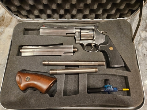

Hello DW forum members!  I am a new member to this forum and a first time DW firearm owner.  My apologies in advance for the lengthy post but I recently acquired a DW revolver model 744-VH in its original hard case (picture attached) and have a lot of questions about it.  It came with (2) sets of 8" and 6" barrels with one set being ported barrels and the other set not ported.  It also came with (2) barrel shrouds, wrench, and the (2) original wood and rubber grips.  Based on the research I have done to date, the only thing that seem to be missing from this set is the original barrel shim and the original owners manual.  Given that I am a first time DW revolver owner, I have a number of questions relating to this firearm that I am hoping the forum members can help answer for me.  These questions are as follows:
  1.   The gun was manufactured in Monson, MA per the stampings on the gun.  It is my understanding that this model could have been manufactured there sometime between 1968 and 1988.  The serial # is SB0104XX.  Can anyone tell me more specifically what the date of manufacture was for this firearm?
  2.   The hammer and trigger have a jeweled finish on the sides of them.  Was this typical for this model or would this be an indication that this firearm went through their custom shop or some other type of customization by someone else?  I know one thing, the double action on this revolver is silky smooth and it does not appear to have had a lot of rounds through it.
  3.   I am considering the idea of putting a picatinny rail or some other mounting system on this revolver so that I could put a scope on it for hunting and/or target shooting at distance.  There are no threaded holes or milled bases in the frame or shrouds for doing something like this so I was wondering of any forum member has done something like this for this specific model?  Did the mount go onto the top of the frame or onto the shroud?  Looking for some realistic and reliable options for putting a scope on this revolver that would work so any help on this would be appreciated.
  4. What would be the current fair market value for a revolver such as this including all of the components that came with it?  I have not been able to find a comparable value using sources such as Gunbroker.com so any value insight here would be appreciated.
   Thanks in advance for your assistance on these questions and I will look forward to participating and contributing to this forum going forward!

Welcome to the Forum. You can use a set of automotive feeler gauges instead of the shim. It actually is better because you can use a smaller size to fit your preference. The small frame Dans cylinder will expand when it gets hot and the face is not necessarily perpendicular. The factory recommends 6 hundredths gap on the proudest chamber. You should check each chamber. I use 4 hundredths. Less than that and the cylinder can bind when it heats up or gets dirty. Once you have a feel for the correct gap you can hold the gun up to the light and eyeball the gap as you rotate the cylinder. The gap for a 44 can be 2 thousandths of an inch.
  The 44 mag debuted in 1981. Your gun was probably made in 1982 or 1983. You have a 44 Magnum Pistol pack. Minus the yellow cloth that lined the foam. Probably came with patch and belt  buckle. The ported barrels were DWs worse idea IMHO. Called Powerports, the holes don't line up with holes in the Shroud and all that powder get deposited in the shroud. It has to be cleaned every trip to the range. If you use it you should use jacketed  bullets. Few folk use them. The jeweled hammer and trigger are definately aftermarket work.
   The factory recommends a D and T scope mount on the shroud because of recoil. Do not drill the top rail of the frame. It would greatly lower the value of the gun. If it is the shroud you can replace the shroud when you don't want to use the scope. Burris and Weigand make bases as do others. You will not be happy with a clamp on mount.
  Values today are all over the place but one thing is certain. They are going up quickly. It is not likely they will be made again. The 44 mag DW held virtually all the IHMSA records until Freedom Arms was allowed to compete.
  44 mag packs are uncommon. I would estimate  it is worth $1750 to 2250. Perhaps more.
    I hope I answered your questions.

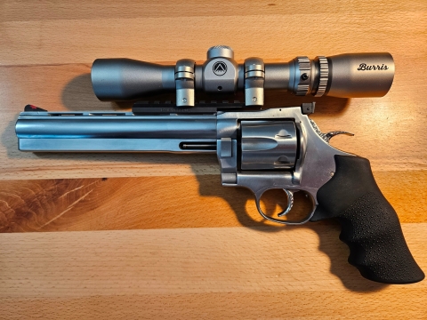

Many thanks to Ole Dog, Snake-eye, and Scout728 for the info and guidance you provided to me for my DW revolver.  I was able to purchase the proper pic rail for this revolver directly from CZ/DW and then had Hyatt Guns in Charlotte, NC drill and tap the shroud for mounting it per the machining instructions CZ/DW provided with the rail.  I then mounted a Burris 2x7-32mm scope on the rail using Burris Signature rings.  I thought I would pass along a picture of the finished product for you to see.  She is big and beautiful weighing in at a hefty 5lb 3oz (empty) but it turned out exactly the way I hoped it would.  Ready for the range and the load development process...Many thanks once again!
