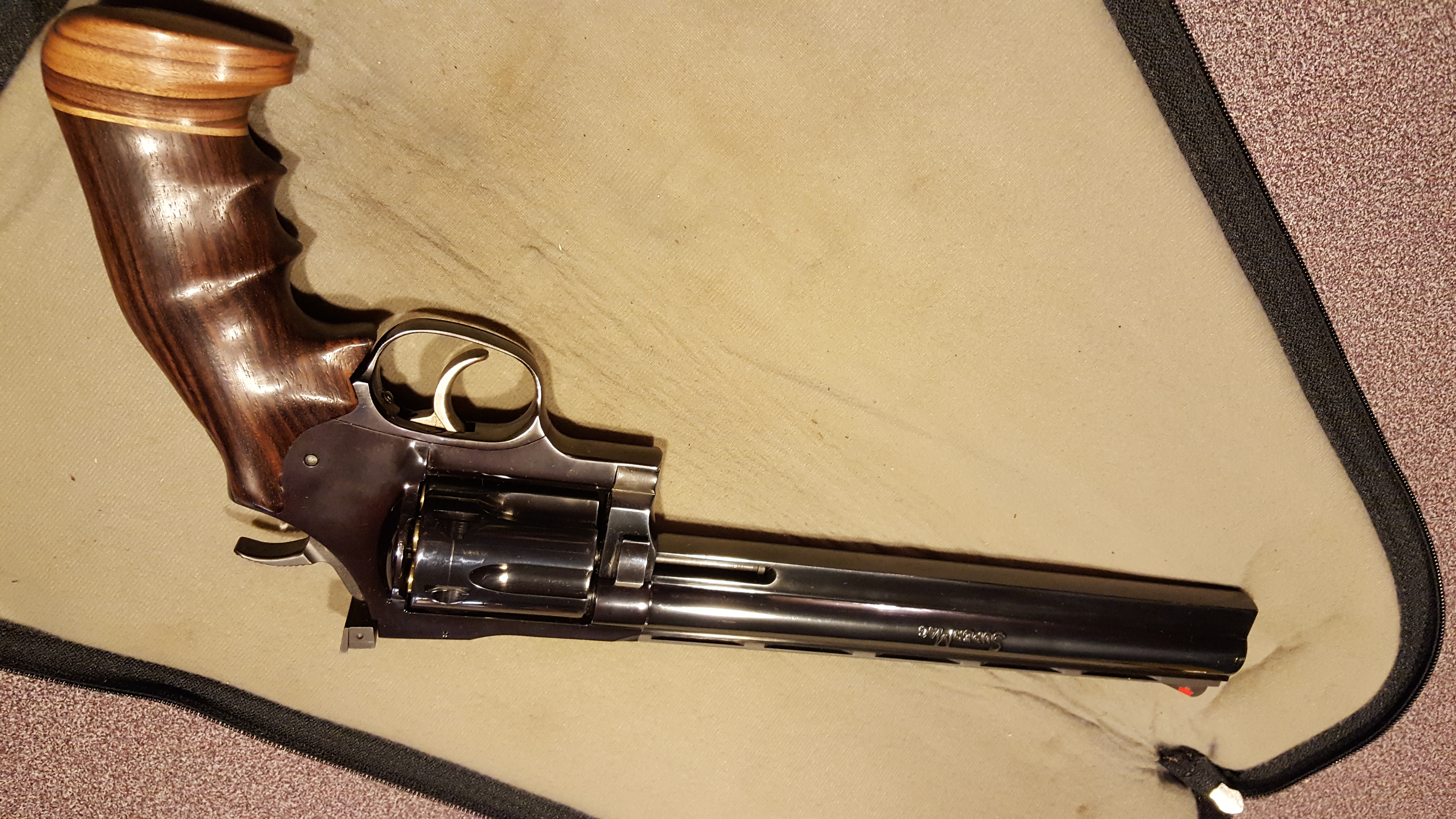

As requested, here's some pics. Not sure why there coming in upside down though, and seems no way to rotate them here, their correct on my desktop.
20160608_205732.jpgImage Enlarger
20160608_205826.jpgImage Enlarger
20160608_205746.jpgImage Enlarger

On the gun, I have a couple of small area's I am considering having the bluing touched up, not by me but by a gunsmith, anything special about the bluing on this gun to be aware of, or is it pretty straight forward as far as bluing's go?

Welcome from SC. Beautiful Baby!
June 9, 2016 - 10:12 pm
Nice grips on that SM!  drool
June 9, 2016 - 10:43 pm
Depends on what you want to have done. Looks like frame is a little "barney colored", a common DW look, matching can be a challenge.
That is a COOL grip !!drool
