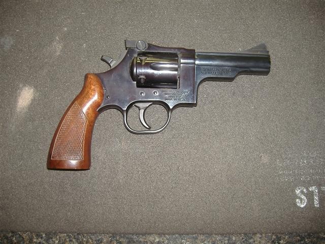

Everyone thinks their's is the rarest/coolest, whatever.  THAT's what keeps me coming back for more guns.  I love learning about them, so my next purchase is more knowledgable.  I have not been able to find pics of any gun like mine.  It IS a Pork Chop SN 98xx.  It was made in Monson, and has the recessed barrel nut.  On the right side of the frame (usual place for DWs) it has 4 lines: 1)DAN WESSON ARMS  2)MONSON, MASS.  3)MODEL 15  4)MADE IN U.S.A.  The barrel has the normal stamp; DAN WESSON ARMS  357 MAGNUM CTG.  The only similar guns I have seen have the SN on the right side of the frame, and only 3 lines.  I have also read something about the actions in the earlier guns, and their hammer is different, but I have not found a thread that addresses it to any extent (nor pictures).  I will post my pics when I am happy with the results (yes I did read the "tips for good pics")  I have a feeling this is not going to be my only DW.  I am already looking for a longer PC barrel, and wood grips.  Mine is 4" and has Pachy grips.   Has anyone seen this setup on that early SN?

found this one on GB.
The earlies were strange like, I have a couple missing the serial numbers you discribe.  Now where is the number located grip tang or crane?  longest you can get for this one is a 6" , you will need a 2" also.  if you are needing any tools for it look to the right EWK has what you need. wood grips LB on side has customs, or check Gunbrokerdot com.
The style of roll mark you're describing was used just before they moved the s/n to the outside of the frame. Your gun should look like this...
The s/n should be stamped on the frame under the crane like this...
I haven't yet seen a 5-digit s/n stamped under the crane, so I think it's very likely that the number moved in plain view (on the right of the frame) with the first 5-digit numbers. I keep looking for an answer to that question...one day I'll find it.Wink
The action design in the earlier Porkchops was a bit different than the later guns. The hammer was slightly different & the cylinder stop bolt will drop away from the cylinder with the slightest trigger movement, very early in the range of motion when firing a round. You can actually spin the cylinder by hand at this point.
The later actions were such that the bolt didn't drop away until the hammer started moving, as the trigger is pulled. This is in double action, of course.

Charger fan is correct. Mine is just like his pics.  Also I forgot to mention that it has the small ejector rod (non mushroom), but you guys probably knew that.  I will update the SN database now that I know it is a 15 and not a 15-1.  I really like this gun.  The cylinder lock seems to just make more sense at the business end of the cylinder, where the aliignment is most crucial.
