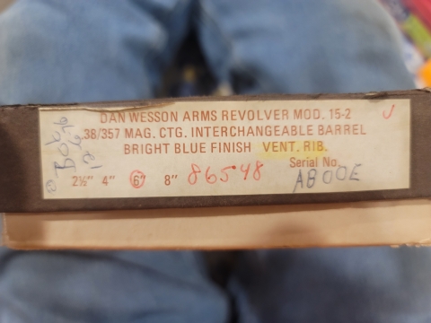

I got this one off of Gun Broker ad said new old stock. But I am sure it was previously owned. Has all the paper work but no Box. Got 550.00 in it looks like very little use.

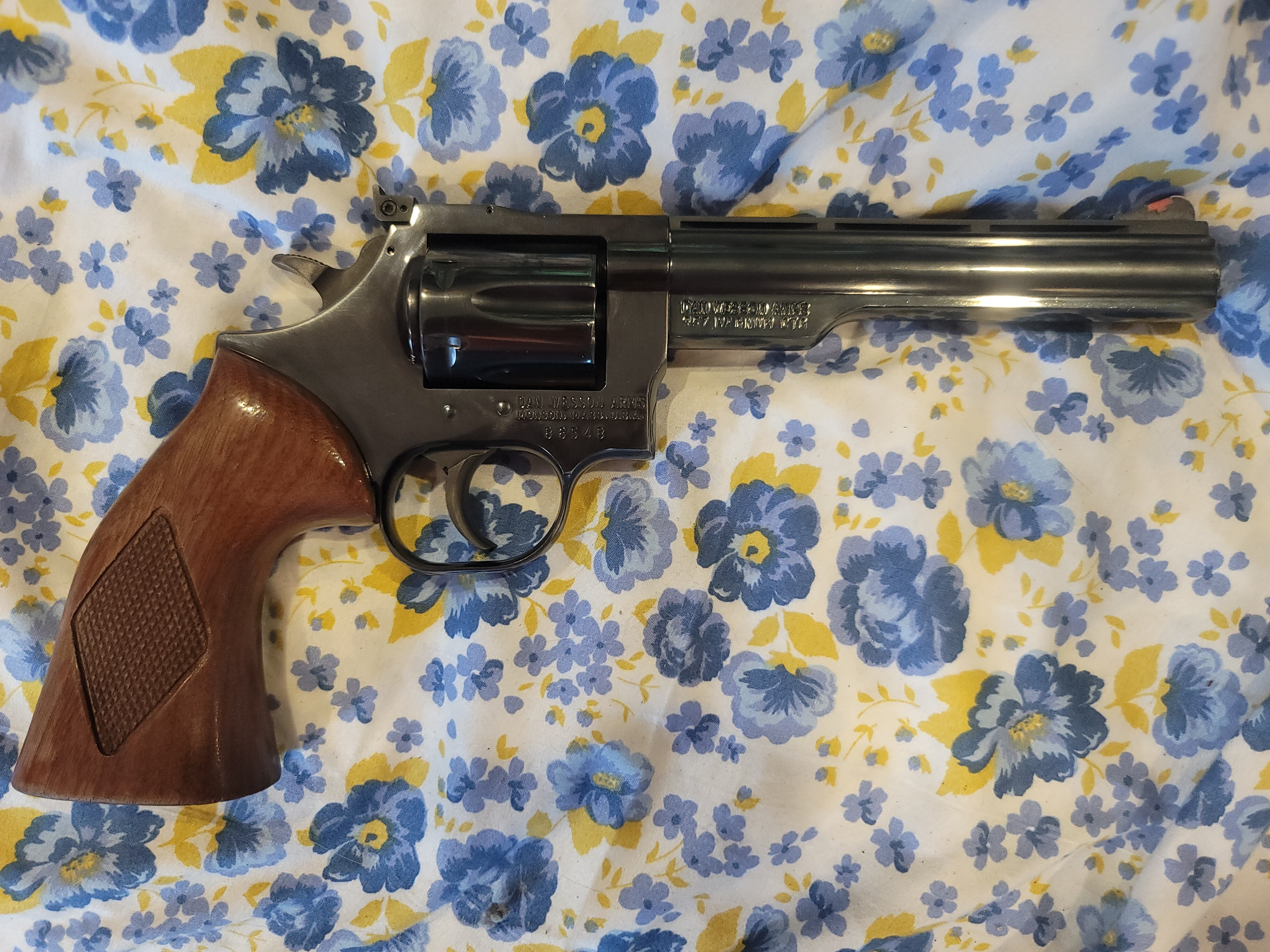

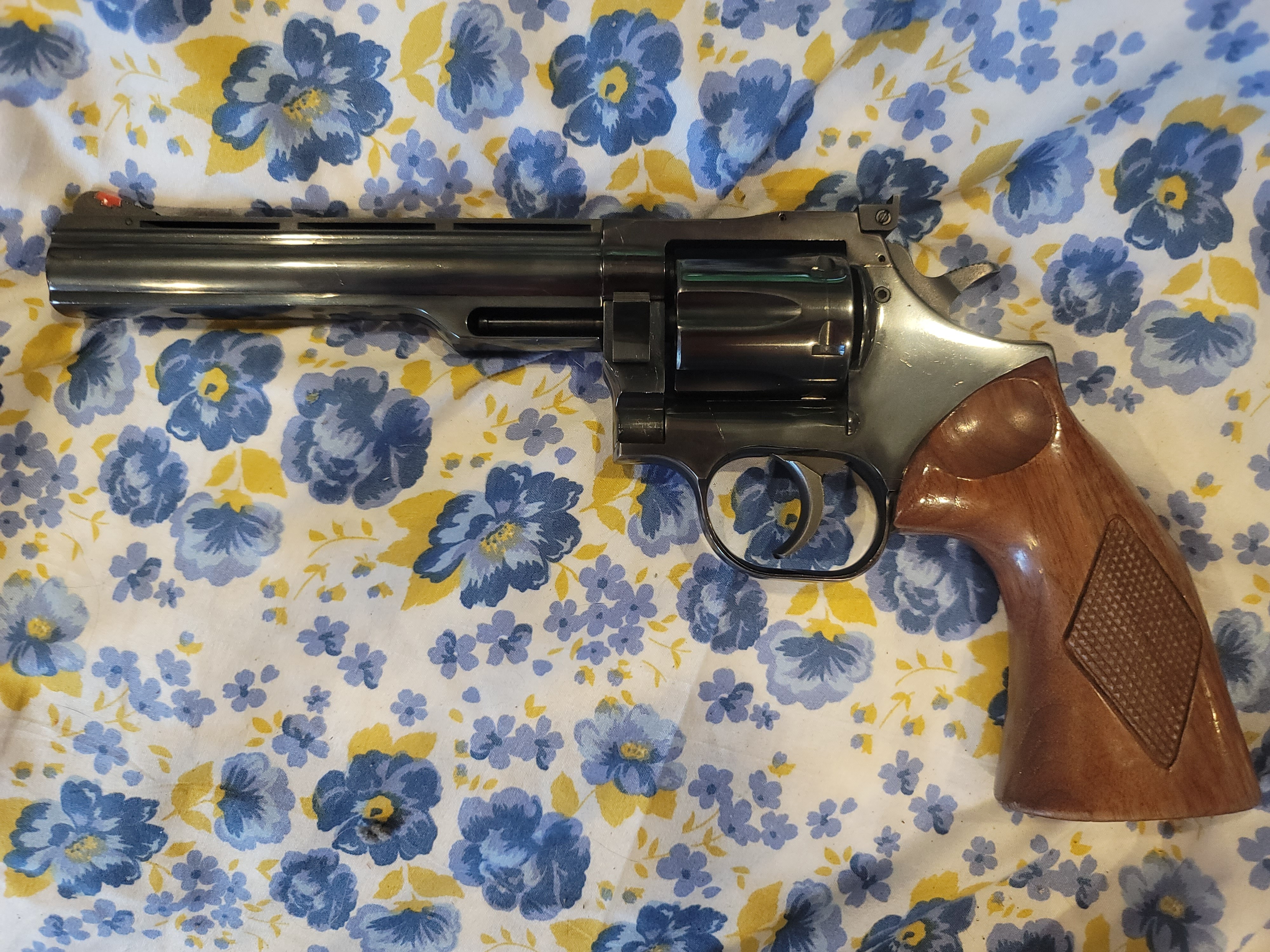

357.jpgImage Enlarger
357a.jpgImage Enlarger

Also got paperwork with it. Small booklet for instructions and original price list and flyer. Now I just need to go fire it and see how it shoots. Trigger feels real good, nice and crisp. Seems to be a little hard to open cylinder for some reason. Any ideas on how to fix that? Located in Frankfort, KY.

Holding the gun in your right hand, use your left thumb to push the latch while you push against the cylinder with your index and middle fingers. When ejecting cases keep those two fingers pushing the cylinder open while you use your thumb on the ejector rod. Tilt the gun to the left while doing that. Failure to use proper procedure will enable the cylinder to close while the extractor star is extended and the star will scratch the sideplate. There is no latch on the sideplate to protect it like a Smith or Colt. Almost all Dans have those nasty scratches usually put on the gun the first time it is used by new owners. Also do not pound the ejector rod when cases are stuck. It can break the cylinder stop behind the cylinder off or bend the ejector rod. Keep a pencil with eraser, unsharpened, in your range bag to poke stuck cases out. That defect was corrected in blue guns made after 1986 and all stainless guns.

First; let me congratulate you on making one of the Best Buy’s I’ve seen in quite awhile. Second; your revolver appears to be very little used and in magnificent original condition and (at least in my view) is from one of the most desirable eras in DW history. You can try a multitude of aftermarket grips if you like, but IMHO you’ll never be happier than using what you now have. I own two early DW’s that are much more problematic in design, so be grateful that all of the later refinements are already present in your revolver. Be confident that you can shoot this gun for the rest of your life with no difficulties whatsoever. Looking forward to that range report!

I found it surprisingly hard to open the cylinder on my Dan Wesson when I first got it.  Not like it took a lot of strength or anything, but just compared to my experience opening Smiths or Rugers, this one took quite a bit more pressure.  The reason for this was the ball detent that holds the cylinder in place on the rear of the frame opening.  I've backed off the screw that holds it in place and the cylinder opens much more normally now.  However, it also seems to be the case that backing off the ball detent too much can cause light strikes, so be aware.
Possibly, if your ejector rod is binding, then your problem is something else, like maybe a bent ejector rod or whatever.

The latch on the crane may have some gunk in it clean it out and oil it. May be dried oil in it. Also, push the latch down and push with the two fingers AT THE SAME TIME. Lol. Takes a little practice.

Welcome, great choice for a first revolver and for finding the best place on the internet for DW owners. Get a barrel wrench if you don't have one and a set of automotive feeler gauges for setting the B/C(BARREL-CYLINDER) gap. Your revolver was probably sold with a .006 gauge to set the gap. The end of the barrel may be rubbing on the cylinder face and binding. My first DW revolver had no B/C gap when I tried to measure it prior to purchasing it. I got my barrel wrench from EWK. This could cause your cylinder release problem and even if it isn't you need a wrench anyway. As a new DW revolver owner I recommend you read everything on these forums to learn how to work on your gun. DWs are probably the easiest revolvers to work on if you know how. The "know how" is here for you. Good luck and enjoy!

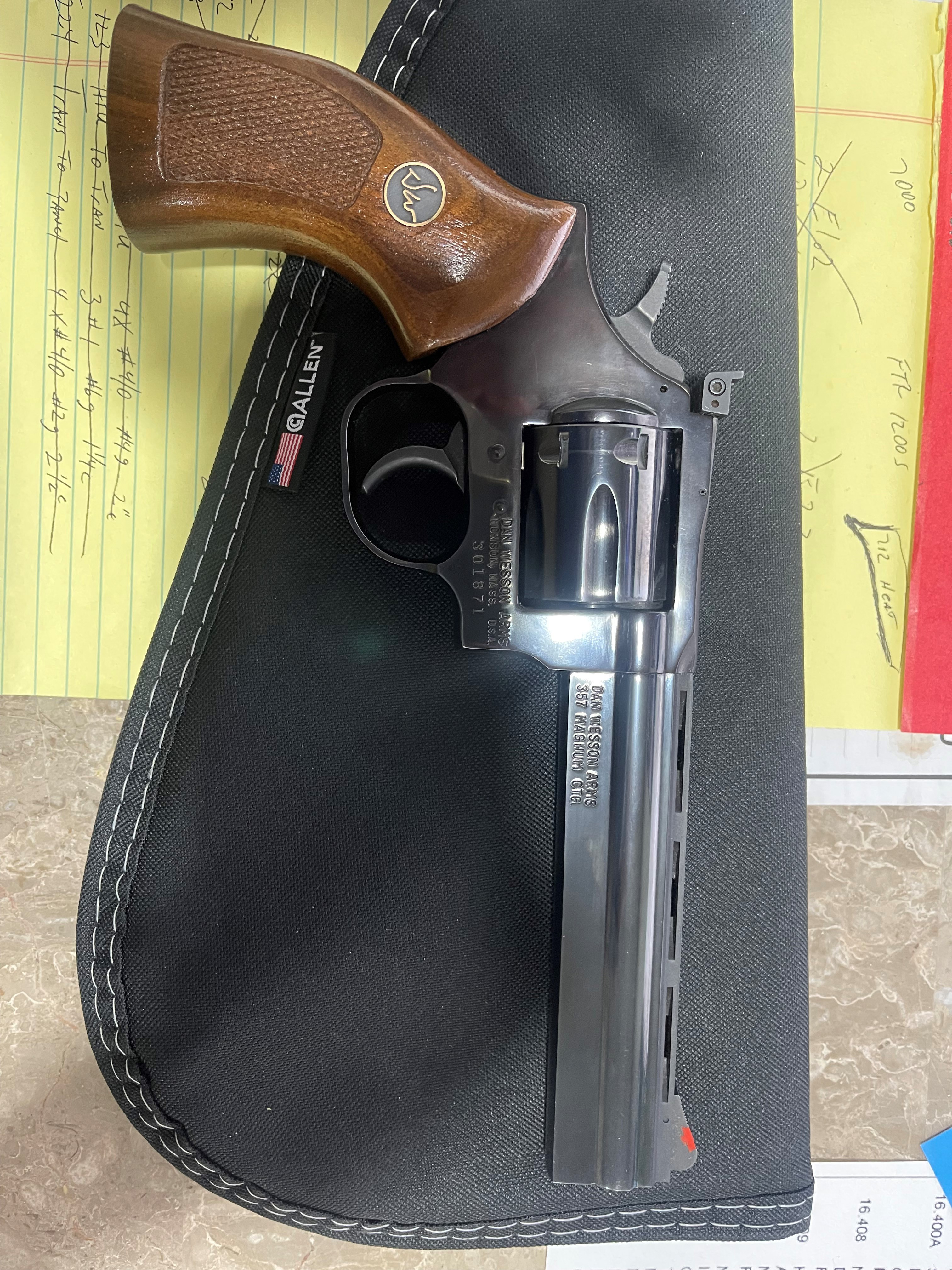

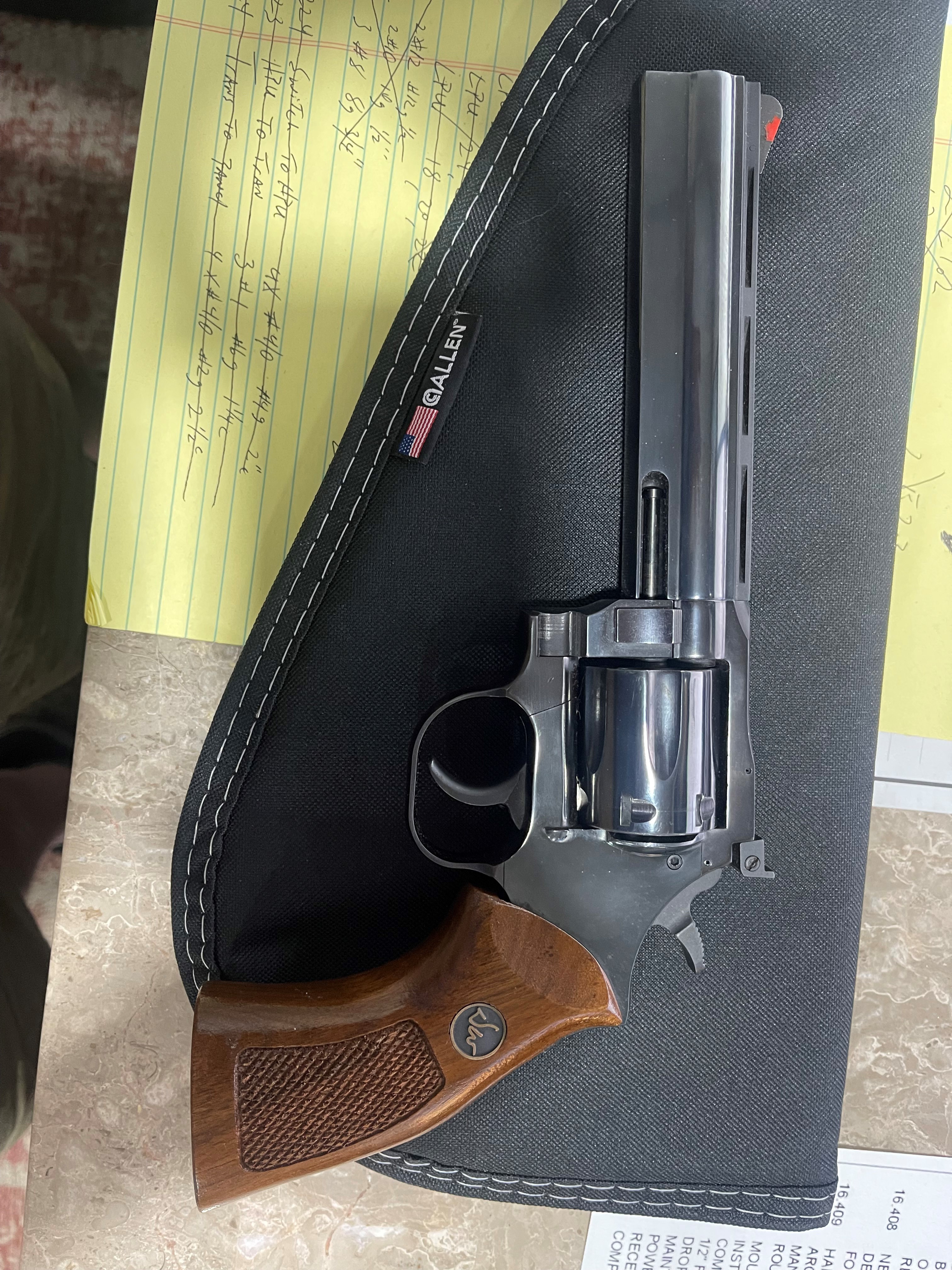

Just got my first dan wesson yesterday! Super excited to shoot it as soon as i find some ammo

20220531_204852.jpgImage Enlarger
20220531_180501.jpgImage Enlarger
20220531_180455.jpgImage Enlarger
