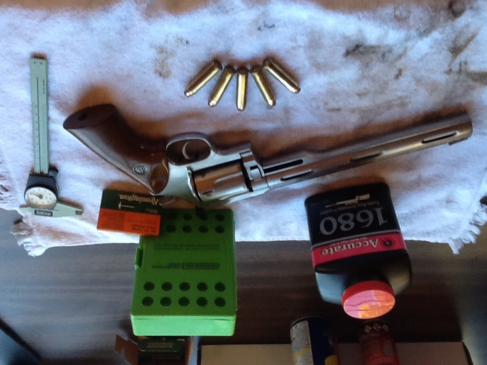

Ok, problem,  loaded a batch of 5 with 36.1 grains of 1680 over Remington 2.5 larger primers.  No powder ignition?  I don't remember having this problem 20 years ago?  I don't remember using mag primers back then and I see all the reloading data I can find recommends Federal 155 primers?  What am I doing wrong?  I also believe I used Unique powder way back then with good results but I can't find my old load data?  Help!!

The primers ignited fine, i just tried 2 rounds with a bullet lodged in the barrel each time.  Flash holes are clean, possibly old primers?  I'll buy some magnum when I can find them.  image.jpgImage Enlarger
February 8, 2013 - 4:12 pm
Are you saying that you got a clean primer strike and it fired, but the bullet lodged in the barrel? Was it a full bore Supermag type ignition, or maybe a bad powder ignition? Maybe bad/old powder?
February 8, 2013 - 7:30 pm
Thats where I was going too SteveCT.  Sounds to me like the main powder charge didn't ignite.  I'm guessing bad powder, damp, old, etc.  36.1gn of 1680 should have roared like a cannon, not been a squib load.
Kirkturner, if it were me, I'd see if I could light a small sample of that powder in a metal coffe can lid or something.  I'm betting the powder is bad.  Even if its getting partial ignition, it should do more than lodge a bullet in the barrel.  I had a 44 mag that had no powder in it, only the primer, and just the primer managed to put the bullet six inches down the barrel.
Let us know what you find.
kirkturner
Forum Posts: 4
February 6, 2013
February 8, 2013 - 8:21 pm
I thought about that but the powder arrived from Cabellas 3 days ago so I'm assuming its good?  I'll try the light it on fire test tomorrow.  I did manage to score some Federal 155's that I also plan to try tomorrow after I tamp the last bad round out of the barrel! I admit to total disappointment with the pop and no boom.  I promptly loaded up another firearm and did some stress relief bowling pin work!  🙂
February 10, 2013 - 12:30 pm
I don't have any experience with the powder you're using, so I can't offer an opinion. I load my 445's with 29gr IMR4227, CCI 350 primers & 300gr Speer FP bullets. They all go boom like they should!range-time laugh
February 10, 2013 - 2:16 pm
Sometimes, if folks are using a progressive and aren't checking carefully -no powder, or very little, drops.  Don't ask me how I know but suffice to say I now use a Forster Co-axial press....  I'd pull the bullets and weigh the charge to be sure something like that hasn't happened.
