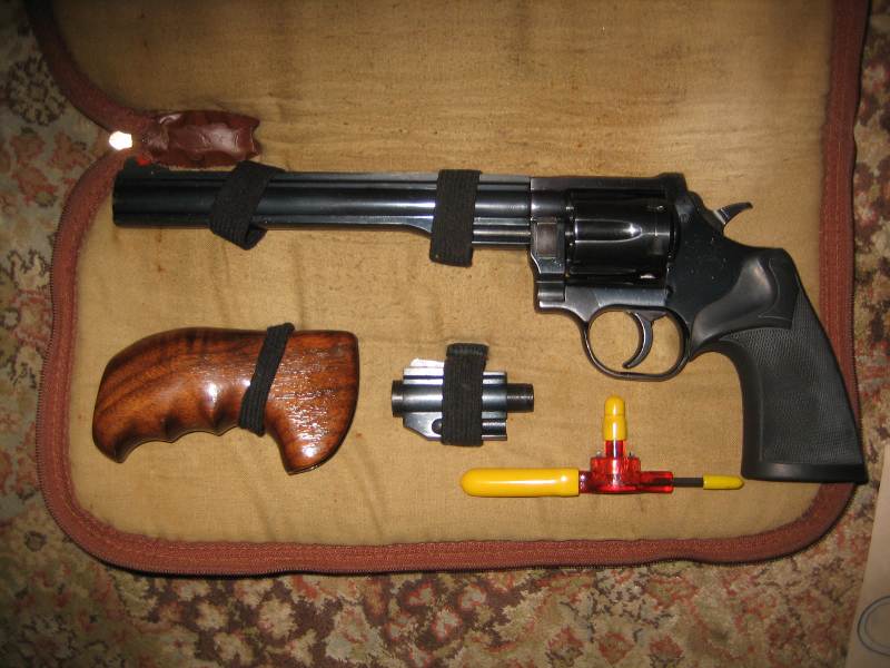

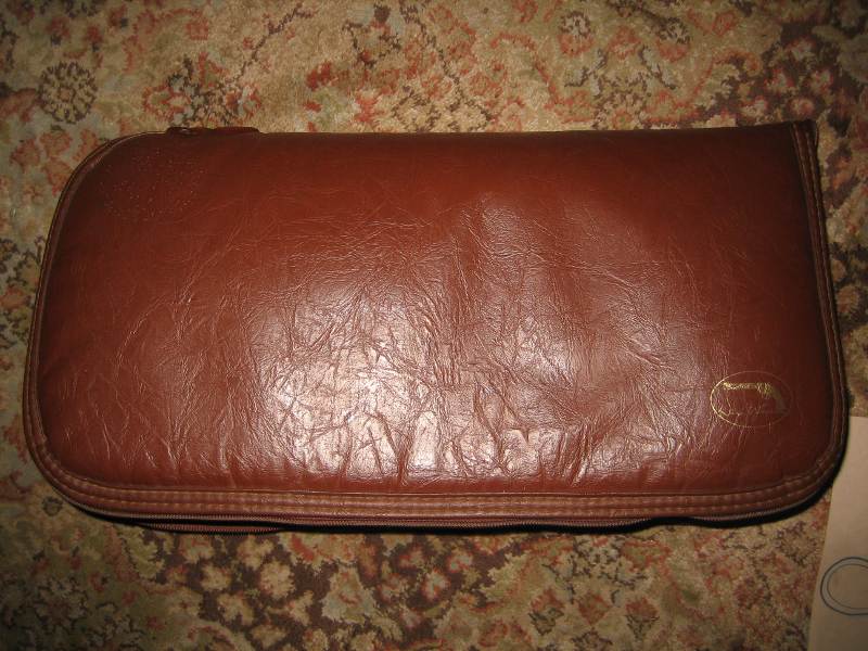

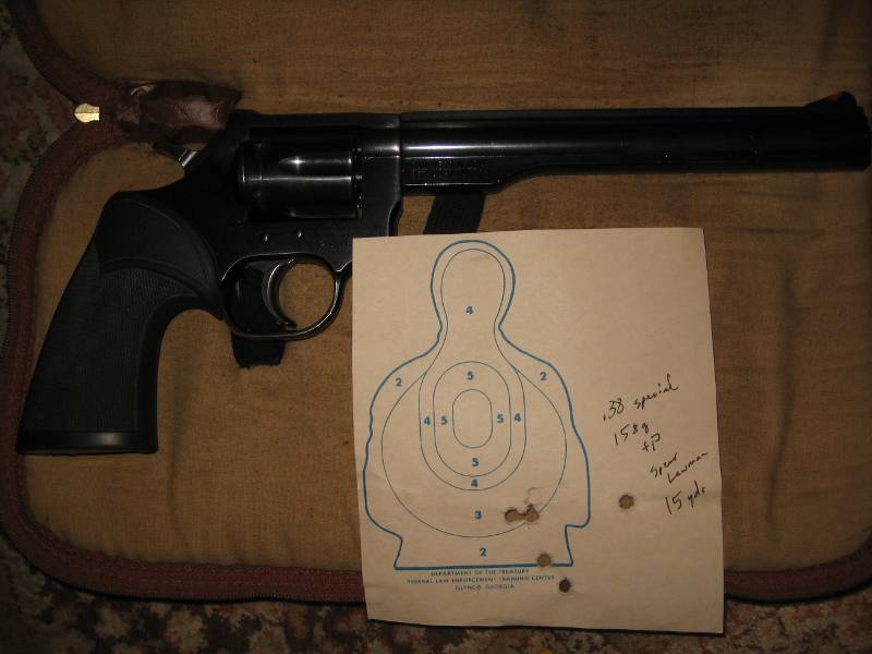

I just joined the Dan Wesson club.  I think I got a GTDW from a local pawn shop.  I walked away with a 14-2 with an 8" and 2 1/2" standard barrels and shrouds, DW target and Pachmyr grips, and the multi-tool encased in a brown leatherish pistol rug with the DW logo in gold on the front right cover.  It looks like it was shot little but does have some holster wear on the 8" shroud.  The 2 1/2" barrel looks like it was never used.  I paid $350.  This 14-2 was made at the Monson plant.  Shoots great!  So far have only shot it with the 8" barrel, which seems to be sighted in for 158 gr .38 spl +P.  Did they come like this from the factory?  At 25 yds, the 357 loads printed about a foot and a half low.  Anyways, got to get to the range soon and do some more shooting.  When I get some pics made up I will post, along with serial # info.

   If you have a 14-2, which is a fixed rear sight model, it's possible your 8" barrel is for a 15-2, an adjustable sight model. The front sight would be higher on a barrel for a 15-2, making the gun shoot low. Just a thought. I have not seen an 8" barrrel yet for a fixed-sight Dan, but a lot of other guys here know lots more about them than I do.

BTW, it sounds like your gun probably came in a DW soft case like this. That alone is usually worth $90+ so again...way to go!!

Looking at the barrel shrouds from link in Charger Fan post, I definitely have a 15-2 standard barrel shroud.  Do they make front sight inserts short enough to allow me to regulate POA with 357 and this barrel shroud?

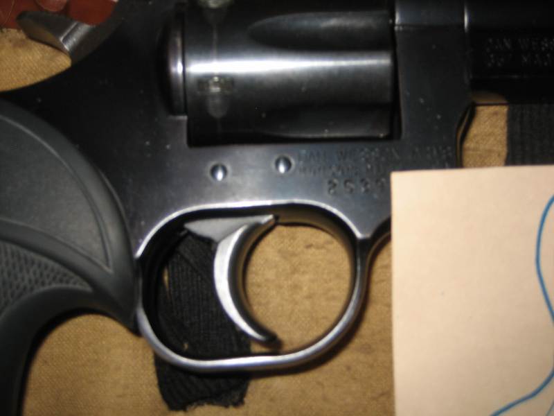

The serial # on my DW 14-2 Monson is 2589xx, does anyone know an approximate date of production?

Here's Joe's photos.  Enjoy!
February 2, 2011 - 11:45 pm
Great looking DW.Smile And easily worth your purchase price, way to go!GTDW
As Steve said, you should be able to get an EWK front sight & get it hitting a lot closer to POA.
