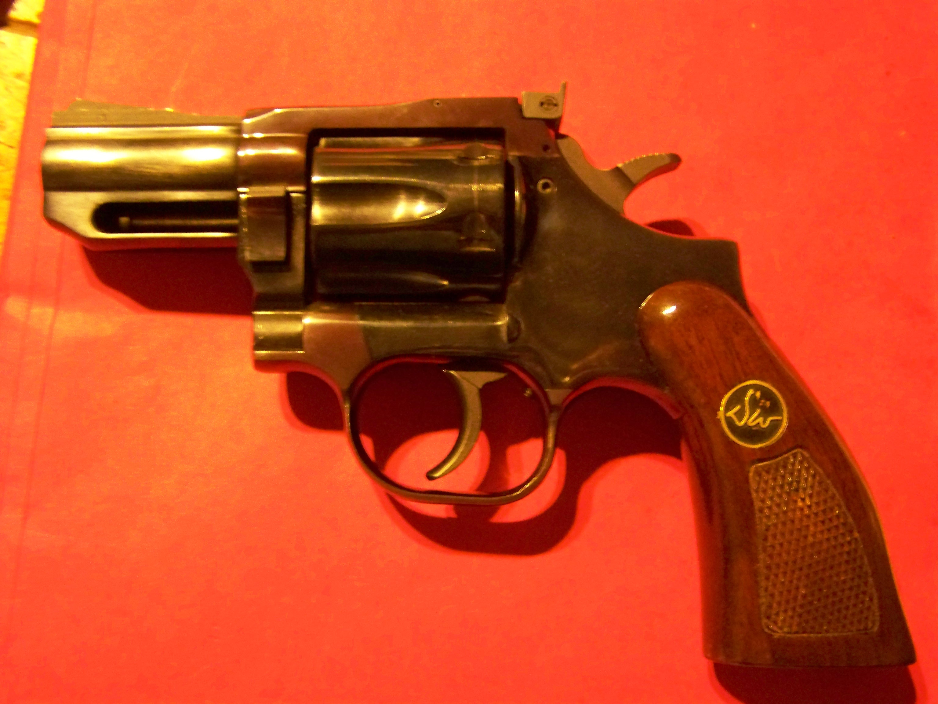

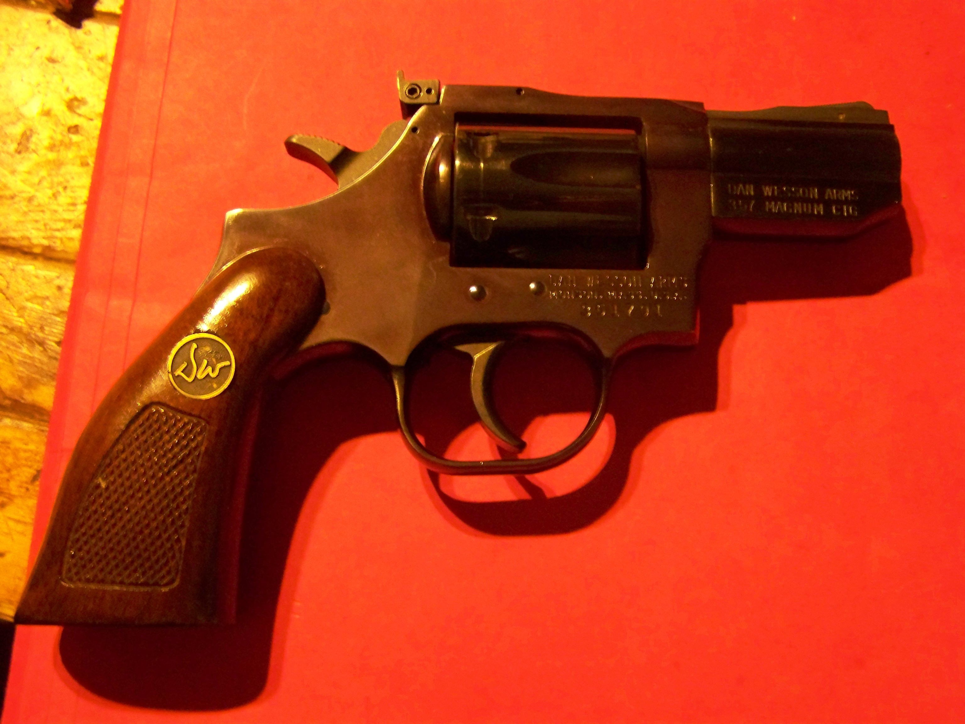

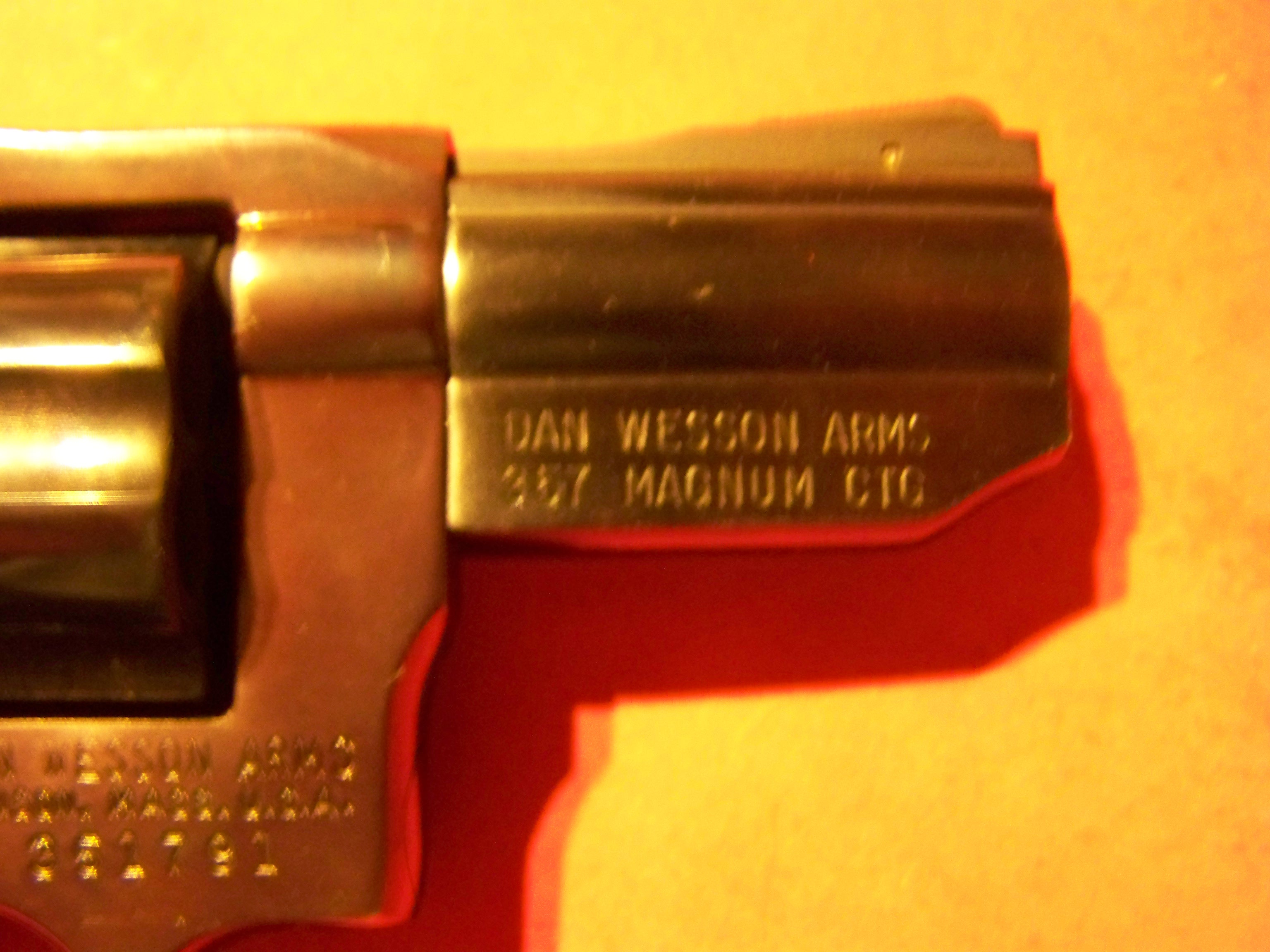

Hello,
I am a new Dan Wesson owner. It is a 357 magnum with a 2 1/2 barrel. It is a nice looking pistol with adjustable sights. However I did not get any manual or barrel wrench. I was needing some information on what model it is. I took it out to shoot it this afternoon and I was hitting the target about 4 inches high I had to turn the sight all the way down to the frame and I am still hitting high at 7 yrds... Now I was wondering on my Smith&Wesson If I am hitting high I can raise the back sight up to lower point of impact. But on this one I have to lower the rear sight to get close to where I am aiming but the point of impact is still higher than my aim point. Any suggestions ? I can provide serial number if needed.. It appears to be a older model cause the front sight has a push pin on side under front sight not the front of barrel. Thanks

101_4028-1.JPGImage Enlarger
101_4029-1.JPGImage Enlarger
101_4030-1.JPGImage Enlarger

The problem is very clear, you have a 14-2 (fixed rear sight) Barrel Assembly on a 15-2, definitely not the Factory Original. The easiest resolution for this is to purchase a 15-2 B/A (with the interchangeable front sight) and sell the 14-2 B/A. You are very likely never going to resolve your POA/POI issue any other way.

It has a adjustable rear sight.... but a small front sight I had a Dan Wesson before this one with the 4 barrel package .... Traded it for a AR 15 and ran across this one here... it is the same size frame as the model 15-2 I had ... but this one has a smaller grip and smaller front sight... Also there is a difference I notice the 15-2 had a screw at front of barrel to change the sight post.. This one pictured has a pin on the side of sight... thanks for reply

Yep - you have a mod. 14 barrel/shroud on there.  I agreed with the previous recommendation.....sell the barrel assy. and buy a correct mod. 15-2 barrel assy.

One more possible option Jeff...
Send that shroud to Eric at EWK and have him drill out the pin and either have a taller
front site installed or have the shroud converted so it can use the modern changeable sites.
