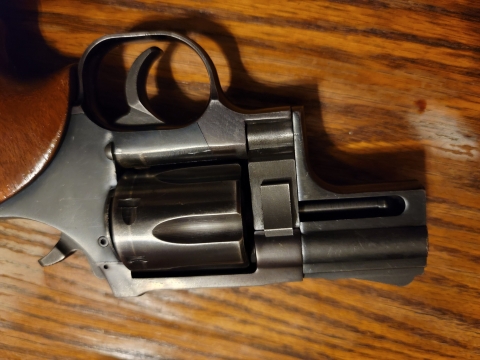

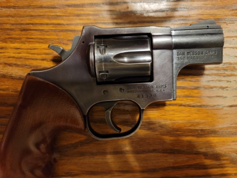

New DW owner here, I just bought my first DW yesterday at a show and I've been trying to figure out what model it is and really just learn everything I can about it. I took it to a friend's house after the show to test fire it and I have to say I'm in love with it already. From all the helpful info on here I believe what I have is a model 14, but I figured I'd get an opinion from someone who knows these guns better than myself. It's a 357 with a 2 1/2" porkchop barrel shroud, made in Monson, S/N 41320. I'll attach some pics, any help would be greatly appreciated. Thanks!20210627_064046.jpgImage Enlarger

Welcome, you have a model 14-1 that was most likely made in 1974. I have one of similar vintage with 4 and 6inch bbls. I love it, great shooter, very accurate. Enjoy!

How did you come to that conclusion, with only that one side of the revolver shown? The serial number registry lists a 3727x S/N Model 14 in 1974, but nothing for a 14-1.

Here's some pics of the other side, thanks everyone for the info and the welcome to the forums.20210627_222713.jpgImage Enlarger
20210627_222707.jpgImage Enlarger

Thanks for the pics Tim. I do observe the new style cylinder latch and ejector rod, so it is indeed a Model 14-1.

Conclusion based on rear sight, lower front sight, and hammer. All of which I learned about here when I got mine a few years ago. Also, I have a lower serial # than this one (still 40,000) and mine is without doubt a 14-1.

You all are very knowledgeable. I have but a little to add. The model 14 became the 14-1 (unofficially) around ser. nu. 25,000. The latch was improved as Stinger mentioned and the rear sight became a cut in the frame. The 14s and 15s have a 1/4" missing from the barrel. Yours is only 21/4".
    The model 14 was introduced in 1971. The 14-1 was made shortly after, probably in 1972. The registry is only approximate based on sales receipt, letter, etc. It is not when they were made or even shipped. In fact, the restyled and gorgeous 15-2 was made starting in 1974. I have long suspected that Dan Wesson sold the remaining inventory of porkchops to High Standard  in order to facilitate the roll out of the  -2s. The Sentinels Mark II and III were introduced in 1974. They cataloged the 3 barrel lengths but I guess Dan Wesson never sold them any. That is why HS roll marked BAs  are extremely rare.
   The missing 1/4" of barrel was restored on the  -2s.  I am sure most of the members already knew all this. dwf-welcomeand bewaredwas
