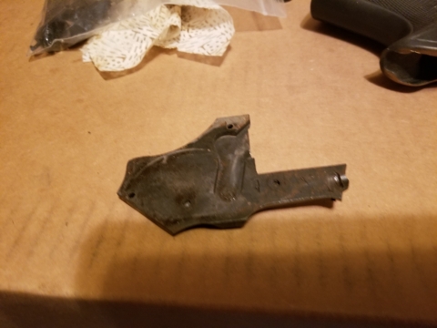

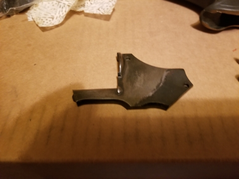

You need this right? This is from a 357 but they are both small frame and I'm assuming someone more knowledgeable from this forum could verify if it would work or not.20180331_211305.jpgImage Enlarger
20180331_211257.jpgImage Enlarger
