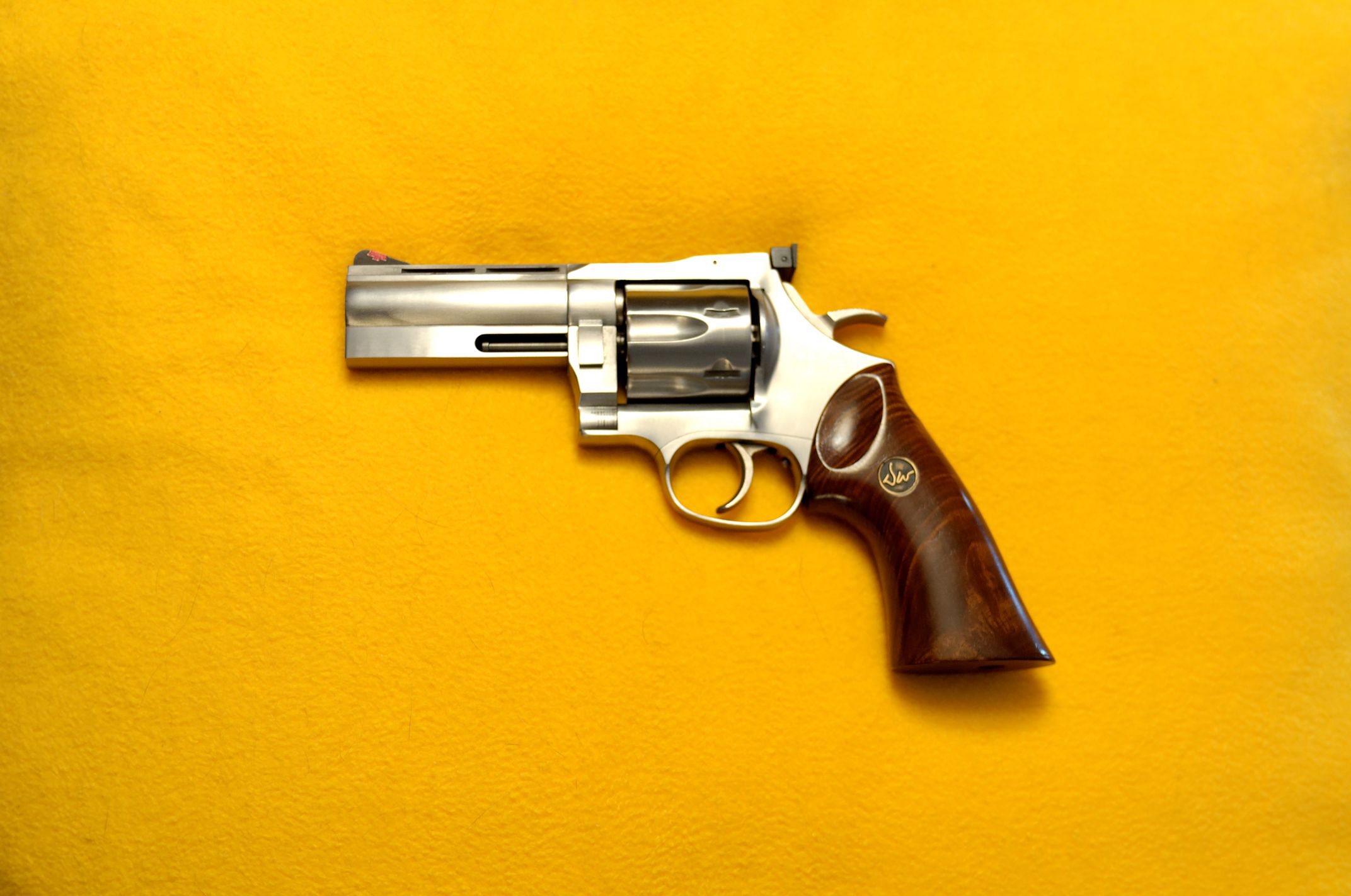

All Monson .44 barrel assemblies came with "ported" shrouds for 4", 6", and 8". The 10" shrouds were never ported. There were no 2-1/2 inch BA's for the .44.
The customer then had the choice of either a ported barrel or a non-ported barrel or both. I have completed my PP with both ported and non-ported barrels in 4", 6", and 8".
I tried shooting the ported 6" barrel and found no noticeable difference except that it then became nearly impossible to clean up the mess inside the shroud.  A 12ga. bronze barrel brush works if you haven't shot too many rounds since the last cleaning. Never , ever  shoot lead bullets through the ported barrels unless your purpose is to weld the barrel to the shroud permanently.
