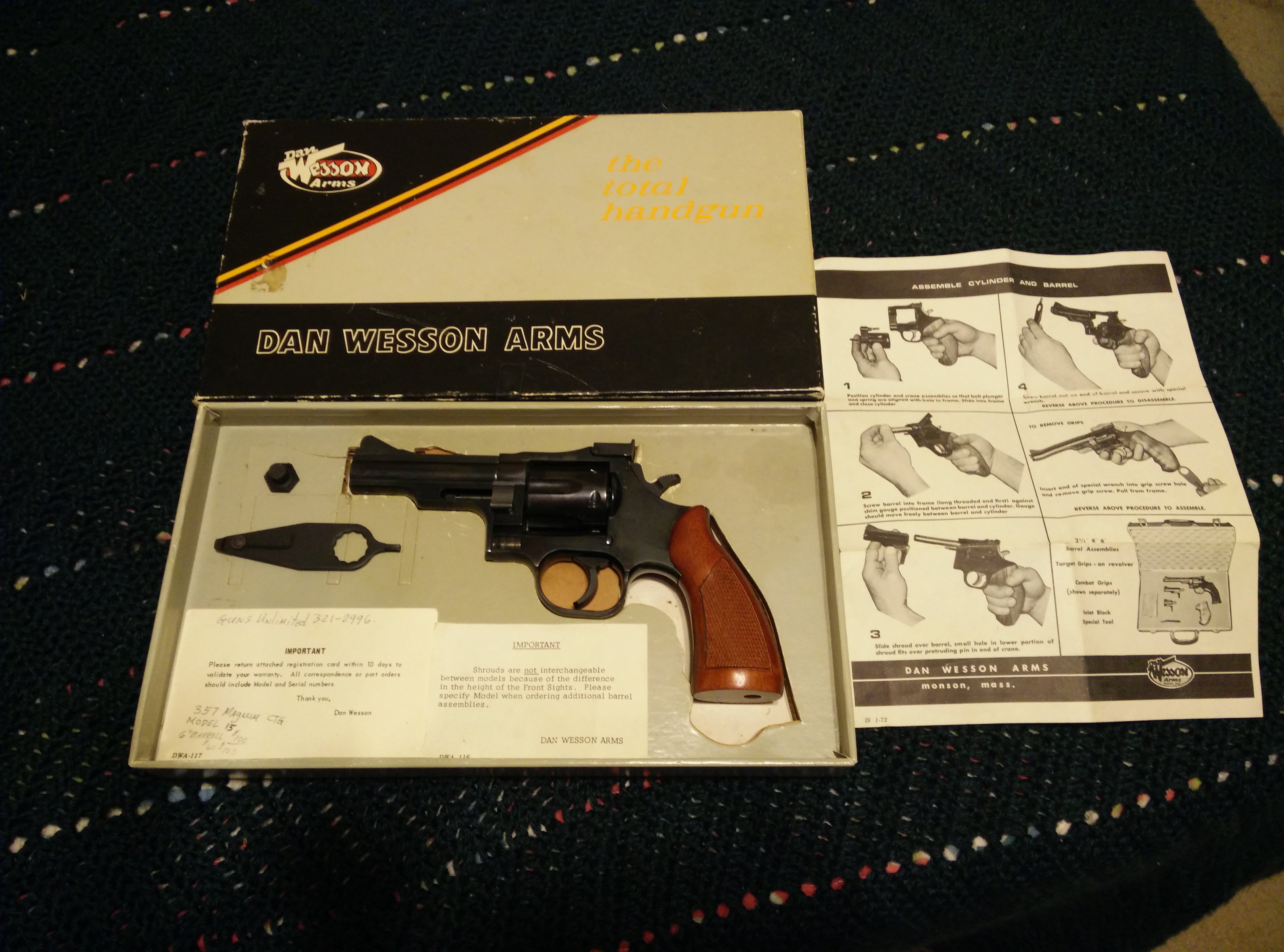

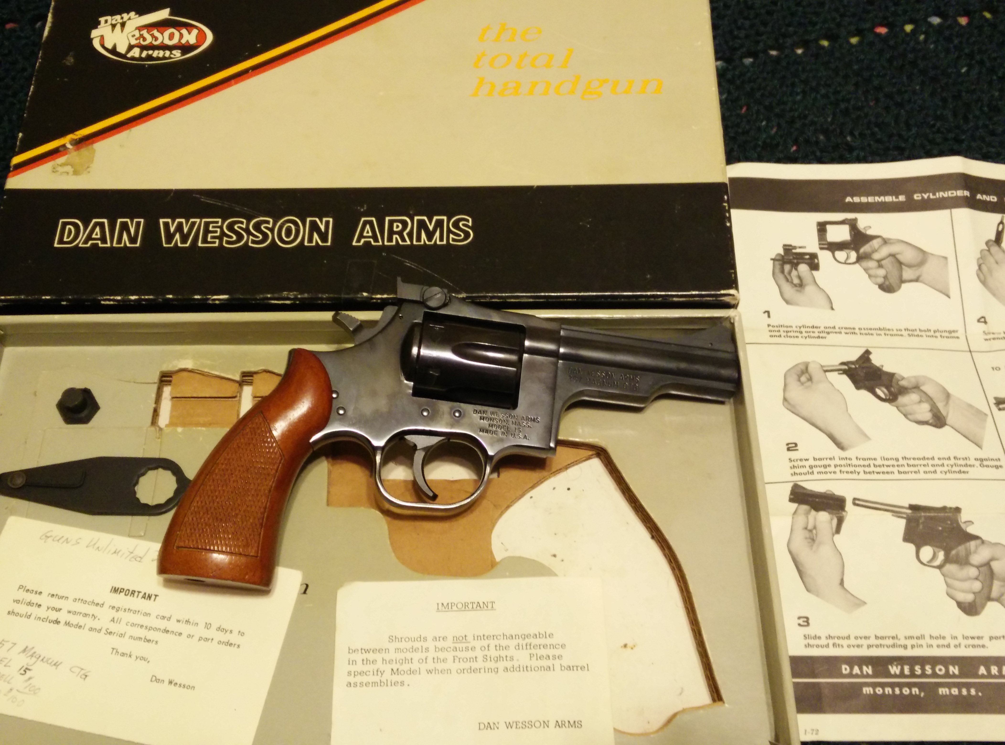

Hoping this works, just wanted to introduce myself and share some pictures of my Dan and Wesson model 15 then I'll let you guys know a little about myself and what I know about the gun.

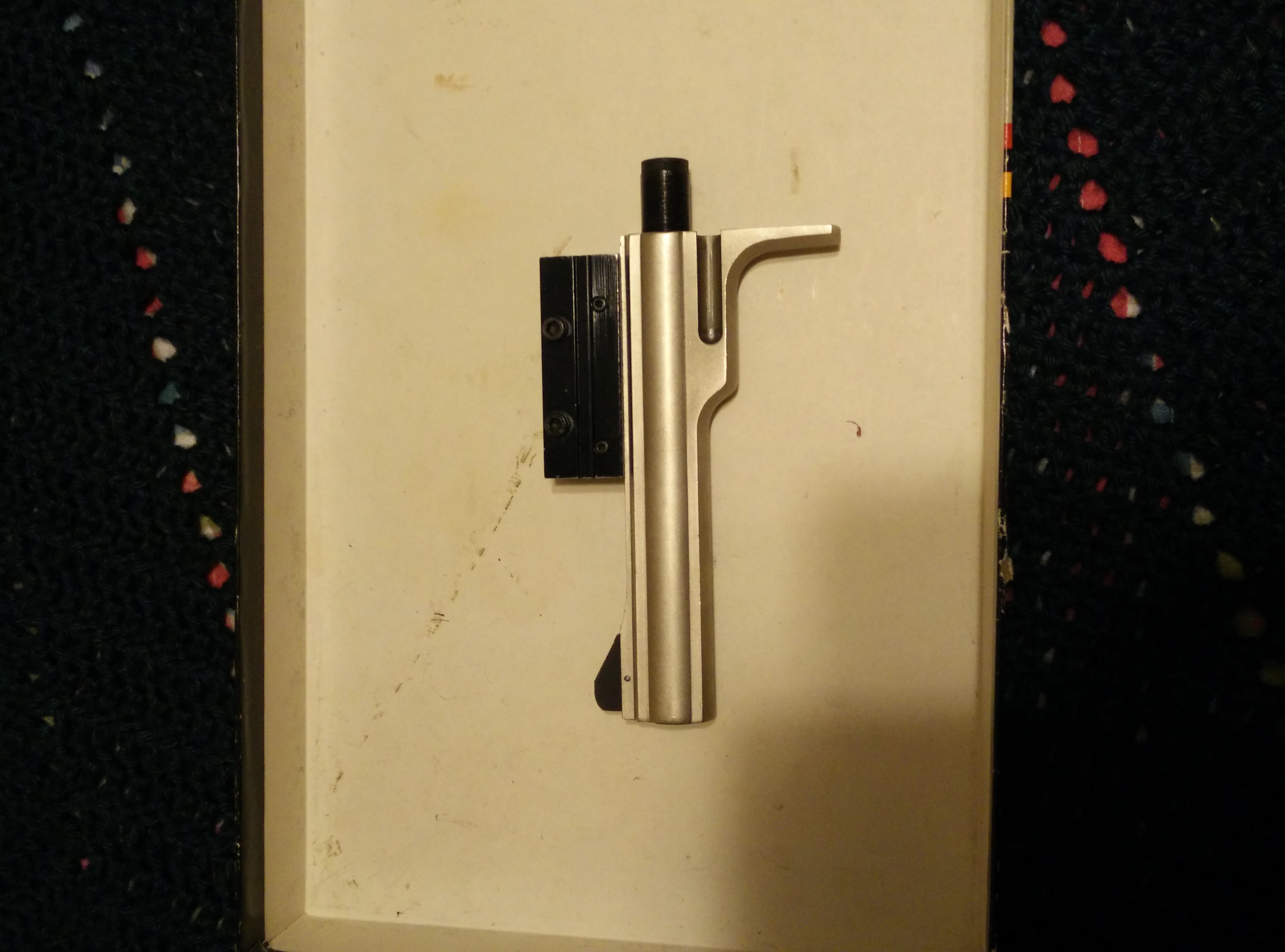

Awesome it looks like it worked although they arent in the intended order and it looks like there is a duplication. First photo is obviously from the right side plus all the included material i recieved with the gun. The second is a picture of the satin stainless steel 6" barrel that I purchased off gunbroker, it has been drilled and tapped and I hoped to put a scope on it but now im thinking of saving it for a possible future trade for a blued porkchop that matches the gun. For some reason the file with the serial number has not uploaded so i will try that with another post.IMG_20150117_205414.jpgImage Enlarger

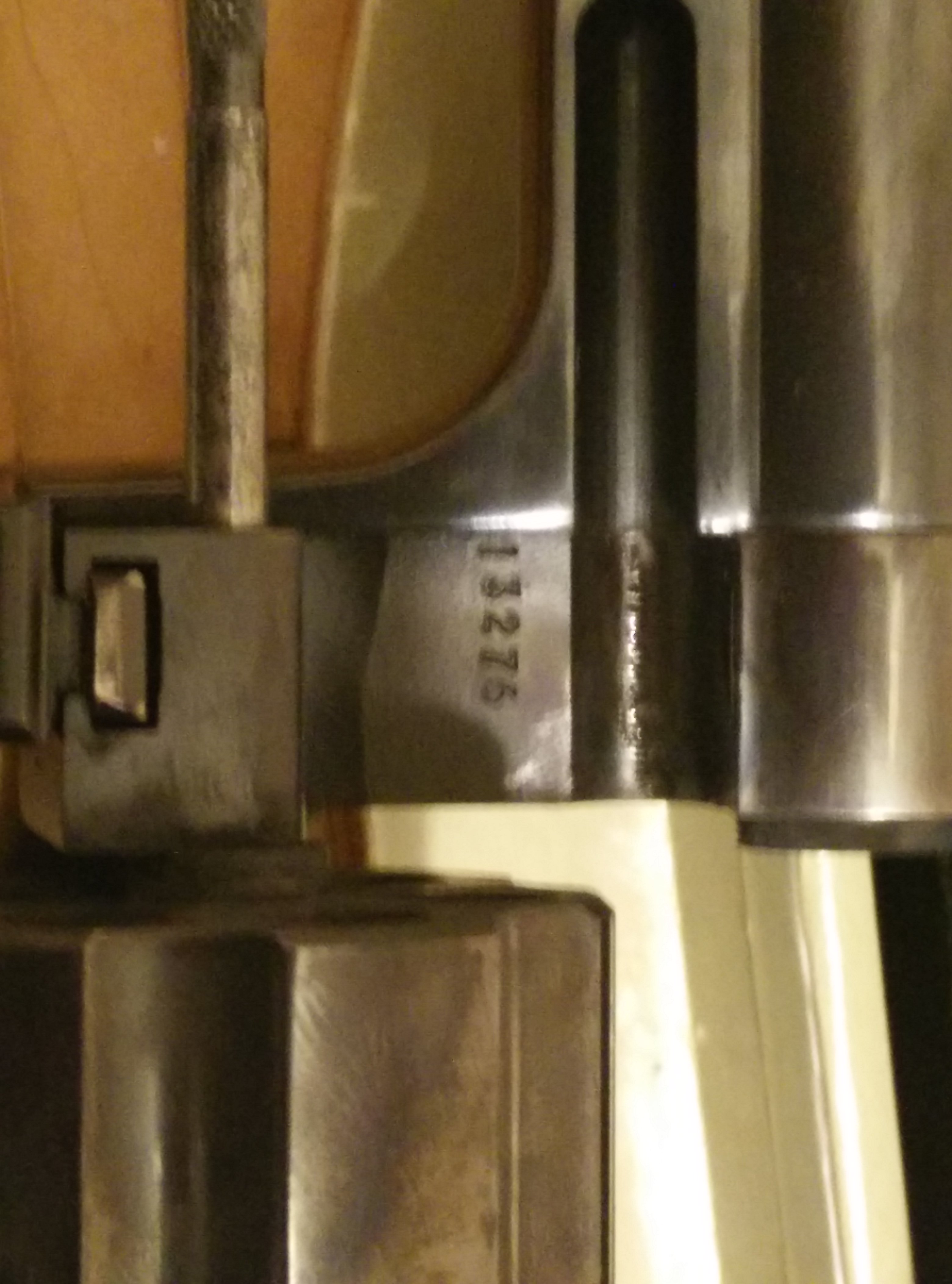

Alright now I'll tell you a little bit about myself. I purchased this blued model 15 porchop with 4" barrel about 6 months ago and it has quickly become my favorite gun to bring to the range because of its amazing accuracy and fantastically light trigger pull. I originally bought the 6" satin stainless steel in hopes to put a scope on it to further enjoy the inherit accuracy of this gun but after bring it to the range and using the fixed sights I was disappointed to find that it was not up to the standards of the 4" original barrel, so now I plan to hold onto it with hopes of finding someone with a 2" or 6" blued porkchop barrel that wants to trade. Her I will try to include a photo of the serial number under the crane, it is either 13276 or 3276 I don't know wheter the vertical bar that is slightly removed from the other numbers is a one or if it is just a random mark, hopefully someone will be able to help me out and give me so information on it. As to why I joined I have been poking around for the next couple months and finally joined as today I won a bid for a 6" monson vented 15-2 that will hopefully be the beginning of pistol pack of my own.
As you can see it is fresh from the range, I didn't want to give anyone the impression that I don't bring this guy out every chance I get to get her dirty.IMG_20150117_205347-1.jpgImage Enlarger

I need to advise you that it's not possible for that extra shroud to be stainless, DW did nothing in stainless until mid 1982. It's most likely been refinished with something like Armolly or a satin nickel.
January 17, 2015 - 9:51 pm
Good lookin 15 there heckler.  6" is likely a matte finish nickel. Dont think there was any stainless in the early days. Some of these guys with a little more experience with older dans may give a better response. You might just make a trade with it. Worth the effort....
Thanks for showing her to us. I see you got a wrench, did you get the barrel gap gauge as well? you'll need it. There is the Average Joe Tune-up thread in the gunsmithing forum probably want to check that out too. Be sure to give a range report when you take out.. and dwf-welcometo dwf

Interesting about the finish, it was sold as stainless which is why I assumed that's what it was in reality the finish wasn't important to me, it was more important that I find a longer barrel in a porkchop shroud, being drilled and tapped for a scope was a bonus. Unfortunately I'm no where near as accurate with it as I am with the 4" barrel so it hasn't been back on the gun since I took it to the range the first time. No I don't have the gap measurement tool. I just kinda eyeball it. Im sure its not the most precise way, basically I just screw in the barrel till it touches the cylinder, then back it out until I can see just more than a sliver of light. I have torn the gun completely apart, amazing what that little tool can do, I have read up on the average joe tune up since but didn't know about it at the time, instead I just took at all apart stripped off all of the 35+ year old grease lubed it up and reassembled, luckily there was a YouTube video to help guide me through it. I have to say I don't know what could be gained with a polishing job, I almost exclusively use it for target shooting so 95% of the time I'm shooting in single action and it could not be lighter or crisper. On my best days I am able to put a ragged hole in the target at 7 yards. I'm sure most of that comes down to the sights though, as I'm sure every gun I own is more accurate then I am but there something about the Dan Wesson that just agrees with me.

Yours is a 1971 gun

Welcome.  Your 15 is wee bit younger than mine (121xx).  The first 1 is part of the serial number.  I agree with you on the DW being the gun to have at the range.
