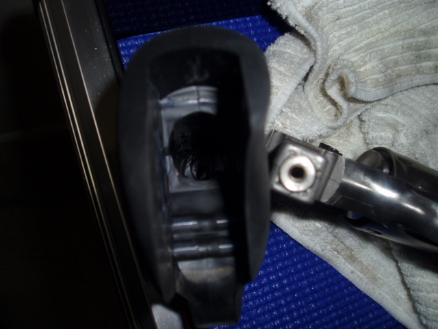

OK, here is a picture of the revolver (upside down) and an inner view of the grip. It appears to me the post (tang?) of the revolver is square; the hole in the grip is round. I wonder if we have here a classic case of a square peg in a round hole? screwy
September 4, 2011 - 9:22 pm
That is indeed the Large Frame grip, not really suited to your revolver. If you like that type grip, there are many available on eBay all the time, they could be available in a well stocked local gun shop as well.

OK, I finally got around to working with my DW. The grip issue was an easy one for me since Hogue make a Pau Ferro wood grip with no finger grooves for the gun, I really like that grip and I think it will complement the DW nicely.
