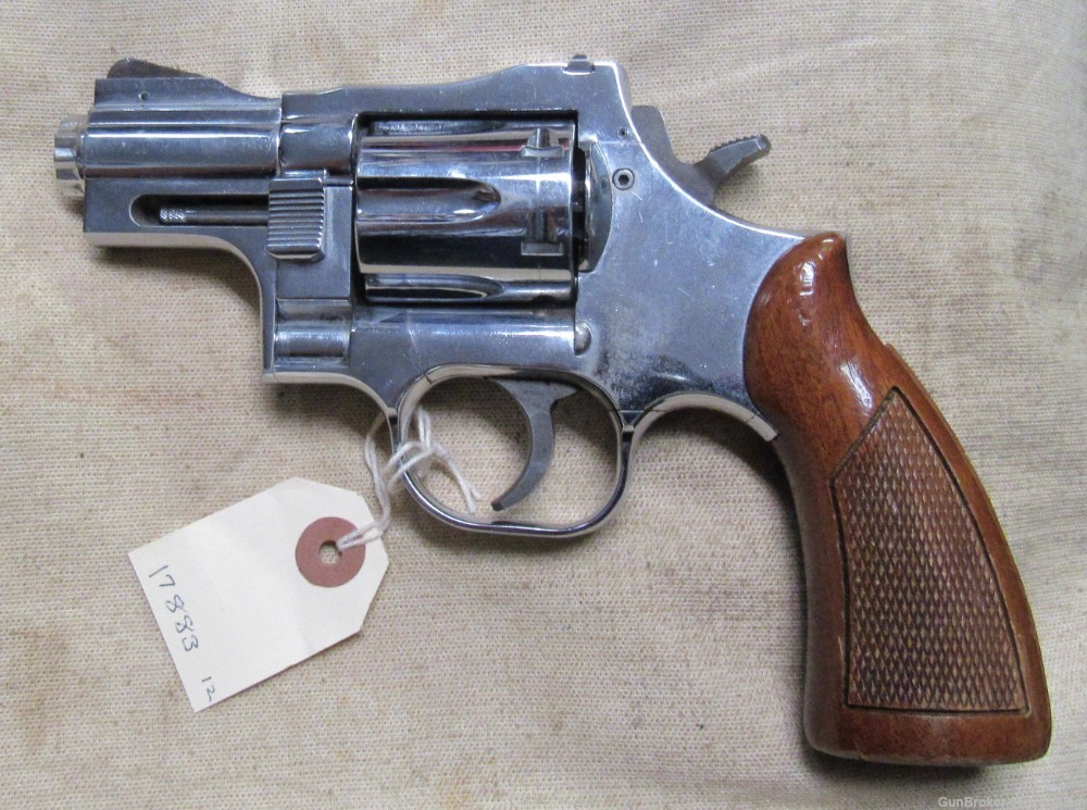

Long time Dan Wesson admirer but 1st time owner. Just picked up on GB a 1970 Model D11 Pork Chop .357 Magnum Revolver. Never put 2 + 2 together that Dan Wesson was part of the S&W family until I researched the revolver.  Love the S&W N frames. Own a few. All great shooters.
I see that the cylinder release latch is mounted on the cylinder crane.  Any known issues with this? Does it interfere when drawing from the holster (any recommendations for a CCW one).  TIA.

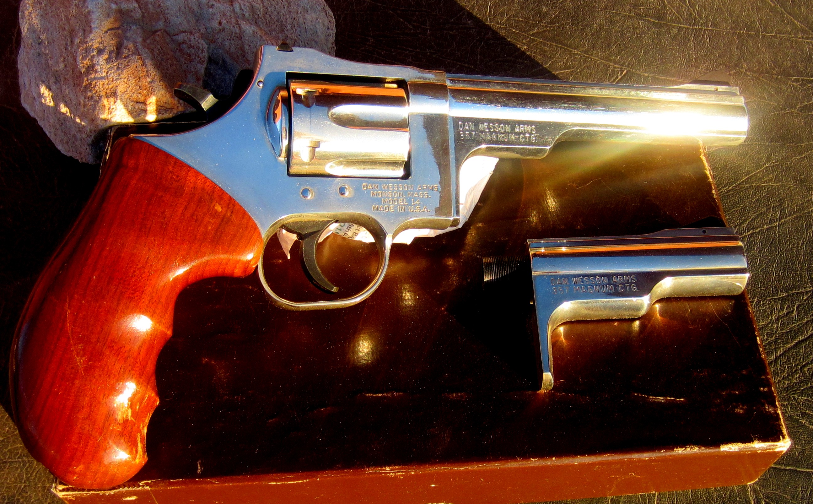

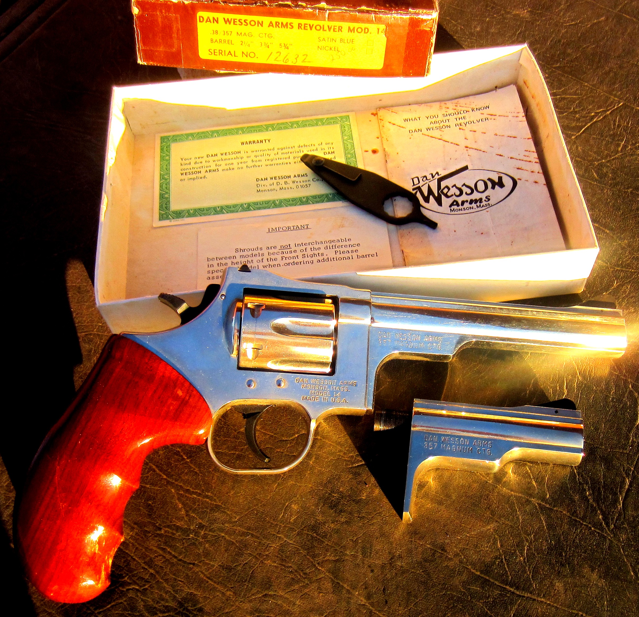

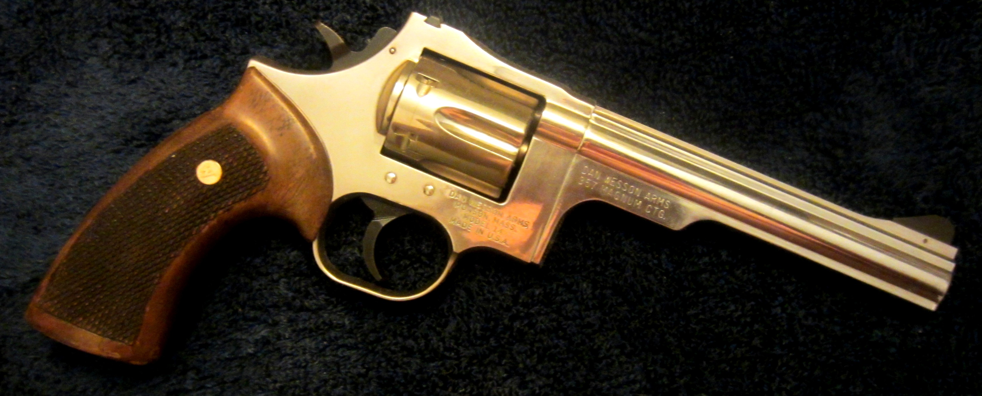

Great deal! Original nickel I think? I was going to bid on it but I have some much tied into the 45 Colt i'm bidding on I have been laying off everything. Also I bought an original nickel 15 a month ago and not so much a pork chop fan so i'm good. I also know nickel guns always look much worse in pics so I bet yours will look a lot better once it's delivered. Nickel guns show all the scratches in pics mine did also but once I got it I was very happy!  I noticed some very good deals this week and some not. You got a great deal for that gun! I paid $750 for my nickel but it had a box and extra barrel! I was so tempted to bid on your model 11 I should have got in at that low price! Welcome to the Forum! This will not be your last Dan Wesson revolver purchase I would bet! I also added a period grip to my gun!  IMG_5278.JPGImage Enlarger

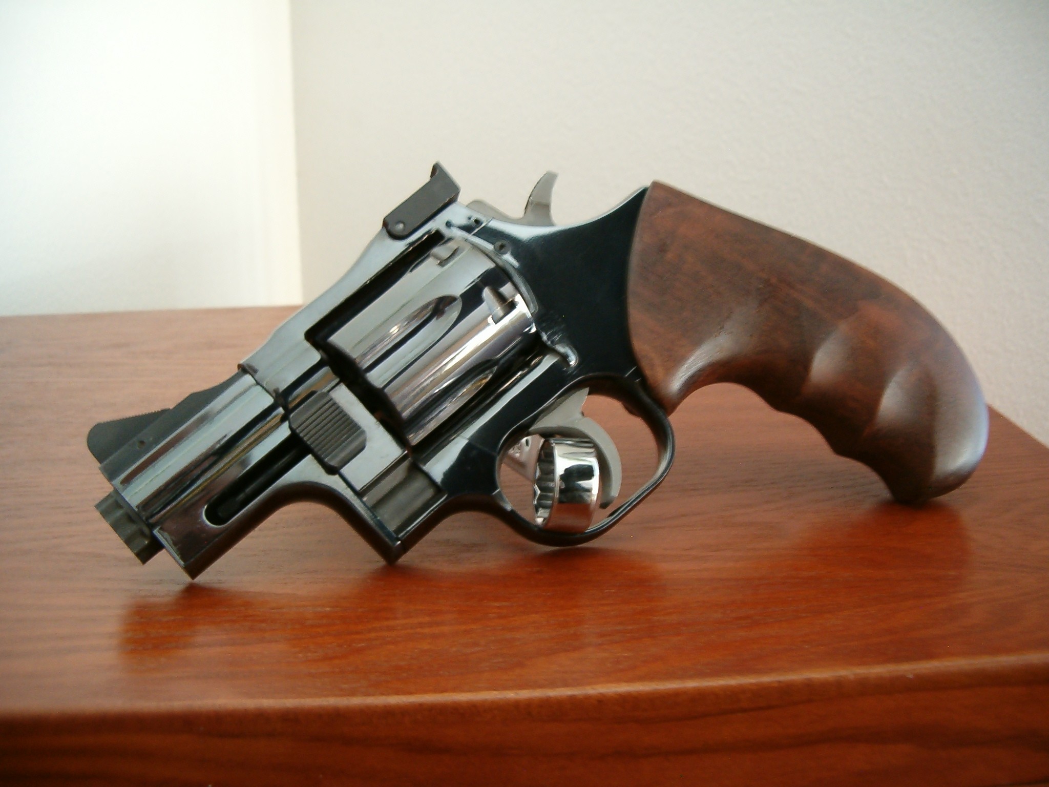

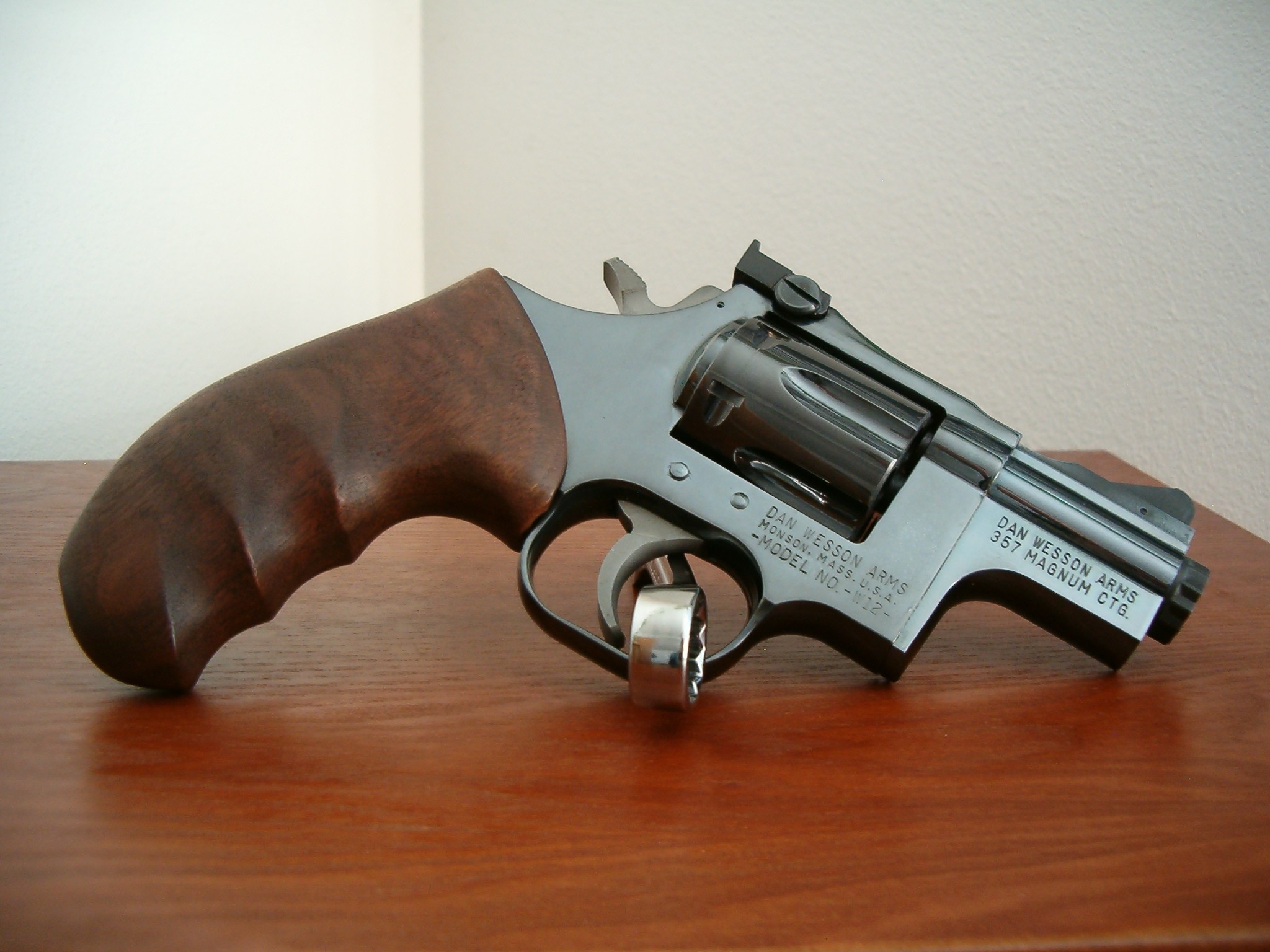

Congrats on landing your nickel D11 snubby, that's pretty cool!
IMO, the Porkchops look their very best wearing snubby BA's...makes 'em look kinda like a bulldog, in a way. cool To me, the snubby BA accentuates the exaggerated features of the early 'chops. Big sights, the fat exposed barrel nut & the Porkchop shroud all work together to make these guns "a face only a mother could love". wife lol2
Here is one of my Model W12's (the target model to your D11...adjustable rear sight & taller front sight) wearing a snubby BA.
HPIM3347.JPGImage Enlarger
HPIM3345.JPGImage Enlarger
HPIM3340.JPGImage Enlarger

The cylinder release mounted on the crane is/was one of the main selling points of the initial DW gun design. It is supposed to firmly lock the front of the cylinder better than the "other manufacturer's" idea of placing the release at the rear. Back in the day, that little latch location was discussed & debated a LOT among the various monthly gun rags.  Today, you can still easily spot a DW revolver from across the room, due to it having that front mounted cylinder release, so it wasn't an ineffective design.
No known issues drawing from a holster.
