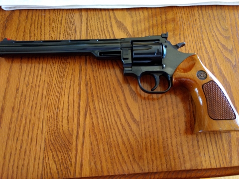

Hello,
Recently won an auction on GunBroker of a Dan Wesson 15-2 8" vented barrel revolver.  Took it to the range today for the first time.  After shooting about 30 rounds I noticed the ejector rod was loose, so I quit shooting it.  When I got home to clean the gun I cannot get the rod to screw back in.  It is not bent.  When I take the star thingy off the cylinder and screw the rod in it goes in fine but does seem that some of the early threads may be stripped.  It is a beautiful gun and my first Dan Wesson, always wanted one since the early 80's.  Thank you for any help you can give.IMG_20180419_100402593.jpgImage Enlarger

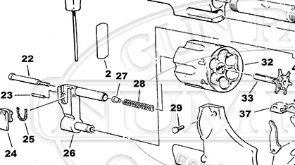

Getting another extractor is not a simple matter. They are a factory fitted part. DW will sell them to a gunsmith or FFL. With that being said, a used extractor would probably work fine. But it is a chance. They also rarely show up on ebay. More often the whole cylinder assembly shows up. That is much pricier. The fact that the extractor rod screws into the extractor( also called a star.) makes me think it is not the problem. If you use 2 empty cases in the face of the cylinder to hold the star from turning it may work.
May 13, 2018 - 10:41 pm
My bad, rear of the cylinder
May 14, 2018 - 5:33 am
Additionally, make sure the components are installed in the correct order. Sometimes the bushing likes to find it's way to another location....

Karl Lewis designed the Dan Wesson to not need a Smith for most repairs. Most Smiths are woefully ignorant of Dan Wessons. They know Smiths and Colts. I would read "The Average Joe Tuneup" in the forum and research past threads. Ron's diagram is self explanatory. Once you do the tuneup a time or 3 you can build a Dan from a pile of parts. Everyone on the forum can help. If you are able to screw the rod into the star when not in the gun it is likely not damaged. If in fact the threads on the extractor are damaged the best thing to do is send it to Dan Wesson. A Smith will likely keep your gun for months and then tell you he could not get the parts. Dan Wesson will have your gun back in no time.

I will have to look into sending it to Dan Wesson.  I may watch a few videos on YouTube to see if I can take the cylinder off.  Maybe the spring is broke inside keeping the rod from going into the extractor.  Thanks everyone for the tips and encouragement.
