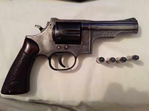

Hello, I hope not to break any rules with this post.
My Dan Wesson is doing this weird cylinder movement, so far it doesn't seem to affect the funtionality of the revolver.

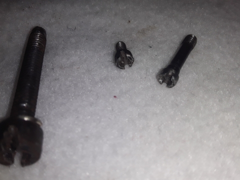

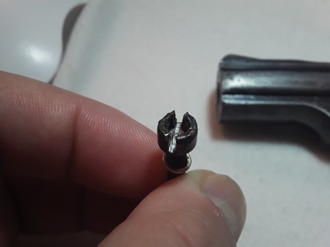

Also is it possible to buy some new screws for this model? any online stores to buy the short and long screws? I had to drill them in order to dissasemble the gun for clean up.
I suspect is a model 8 but it will be helpful if someone can confirm the model.

I suspect your extractor rod is bent.  What's the caliber?  I can't make it out

This looks like a very worn Model 14. The crane must have developed enough wobble over the years that it is allowing the cylinder to move past the spring loaded alignment ball when closing it as you're doing in the video. Notice that it always springs back into position. I would take the ball spring out to see if it is damaged or weakened in some way. If it has good pressure on the ball when properly installed you should be fine, just don't press on the rear of the cylinder as you're doing in the video. DWs are not like Colts and Smiths. They do not have a positive locking rod into the back of the cylinder; only the alignment ball.

Most of the parts you're referring to are interchangeable on all small frame DW revolvers, so it doesn't really matter that you positively identify what model you have. The exception is with the crane assembly on the pork chops. These are different from the 15-2 onward. There are not as many of these pork chop revolvers around compared to the later DWs, so you may have to keep checking on eBay for quite some time until one comes available.
However, I really don't think you need a new crane. If the revolver is indexing properly and doesn't spit any fouling back at you the timing is probably OK. If you want to check the timing: pull the hammer all the way back very slowly. The cylinder should be locked on the bolt just before it reaches the full cock position. If you have to turn the cylinder by hand even the slightest amount to get it to lock into position you will need to replace (and fit) the hand.

This is the sad state of the screws:
20191210_232742.jpgImage Enlarger
20191210_235619.jpgImage Enlarger
