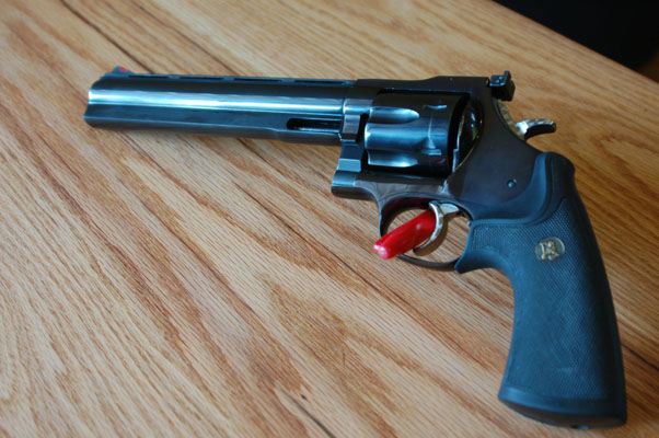

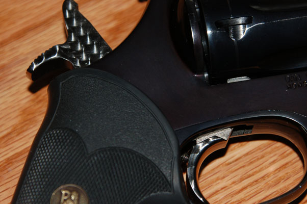

I just bought my first Dan Wesson, 44 Magnum 8" heavy barrel.  Shot some rounds through it..awesome!  Got a 357 Magnum on the way already.  Curious about something on my 44.  It has a jeweled trigger and hammer.  Couldn't seem to run across much info with that feature.  Didn't know if that was standard on this model or optional.  Hoping I could determine an exact model #,  year of manufacture and approximate value.  Gun is in absolutely wonderful condition.  Looking forward to getting acquainted with the many members of this forum.

Welcome to the forum from PA. I have never seen a Dan Wesson with any factory jeweled parts, so I am fairly certain that your trigger and hammer were done later at some point. It does look nicely done. Since your revolver is blued, the model # is simply 44. A stainless .44 magnum would be a 744.
   To get an idea of build year, check out the serial number chart under 'archives' in the top header of this page.

March 27, 2013 - 1:59 pm
To add to lonwolf's reply, The good news is 1. It's a great looking specimin and 2. Since someone jewelled the hammer, I'm sure they worked the action as well and I'd bet the trigger breaks like glass!
Welcome to DWF, where we help you spend money!
March 28, 2013 - 6:07 am
I agree, so far I haven't seen any documented factory jeweled DW hammers & triggers, so I can only assume that yours was done by a gunsmith sometime after it left DW. I must say though, that it appears that someone did a nice job!cool
Since yours has a short hammer spur, I assume that your s/n is in the range of 103xx or less, but greater than 500.  Let me know if I'm in the ballpark.laugh This gun would probably have been built around 1981...give or take a few months.

Like really thin glass.  I have a S&W Miculek 45 ACP which has a wonderful action but this one tops it.

You're mighty close, it's a 102xx.  Is there a nomenclature to the serial numbers or are they just a sequential assignment?

+1 on the hammer and trigger...someone did a nice job and it looks great. A far cry from that POS jewel job that was showing up a year ago with complete coverage on SS!

Thanks.  Lucky added goody when I picked it up.  I am going to contact the seller and see if I can find out if he has any record of who his father utilized.

The numbers were sequential. The only ones that weren't were custom special requested s/n's. Your short spur gun has a high s/n, it wasn't long after yours was made when they switched to the long hammer spurs. That's pretty neat.laugh
