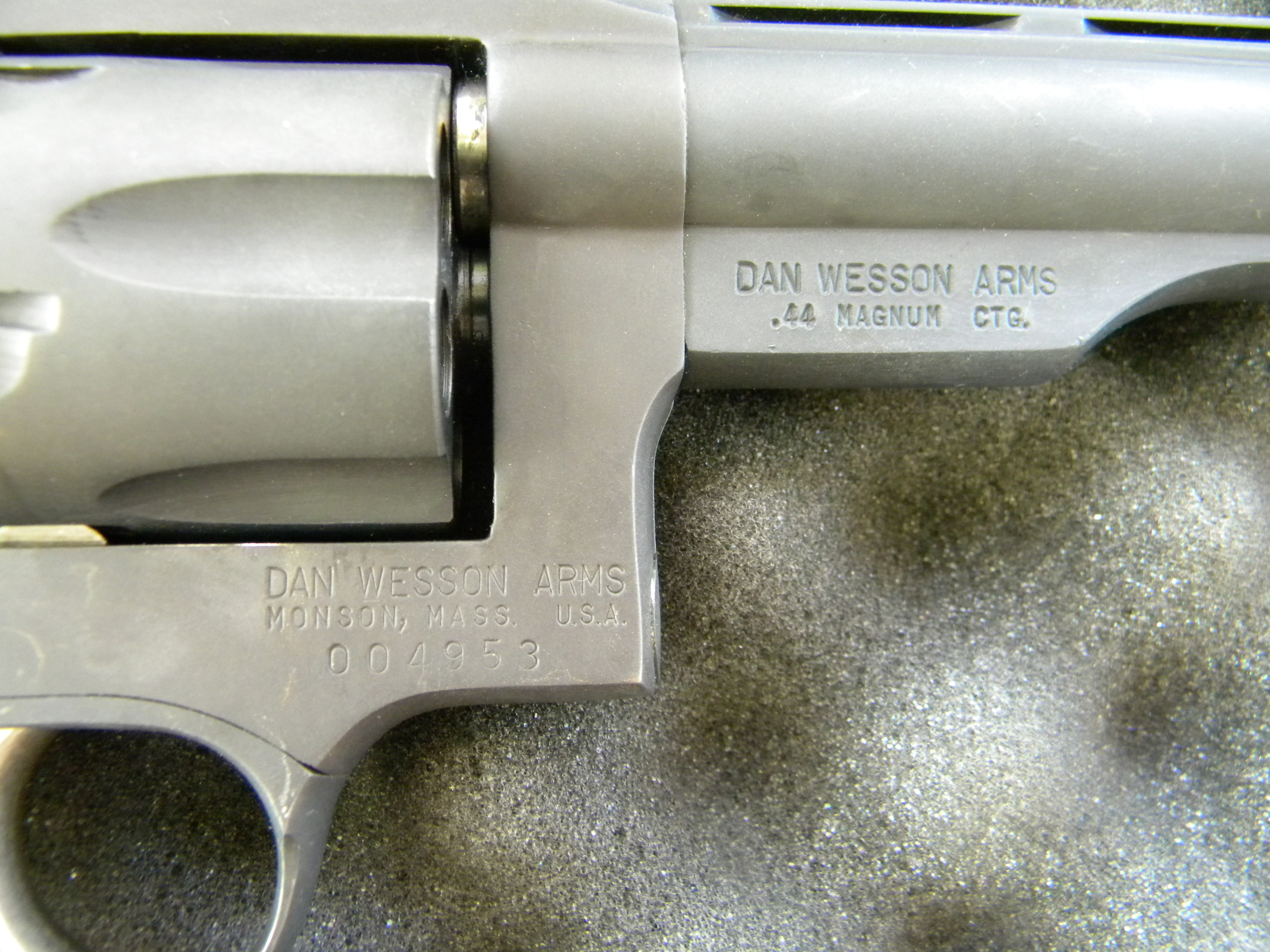

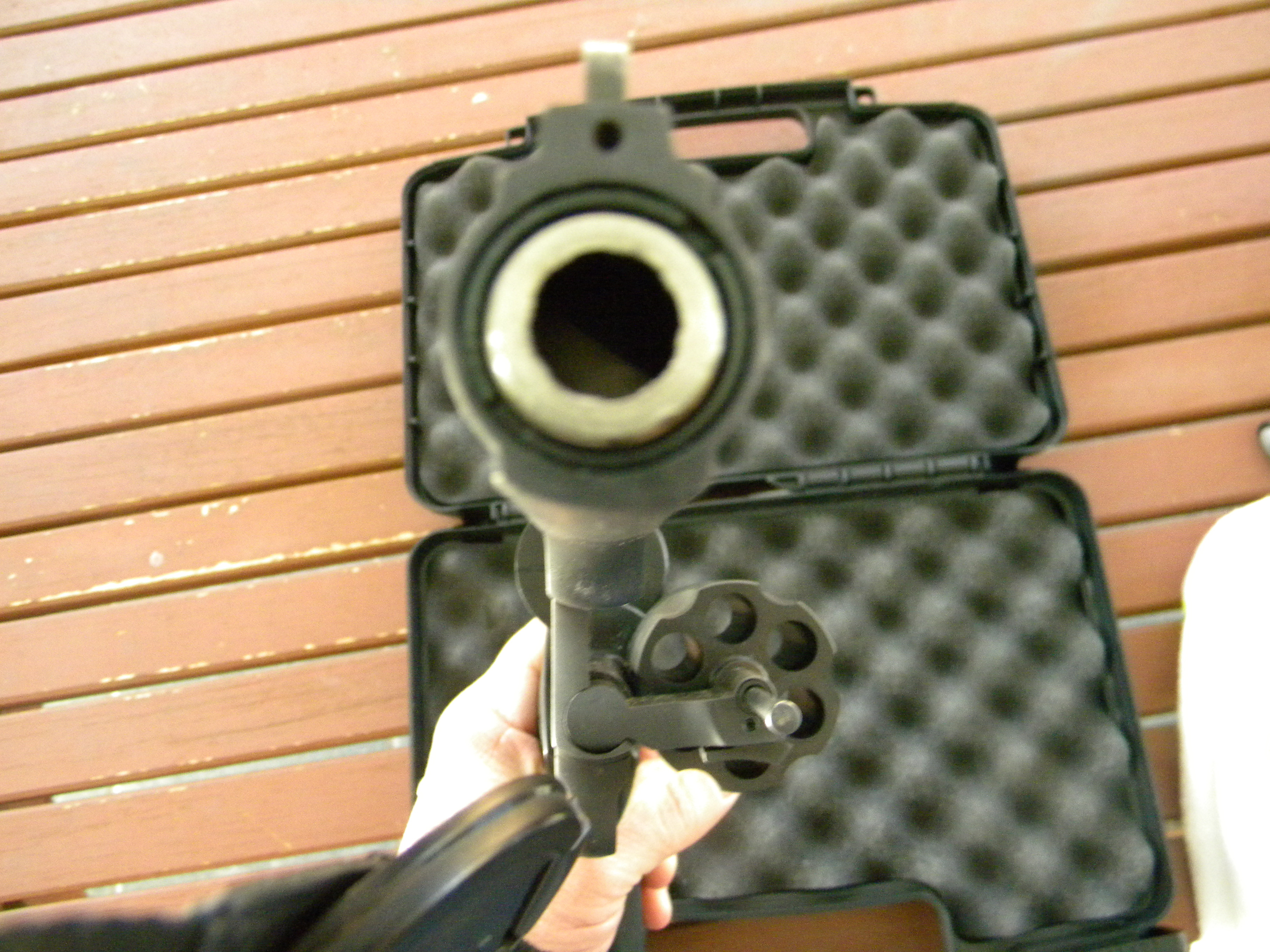

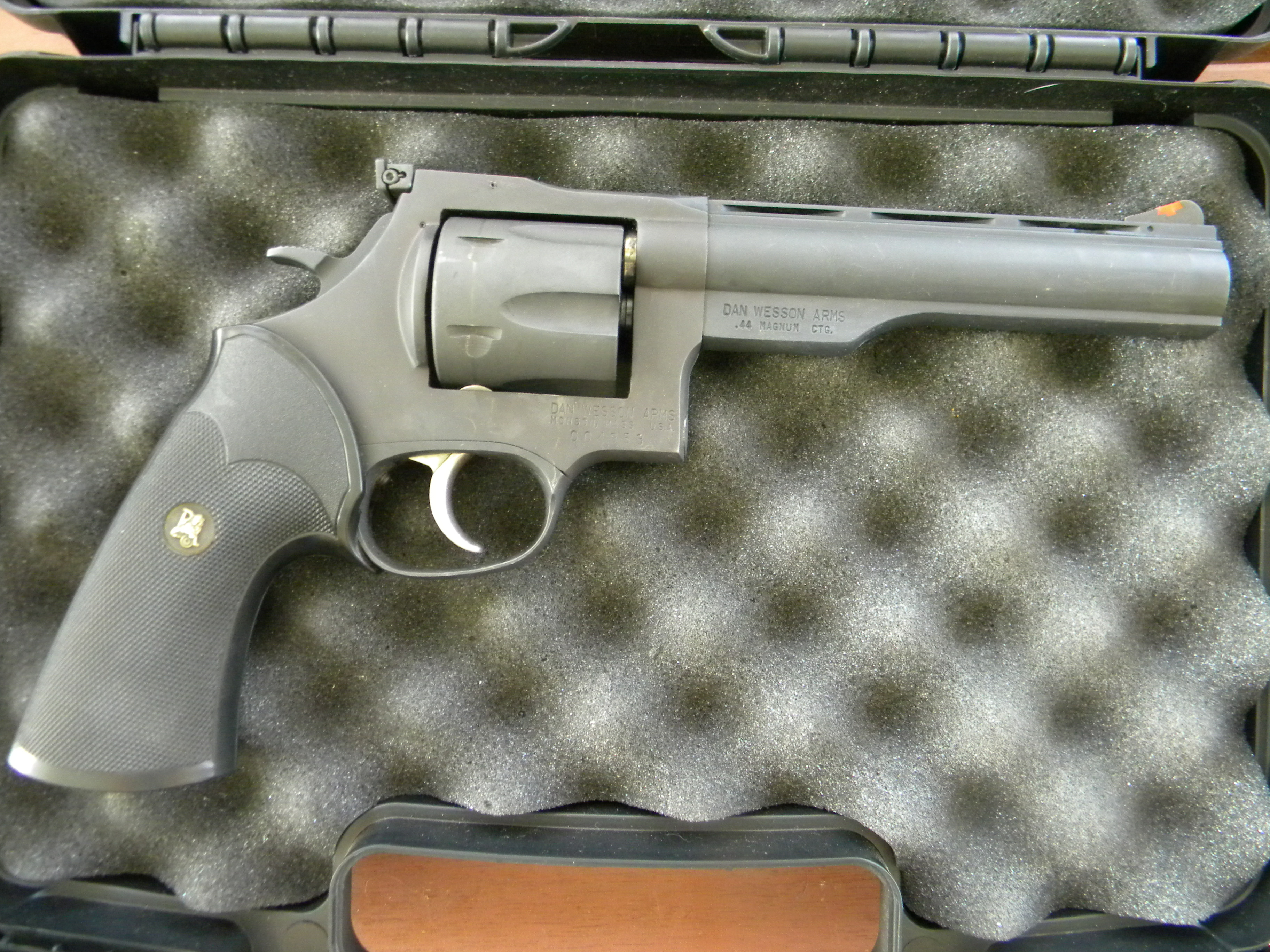

Just purchased a used DW .44 mag with  black matte finish. According to sites I have visited this finish was used for the top of the line revolvers. It's at the gunsmiths now and when I pick it up I will post photos. This is my 1st Dan Wesson and would like to find out any pertinent information about it. Feels like a very solid hand gun. With the gun laws today I'm lucky to live in Arizona.Barrel is vented and ported
Thank you Scorpio for replying. Just picked it up from my gunsmith(he does not recall seeing any of model with this finish)
Here are some pics. This also is001.JPGImage Enlarger
006.JPGImage Enlarger
004.JPGImage Enlarger
vented and ported

I am unaware of a black matte finish from the factory on the 44 mag. It may however be so or it could be a .445 supermag. They made a stainless gun with the black finish and a 4" barrel, maybe compensated,  that is called the Alaskan Guide Special. It also chambers 44 mag and 44 spec.. Early ones may not be marked AGS. The cylinder and frame would be longer than a 44 mag. It is a top of the line gun. If it was sold as a 44mag you probably got a hell  of a deal.
Not sure what the gunsmith is going to do. Most gunsmith are not very knowledgeable about DWs. If he is just checking it out and cleaning you are okay. DO NOT LET HIM DO AN ACTION JOB. They are not like Smiths or Colts and he can ruin it if he treats it as such. Filing and cutting springs is not the way to do it.

dwf-welcome aboard, and thanks for posting cool-pics
That finish is not original to the gun, I'm sure some other members will be along shortly with some good guesses as to the name of the finish. You may be interested to know that your gun was made the first year DW introduced the .44 model, 1981. And being  an early gun, yours also has the short hammer spur.
Pretty neat!occasion
December 12, 2016 - 5:31 pm
004953 was manufactured in 1981, and it would have been a blued finish. This looks like ceracote or parkerized.
December 12, 2016 - 7:50 pm
That looks like it was Parkerized owing to the grey cast it  has.  As Steve said, it should have been a brite blue finish from factory.  Tha is an early 44 though, nice find.

One question when you open the cylinder there is a casting mark under the crane latch area, is it a "s". if so it would be a stainless frame.occasion
December 12, 2016 - 10:40 pm
I don't see an S in the serial number though, that's why I believe it was a blue gun, but I could be wrong.
December 13, 2016 - 8:08 am
Short hammer spur. I don't believe any stainless revolvers exist with a short hammer spur. Then again anything is possible.

Beat up Dove Grey maybe?  I can't remember when the Dove Grey models were produced.
December 13, 2016 - 5:33 pm
Serial number is too high for a Dove Grey model.
December 13, 2016 - 7:27 pm
Dove gray were 1 to 500. First 250 were engraved. The shroud is ported but the barrel may not be. Better to not be.  Power porting was not their best idea. The fumes filled up the space between the shroud and the barrel and deposited powder and lead if the bullets were not jacketed. About every 50 rounds one would have to remove and clean the barrel and shroud or they would fuse together with residue. There were 6 holes in the ported barrels and they did not line up with the ports in the shroud.

Do think as a replacement barrel it would be ok to use a modern non ported ? You guys are great, and for some reason I really like this .44. Have not fired it yet. Got it back from my gunsmith who did just a cleaning and over check out. Been seriously thinking it would be nice to have the xtra barrel. Also my barrel has slots around it not round holes.

That would be the shroud with the slots, the barrel inside may or may not have holes.wink Get one of EWK's barrel wrenches (direct link in the tab on the right of this screen) to  open it up & determine what you have inside the shroud.
