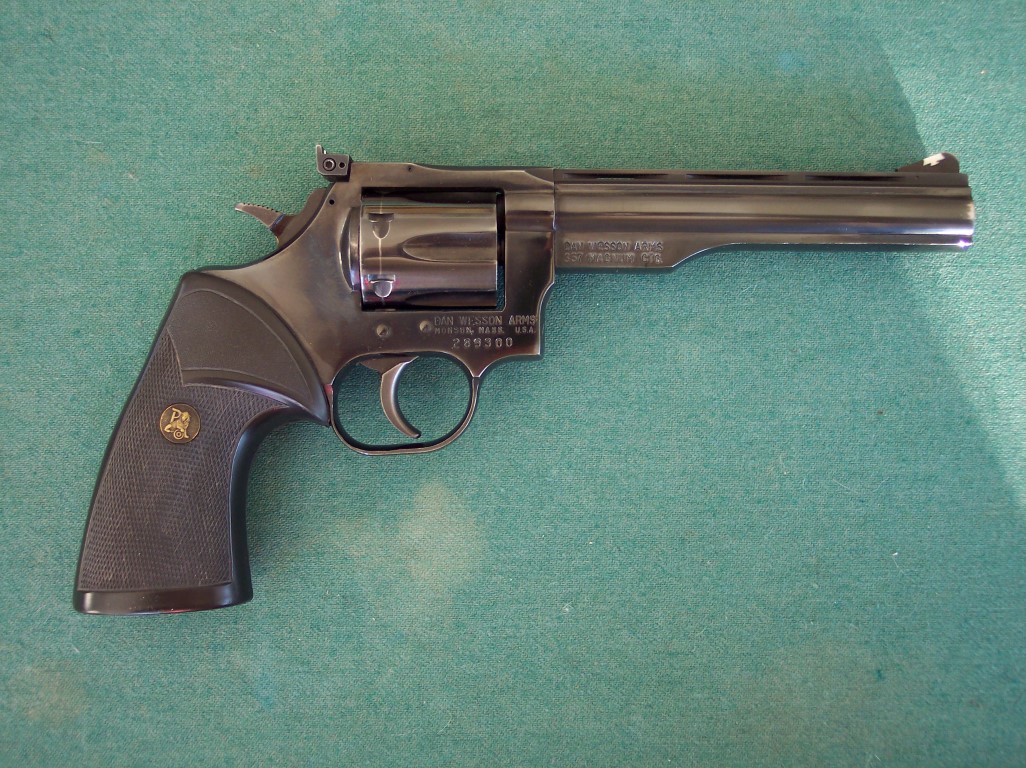

    Hi all, I'm new to the forum (lurked a lot but never posted) I am a big fan of the Dans and try to get people into them as much as possible Iv'e got 2 friends looking at them now. I don't have a bunch of free time with two kids so I'm going to ask a few ?s at once. thanks for any help in advance.
    I've owned my 15-2 for about 15 years, but haven't shot it in about 10.  I just reloaded some 158 gr. stuff up and tried it out. it shot fine with the exception of the primer strikes seeming to move around (wasn't checking any accuracy just looking at casings for pressure signs). Out of 30 rounds only 4 are what I would say as well centered. the rest the actual edge of the dimple is at the center of the primer, some worse than others by probly .020".
    Is this some thing that should be addressed? I can see some wear in the cylinder lock notches, but it appears minor, like .005". and the total cylinder play is on par with my two other revolvers. There was no shaving of material on the forcing cone edge.
    the other issue i noticed was, the little nub on the frame that keeps the cylinder from moving back when it is open  overlaps the edge of the casing, so if the nub isn't in between two shells it prevents the ejector rod from being depressed. weird I never noticed that when I used to shoot it  alot. has anyone seen this before?

just looked @ it some more. with the crane open looking down at the weapon, holding the cylinder, and the grip firmly, there is some play in the crane to frame joint, while torquing the muzzle left to right.
   hope this description is understandable. not a lot of play mind you, but more than my 686.

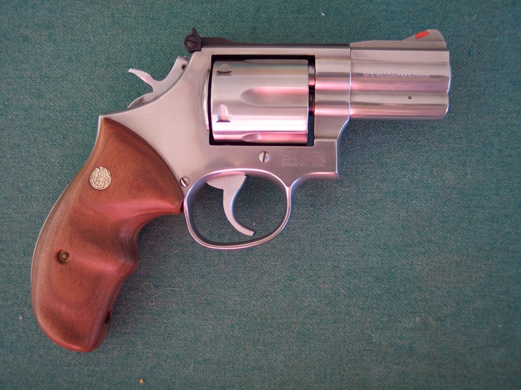

                                          thanks for the help guys.  heres a pic not a dan but a cool picImage Enlarger
