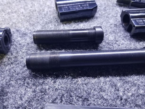

i picked up some extra 15-2 barrels.....(all lengths) after taking them apart i noticed that all of the barrel threads
(except the 12 and 15" were longer (both ends) with the frame threads being about a 1/2 in longer up the barrel towards the muzzle...so i checked my 15-2 pistol pac 265xxx and they all were threaded shorter ....having some computer issues right now but will post pics when i can....
just wondering if longer threads were earlier...then that later barrels
Thanks al

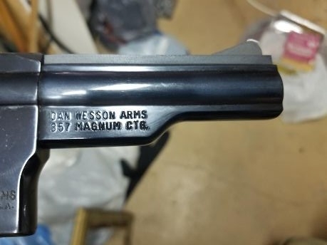

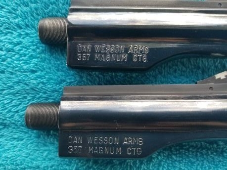

so here is a pic of shrouds...the one on top is from the 265xxx pac....are all the same with a slightly larger E....all barrels have the dw-15-2-marks-2.jpeg
shorter barrel threads
bottom is is more block style......these have the longer barrel threads
the 10" 12" and 15" are of block style with shorter treads

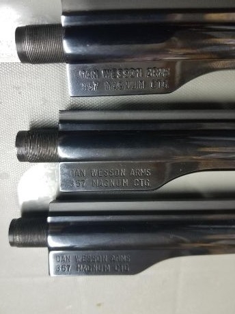

got alittle ahead of my self.....the 10" shroud is close to the pak markings....the 12 and 15" have the block style marks
10 on top 12 in middle and 15 on bottom

just had a thought i have a early 15-2 sn 53xxx.....will check the threads on that....update this barrel also has less threads....and shroud is of the slightly larger E style
Thanks for any input

sfal said
thinking the longer threads are Palmer maybe?
Monson used a two-line roll mark on their shrouds and Palmer only a one-line roll mark.
Thanks so Monson.....now to figure out why the different thread lengths...:)

also when i say "block" style....they are all sort of a block font.....the ones from my pac sn 265xxx seem to be applied with a punch....and the other maybe rolled on...as they seem to be a cleaner marking
Thanks always trying to learn
