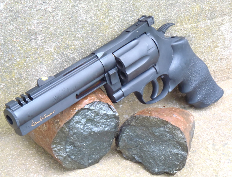

Since you are ordering a new barrel and shroud get a compensated one instead of the ported type.  I have included the photo below (this one belongs to one of our members) so you can see what I'm talking about.Image Enlarger
January 6, 2012 - 7:20 pm
I may have started all this by suggesting that Eric "might" be willing to put MagnaPort type slots into a non-ported shroud, which is clearly a suggestion that I should not have ever put out there.
My opinion is that the whole DW "porting" method is probably pretty ineffective, and may well create more problems that it solves. The DW barrel/shroud system does not lend itself to a MagnaPort solution, which is a time tested and very effective modification. The only result that I see from the DW method is to fill up your shroud with a bunch of lead, jacket shavings, crud, and unburned powder that makes shroud removal difficult.
