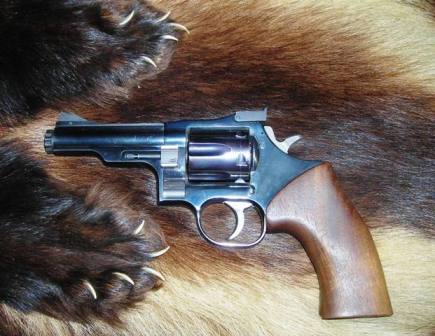

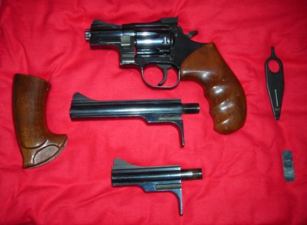

dwasJust got back from a rare trip to the city where I found this.
It has a few nicks and scratches but should be a good shooter.
I did notice the first few grip screw threads in the tang are a bit rough.  I'll need to figure out how to chase these threads without cross threading.
Of course I couldn't pass it up. It's a good partner to last month's W12.
Also, my search for a "shooter 44" hasn't been successful.  I did find this one but it's way too nice to fit the "carry in the woods everyday" category.  Couldn't pass it up either.

Boy BobAk, mighty nice dans and all three W12 barrels to boot. Mighty fine case of DWAS too. Buying two dans at once can put DWAS in remission but does not cure it. I just bought a shooter for 200 $ , a HS mark ii. First purchase since I bought two in one day. FYI beaters don't count.
