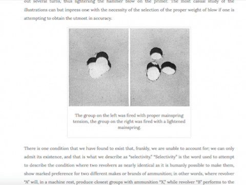

Many of the members of this forum (especially revolver aficionados) have probably read "Burning Powder" by Douglas B. Wesson. First published in 1938 (about the time his nephew Dan Wesson started working at S&W) it goes into great detail about the complexities of firearm accuracy. I've included an excerpt on revolver accuracy specifically that is very interesting reading. Link is at bottom of page.
I bring this up because of my experience today with a newly acquired DW 15-1 (the very last of the "pork chop" Dans before the introduction of the 15-2). My early model 15-2 has been a great shooter, but this 15-1 clearly has the advantage. Why? Same trigger, same hammer (and hammer throw), same cylinder, same cylinder gap, same ammo, yet somehow my groups with the 15-1 were smaller. The only discernible difference between the two revolvers was the mainspring tension. I suspect the 15-2 may have had a lighter spring kit installed somewhere in its history whereas the 15-1 has a much heavier (probably original) mainspring.
Doug Wesson details below how the mainspring tension can affect accuracy in a revolver. It's subtle, and for combat style shooting it means little; but when we're trying for that last bit of accuracy for long range shooting it is much more of a factor. It seems that many shooters are installing lighter spring kits in order to facilitate easier double action shooting which is all well and good for rapid fire scenarios, yet there seems to be a slight trade-off in pin point accuracy.
Of course there could be minute subtleties in design and build which could contribute to why my 15-1 outshoots my 15-2. Doug Wesson also addresses "selectivity", which offers no explanation for a particular revolvers preference for a certain brand of ammunition. Maybe my 15-1 simply "likes" the ammo I used today better than my 15-2.Untitled-1.pngImage Enlarger

We seem to have gotten a bit off topic on this thread. I wouldn't resurrect it except for my experience today at the range shooting both of my Dans; a Model 15-1 and a Model 15-2. The 15-1 produced a five shot group that could be covered with a nickel; something the 15-2 simply could not duplicate. The point of this thread is that the amount of main spring tension on the hammer throw can have an effect on accuracy. Primers vary according to various ammunition manufacturers specifications, so that alone can account for a given revolver's preference for a certain brand of ammunition. However, Douglas Bertram Wesson was obsessed with obtaining the utmost accuracy from his revolvers, and proved that a weaker hammer strike can have an adverse effect on accuracy.
For casual offhand plinking this is of little consequence. It's only when we're trying to hit a target at extreme distances that the slight loss of accuracy becomes significant. The difference between a 1/2 in. and a 1 in. group at 10 yards becomes 10 in. and 20 in. at 200 yards; more than enough to account for a miss on a ram at an IHMSA match.
I will admit that my 15-2 with its lighter main spring is a more pleasant gun to shoot, and it groups well enough to keep me happy out to 50 yards. Beyond that distance I appreciate what the 15-1 with its heavier main spring is capable of.
