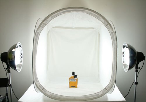

I found a light tent purchased from Amazon works quite well for indoor shooting.  The one I purchased included two light fixtures on tripods and color neutral CFL bulbs.  Also included are 4 color backgrounds.  Many of my newer gun pictures were produced via a light tent like in the picture below

That sir is going in the correct direction to much better lighting!

The above method in the light tent is an excellent choice for getting light in all the nooks and crannies! I think that is a bottle of bourbon though LOL
