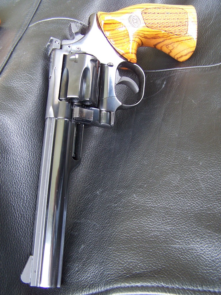

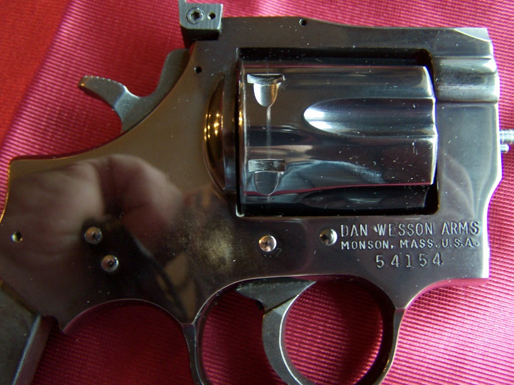

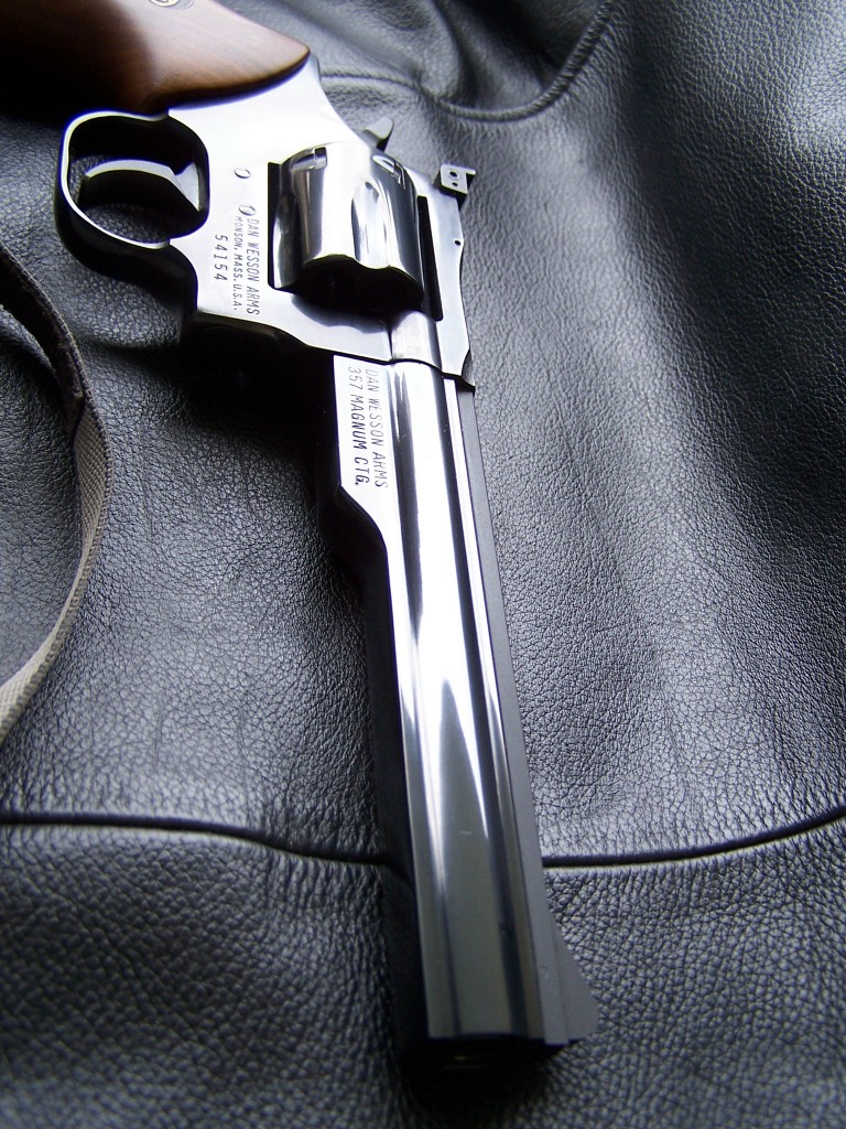

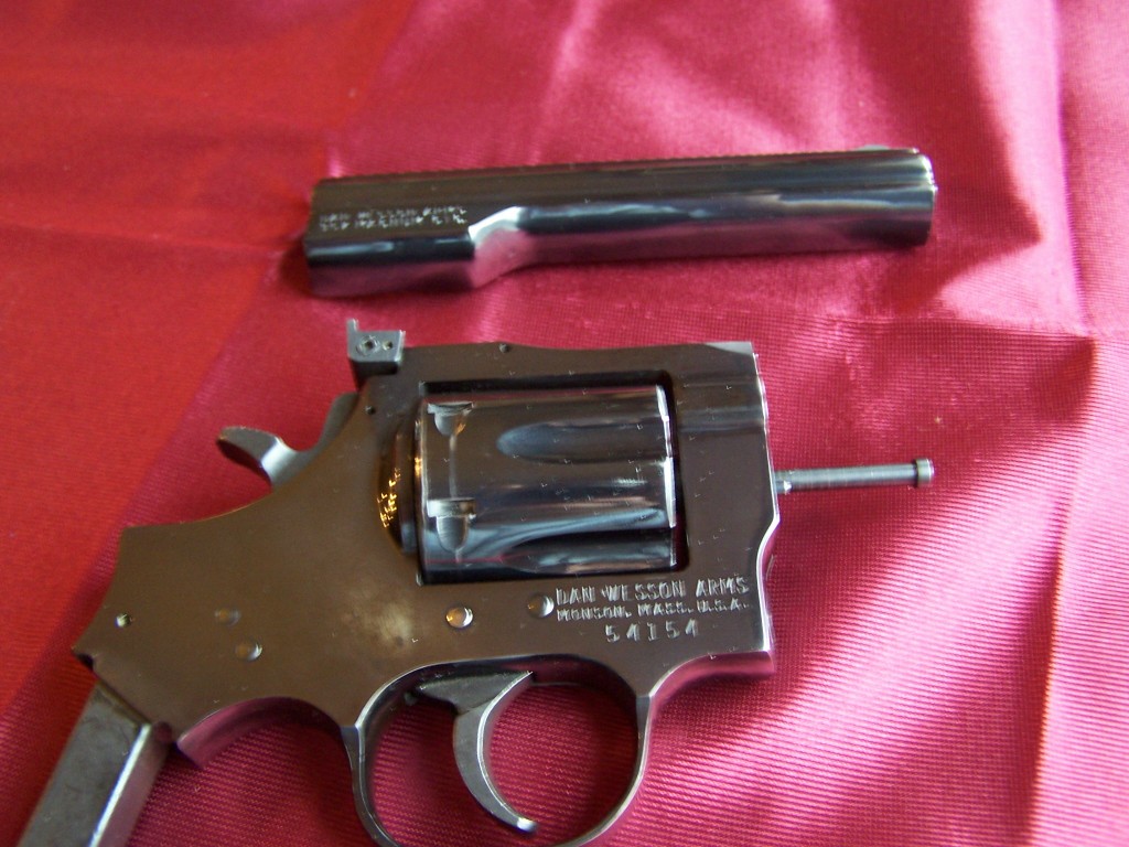

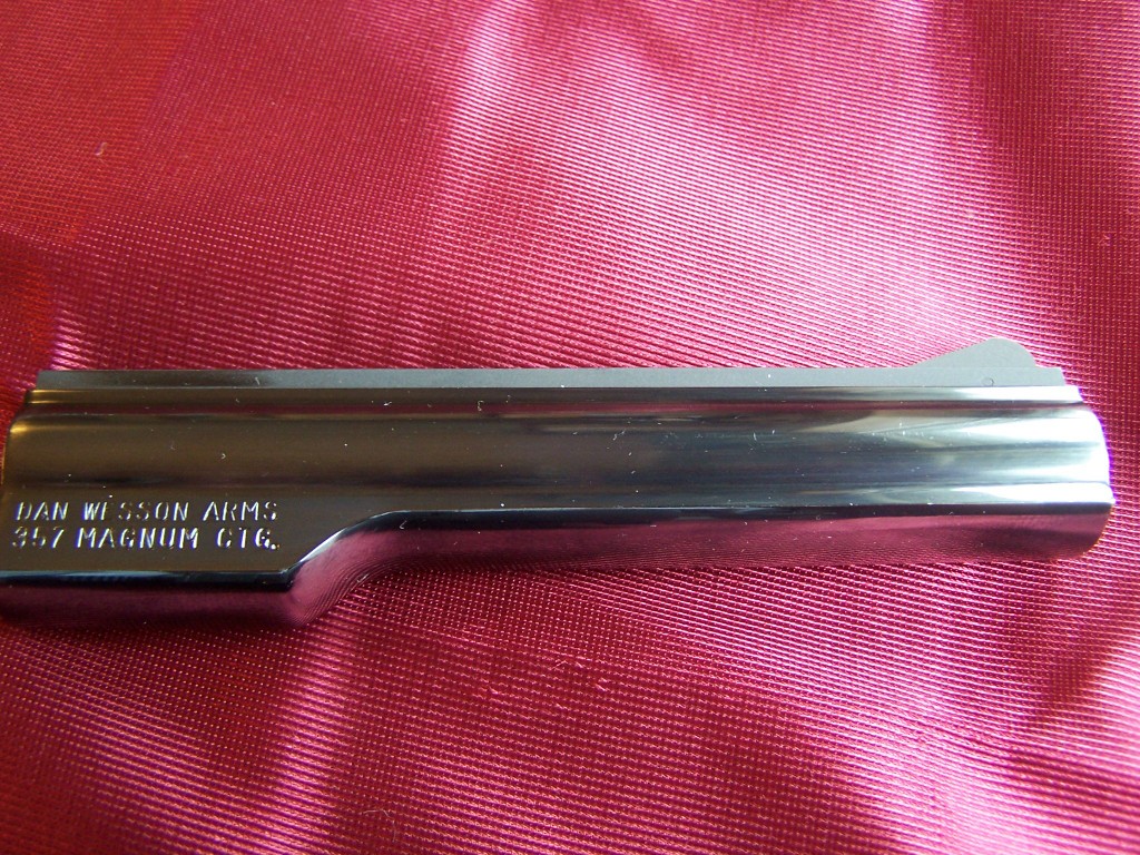

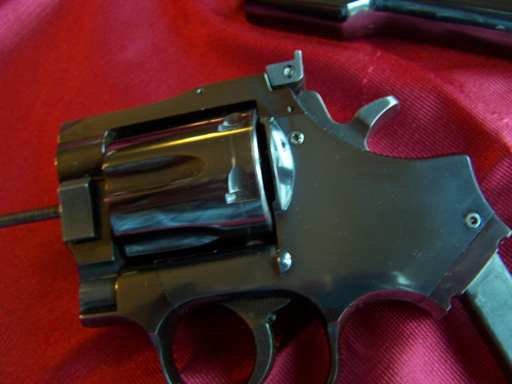

April 19, 2011 - 10:30 pm
Ok, I didn't forget, had a small delay and also was letting the new blue
bath in oil for a bit but she's all together and cleaned up now.
I'll get some pics up tomorrow,
April 20, 2011 - 6:29 pm
Well there's a taste....
April 20, 2011 - 6:33 pm
Or two..
April 20, 2011 - 6:57 pm
Mama Mia she-a looks-a-good!
April 20, 2011 - 10:07 pm
Incredible; a shine so deep... well, you know.
smile
