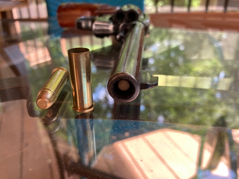

After over a half century of shooting I’ve now experienced my first squib load. A little nerve racking, but interesting at the same time. After shooting 20 rounds of Fiocchi .38 Special I decided to try out a new brand of ammo. The very first round out of the box (not sure what the astronomical odds of that would be) sounded odd, and no hole in the target. I checked the gun, and sure enough there was the bullet lodged about a quarter inch short of the muzzle. I think we all have a good idea of what might have happened if I had fired another round. Ouch! Anyone else ever experienced something similar?IMG_1203.jpegImage Enlarger

The thing that grabbed my attention was that there was almost zero recoil, and a very different sound. I think a round that sticks in the barrel probably has very little if any powder in the case. The primer has enough oomph to dislodge the bullet from the case, but little more than that. There are many stories out there about squibs, and they vary in how far the bullet makes it down the barrel. Some only make it halfway into the forcing cone which jams the revolver (the best scenario since it’s impossible to make a follow up shot) while others are more like my experience. I am a “slow fire only” shooter, so I immediately noticed something was wrong, but shooters who rapid fire are more likely to send that next round down the tube because they can’t react fast enough.
