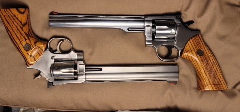

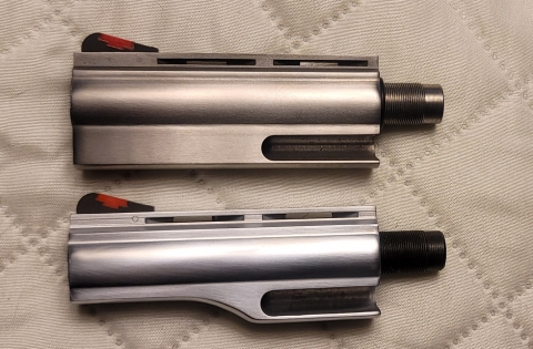

For reference, here is a hard chrome finish compared to stainless.  The full underlug gun and barrel ass'y. are stainless, the other is hard chrome.  The color tone on the stainless is duller.
20240124_224045_resized.jpgImage Enlarger
20240124_224448_resized.jpgImage Enlarger
Forum Posts: 11274
January 25, 2024 - 1:31 am
Interesting to see the two side by side. With most online photos of a gun in hard chrome, it's hard to tell it apart from a stainless piece. But these photos clearly show the difference. Dakota Jack, thanks for posting these photos! cool
