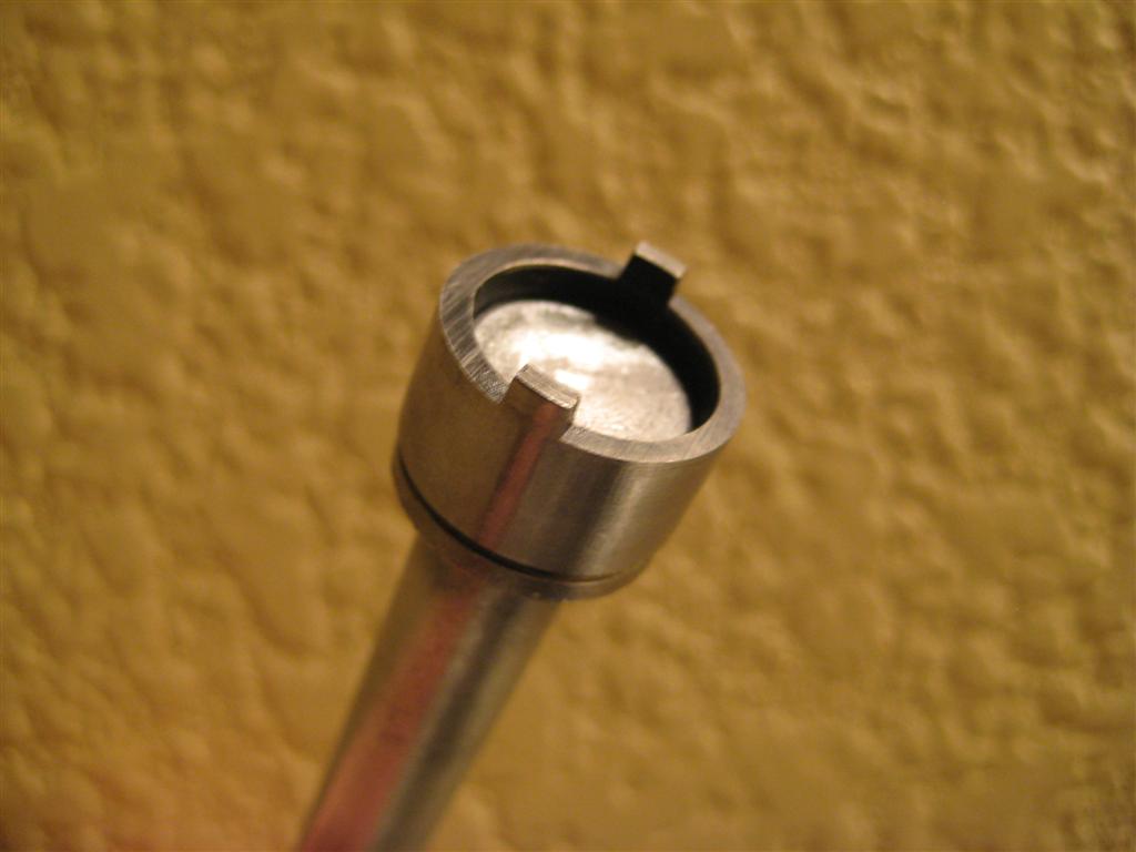

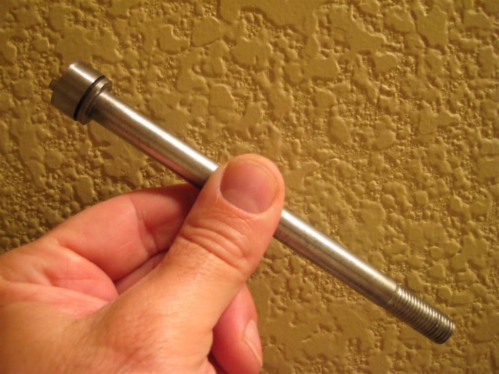

I have a bunch of the broken/cracked "red" DW 357 wrenches same as the rest of you.  I figured I might as well experiment with one.  So I pulled the steel insert out of one and fired up the lathe...
First I took a simple bolt and turned the head down to an interference fit (.001 or less) of the inside of the DW wrench piece.  Lubed it up good and smacked the assembly with the big brass mallet...then I smacked it over and over and over (hence the story here).... finally it was seated.  Turns out the DW wrench is made of REALLY HARD steel.  It didn't want to stretch for the interference fit.
So how hard is it...?  Well, I wanted to use it inside one of my comp barrels; so I put it in the lathe and made a light pass with the bit...  guess who won...  The nut wasn't even scratched, and my lathe bit had the end cut off.
ok, no problem, I'll hit it with a big double cut mill file.... once again, didn't even scratch the wrench insert.   Hmmmm....
Over to the 1 hp 3650 rpm bench grinder Big Grin ...  Now we're in business.  I'm sure my grinder wheels are a little smaller now though.  A quick pass on the little finish grinder and I have a nicely polished piece.
So, now I fully understand why so many DW's have gouged nut slots.  As hard as the prongs on the wrench are, they will cut into anything.  One slip with the factory wrench and you're going to mar something.
