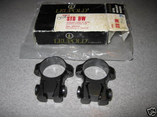

October 23, 2009 - 8:48 am
If you really want to get serious, if you have the cash, and IF you can find a set...this is what you need.  They got for close to $100 on the auction sites.
