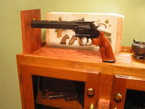

I am sure this is not really the kind of Storage you are talking. But I have only one Dan Wesson. So I made this little stand. It is just open displayed in My Cannon/ Gun Room. It is a safe/Locked secure Room. So I can do this safely and securely.
I do know I will never store a Firearm in any type of case, Soft or hard. For any extended period. I have seen bad results from this method. Yes most of the time it can be done without any issues. But I just prefer not to take the chance. Have seen quite a few nice Firearms tucked away like that, forgotten about, and they did not fair well.
When my Dad passed last year. I found a Brand new never fired Remington Wingmaster 28 gauge in a hard case with that foam. It was rusted pretty bad. i am sure other factors helped it along also. But I do know if it had been open and visible. It likely would not have happened.
